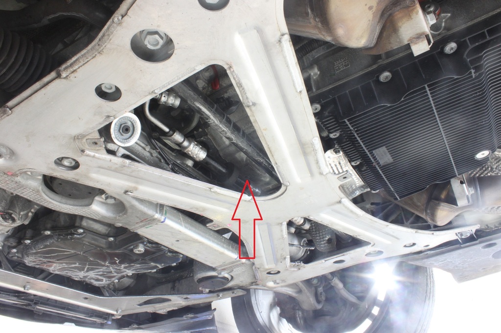

Hi everyone,
I need some serious help…
I was driving my 2010 Panamera S V8 around 4-6000RPM for about 5-10 mins and I saw the engine temp went pass the middle line. Soon later I smelled coolant from the inside.
Following messages were immediately displayed: “check coolant Level”, “Engine Temperature high”, “Temperature sensor failed (something like that)”
I then shut down the engine after 1 minute or 2.
I opened up the hood and see coolant everywhere in the engine bay, it was even shot out of the hood.
Coolant looks more like came out of the front of the engine bay but I do not see anything hose or radiator failure by visual inspection.
I towed the car back and I removed the engine cover. I refilled more coolant from the reservoir with engine off, after 2 and half gallon it started leaking again and it is from the little hole on the bottom of where the engine and transmission mounted together. See picture attached.
The engine would turn on fine and there is no abnormal reaction. However, the temperature reading will be pointing at the highest spot at all time.
I am wondering if anyone has an idea of what is going on.

What you are pointing to as the source of leak is actually where the coolant is draining from the top of the engine under the air intake distributor. It drains towards the back where the pdk mates with the engine. There is a drain hole by the starter motor and the hole you are pointing to is the underside of that. Inside that cavity is the flywheel and clutch. See my post in this thread below
https://www.6speedonline.com/forums/...s-model-3.html
Your damage is already done. At the minimum you should replace the coolant pump (updated part) & thermostat. Coolant sensor error could be due to coolant dump but it would be safe to replace that now that you will be in there. Other issue is that the starter motor would have been doused with this hot corrosive liquid which also drained into the flywheel/clutch area. Your starter motor will start to make some rattling noise sometime soon. Some cleaning/rinsing of the flywheel cavity is probably a good idea. Not sure what and how though.
For those of you who haven't experienced this issue it would be prudent to address this now. If you have warranty then try and get this done for free. Out of warranty quote would be about $4k using updated part or you can do what I did for a cost of under $50 ($40 coolant to top off, $1 screw, $2 epoxy) and some elbow grease.

Not sure. There have been same issue reported on the Cayenne forum. Mine is out of warranty. The dealer did say that it would have been covered if the vehicle had warranty. Ask your shop. You could probably convince them by showing these threads.
