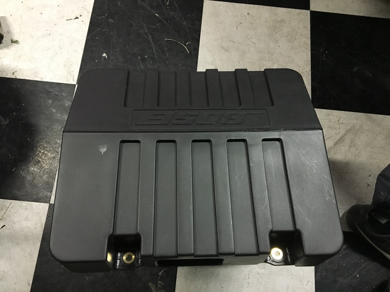

Enclosure Top:

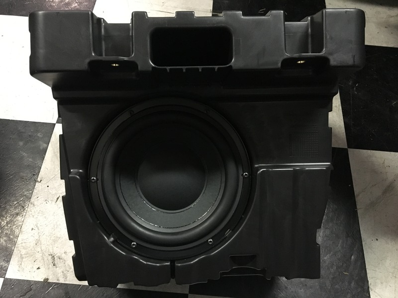

Speaker in Housing:

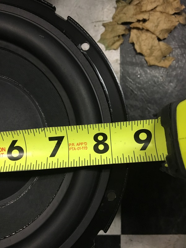

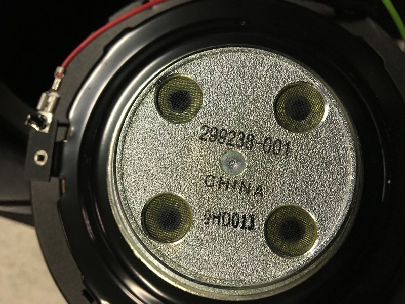

Decided I would remove the speaker and take some measurements for myself and others in the future, and what do we have here? A Chinese made driver:

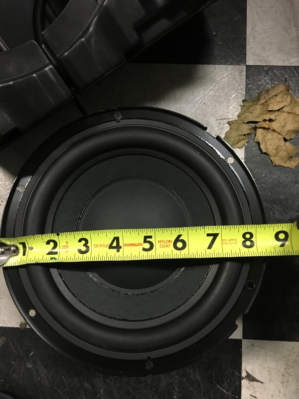

Driver measured:

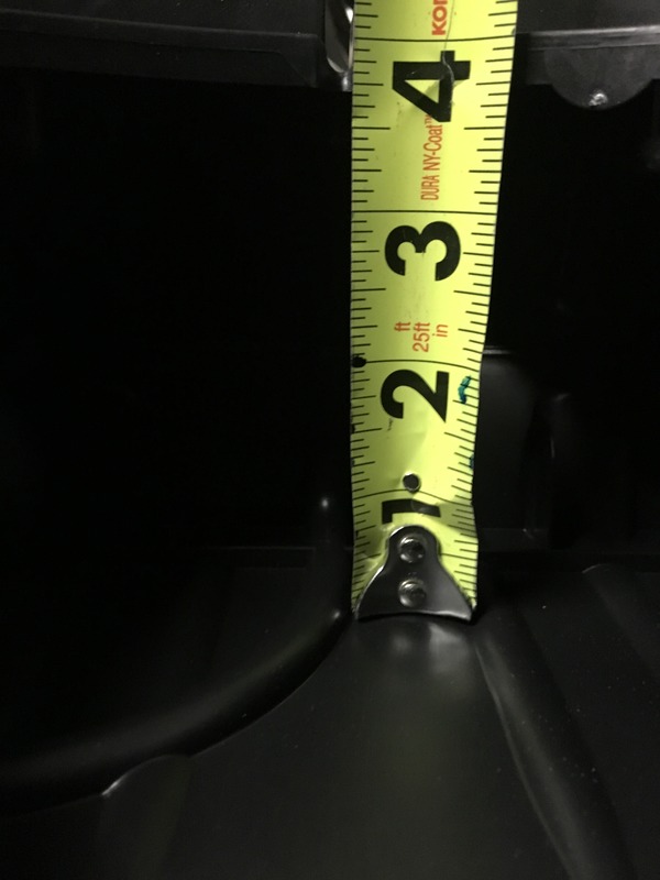

For those like me that will consider replacing the driver I measured the depth of the enclosure as well:
You have about a solid 4 inches should you desire.
