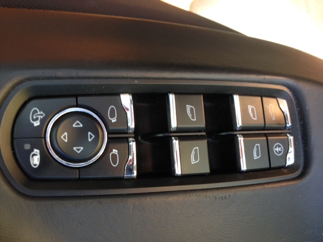

LCA picture
Below a picture of the LCA button on my 2013 Panny GTS
You can turn it on-off.
In "Settings" you can change the brightness of the LEDs in your mirrors
Good luck

Thanks for confirming. The button you show is what I feel should be there. On mine, all I have is a switch to fold the mirrors that takes up both spaces. My guess is that at some point the switch console was changed out with the wrong part.

Same issue with me. But the window buttons are known to easily break and asked the used car dealership I purchased it from to replace it since the tips fell off on some before I bring her home. I didnt notice right away but they replaced it with a non LCA button hence mine does not work as well. I told them about their mistake and they are fixing it. I believe either the previous owner or the dealership fixed it with using the incorrect window switch with yours. It's a $150 part but I figure I'd let then deal with fixing it since you need to take the whole door panel to replace it and not as easy as pulling it up. Good luck!

The dealership came and picked up the car today to assess my complaint of the mysterious "missing" LCA button. Low and behold -- I was CORRECT! As Just A GTS mentions, the switch cluster in my car is incorrect. The dealership was a bit surprised that this occurred, but thankfully they are taking care of it and I'll have the car back tomorrow.
