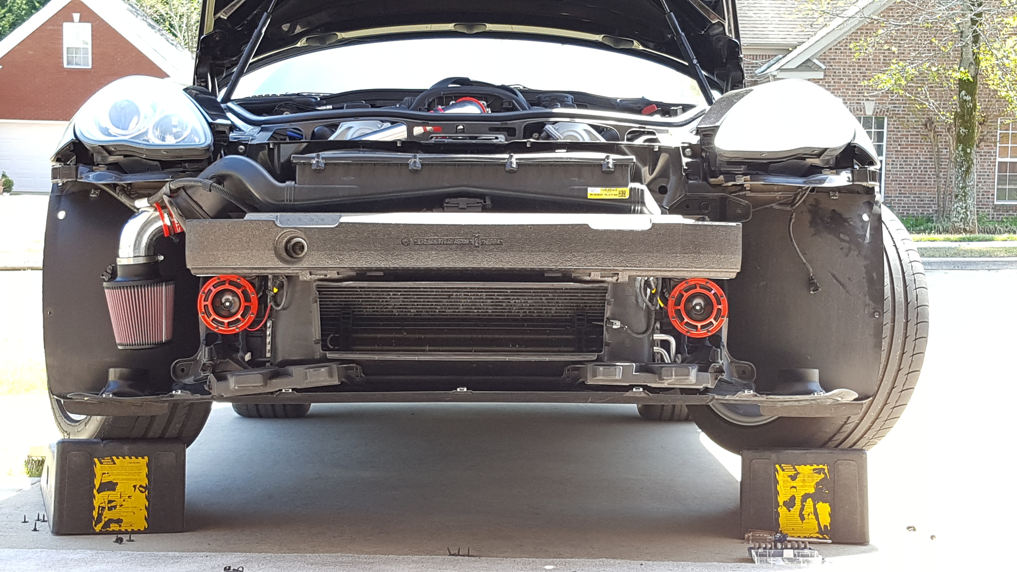

And front bumper removal and reinstallation is a piece of cake. It takes no more than 15 minutes, and can be done without an assistant. Build yourself a CAI (like I did) while it's off.
I agree, so why keep the airbox if you have your new CAI?

Would like to eliminate the muffling of the intake noise. The GTS pipes some to the interior but it’s barely audible to me. It’s not audible Like the old V8s I ran with aftermarket air filter systems.
It seems to be the best place to store it for now...😎
Touche, well played!
