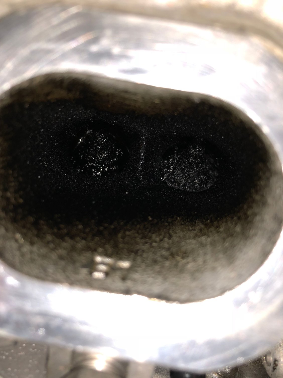

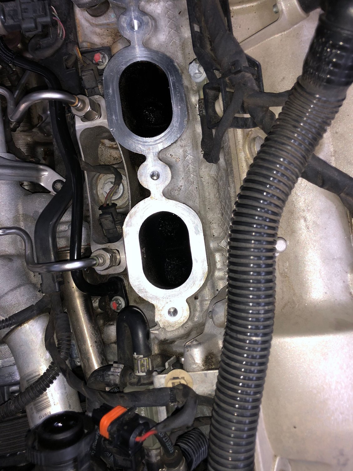

Interestingly while in there, spotted lots of carbon build up in the engine. (See pics)
Also cleaned this out while at it. They used some 3M solution that they sprayed into the inlet. I will find out the exact name.

Very interested in the intake carbon deposits. I have the 3.0TT in a 4S. I am wondering about the condition of my intake valves. Am going to try and use a USB horoscope to inspect a couple without removing the intake sometime in next few months. My current mileage is 55K.

yea those need walnut blasting

After the walnut blasting, did the PT run better, did it have more power?
Did you get any pictures of the intakes after blasting?
