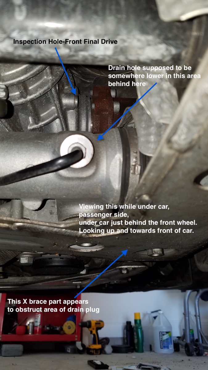

I was doing fluid changes on the front and rear final/diff/. Rear was no problem (actually making DIY for it now).
For the front, I was able to locate the fill plug, but had a very hard time locating the drain plug (large hex bolt on lower part of the body).
There appeared to be a large x brace covering the area. Did not want to pull it as I am not sure if this would weaken something and cause problems.
Does anyone have input/info on how to access the front final drive drain bolt so I can drop the fluid, put in new one and make a DIY for it?
Thanks.
Also, is the x brace I refer to in pics below, the front axle carrier that the manual talks about?
Here is what I see from underneath, and a pic from manual where the plugs should be.

to wrap this up, I have all the info in a DIY I created for changing front final drive oil.
