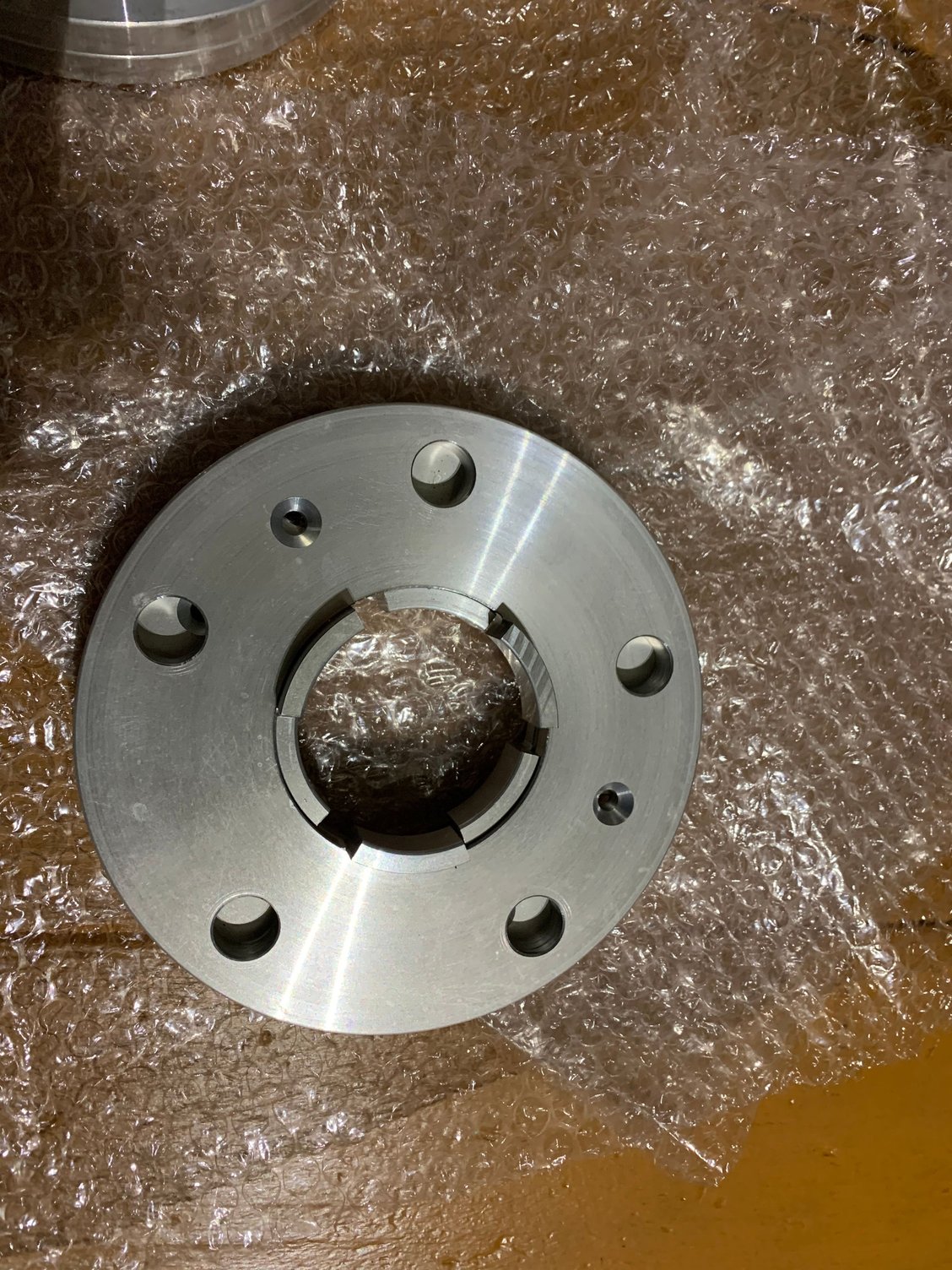

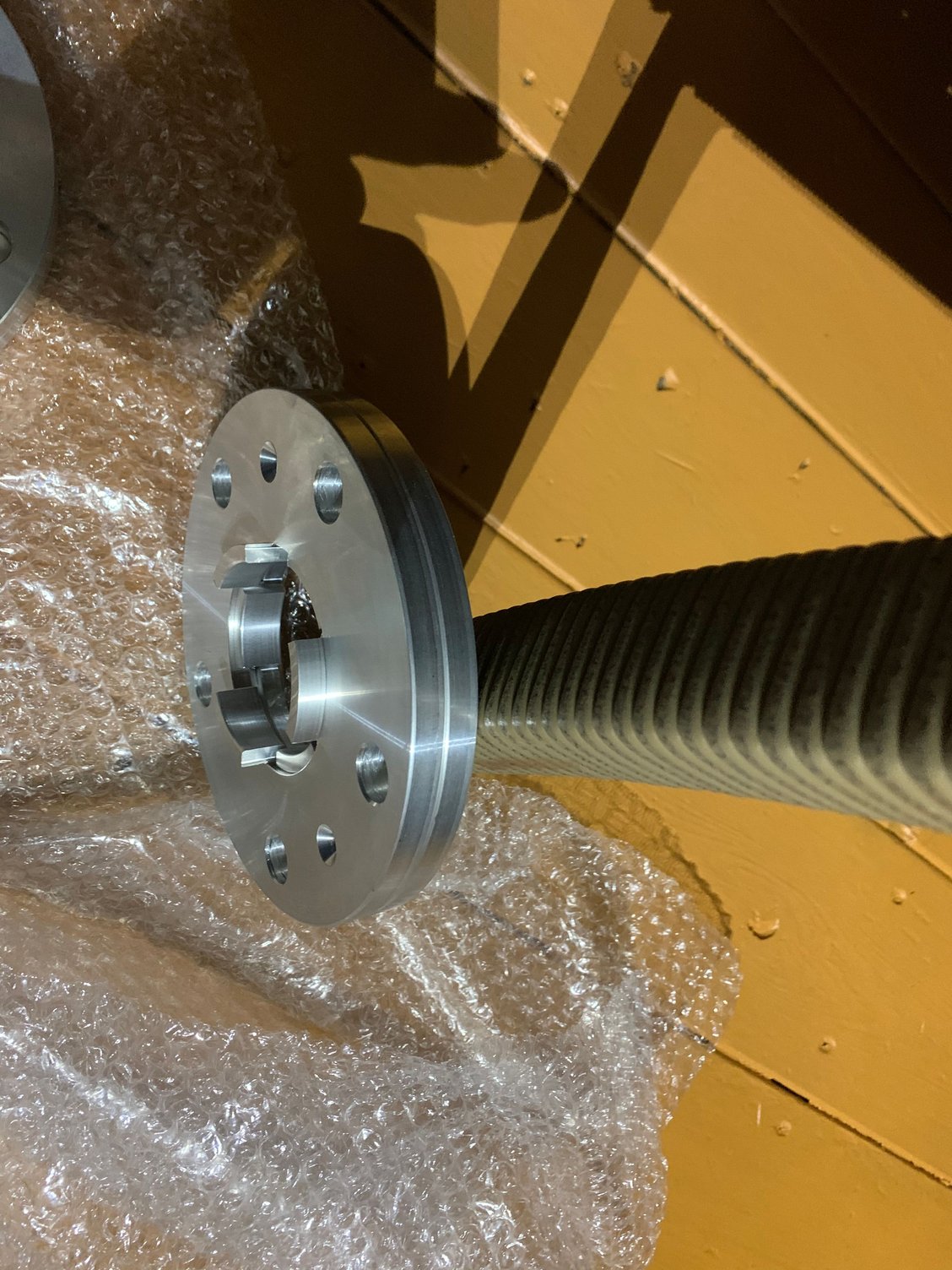

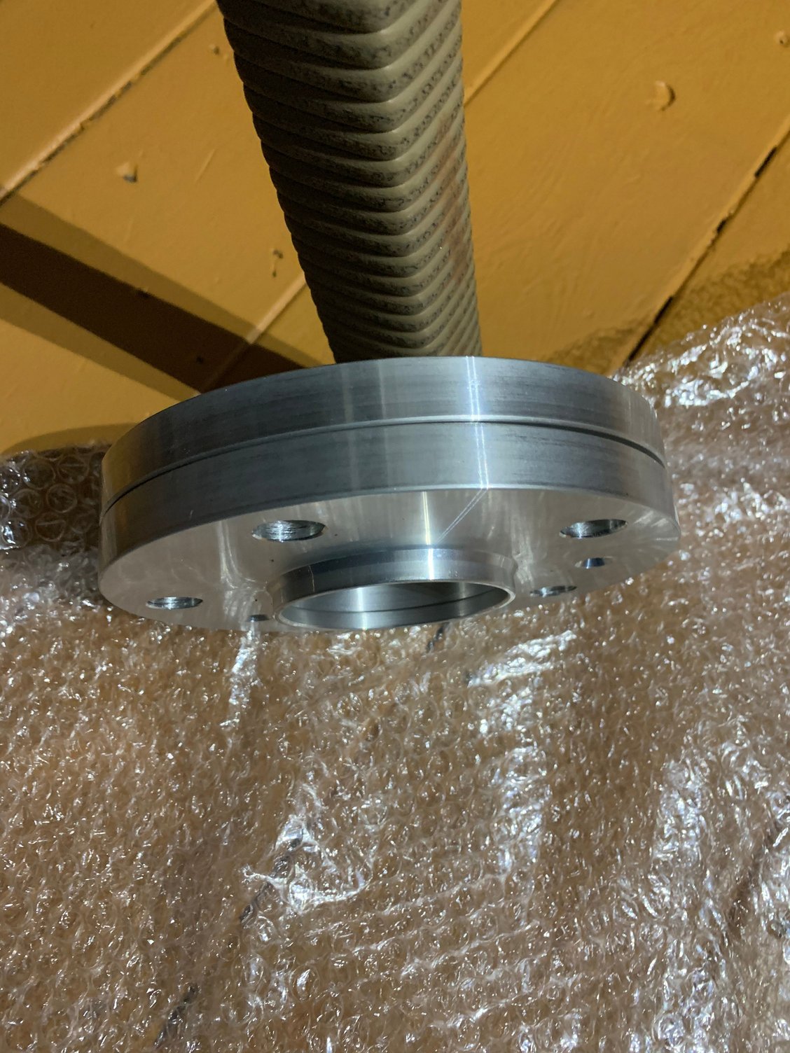

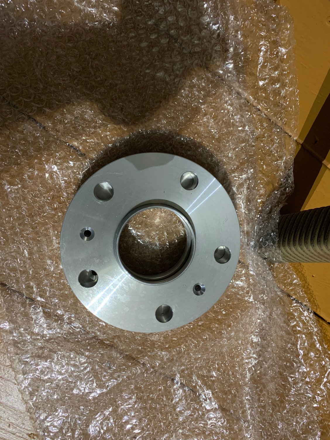

Hi Ciaka and all,
I just bought 4 spacers from adaptec. Take a look at , 15mm and 10mm. I also wonder about the 2 small holes for the screws going to the the rotor. Do I have to remove the 2 screws from the rotor and attach the spacer to the rotor? Thank you for your input.
Old Nov 5, 2019 | 04:45 AM
  #47
ciaka's Avatar
Joined: Mar 2012
Posts: 2,298
From: TX
Rep Power: 123
ciaka has a brilliant futureciaka has a brilliant futureciaka has a brilliant futureciaka has a brilliant futureciaka has a brilliant futureciaka has a brilliant futureciaka has a brilliant futureciaka has a brilliant futureciaka has a brilliant futureciaka has a brilliant futureciaka has a brilliant future
Nice. Those screw holes wont be usable unless you find screws long enough to go through the spacers and rotors.
Most likely you will keep the screws where they are now, and put the spacers over top of them. No big deal.
Good find.
