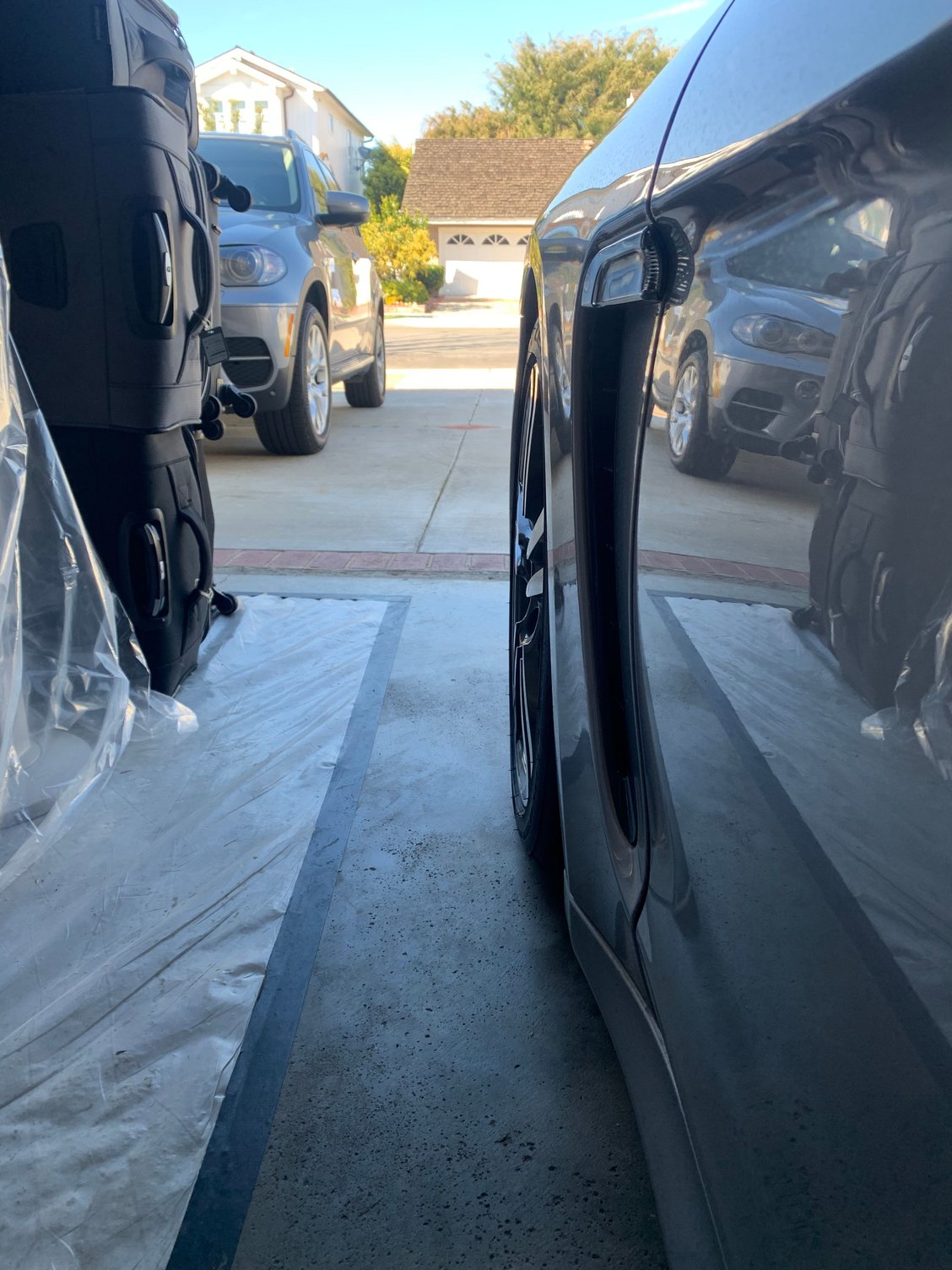

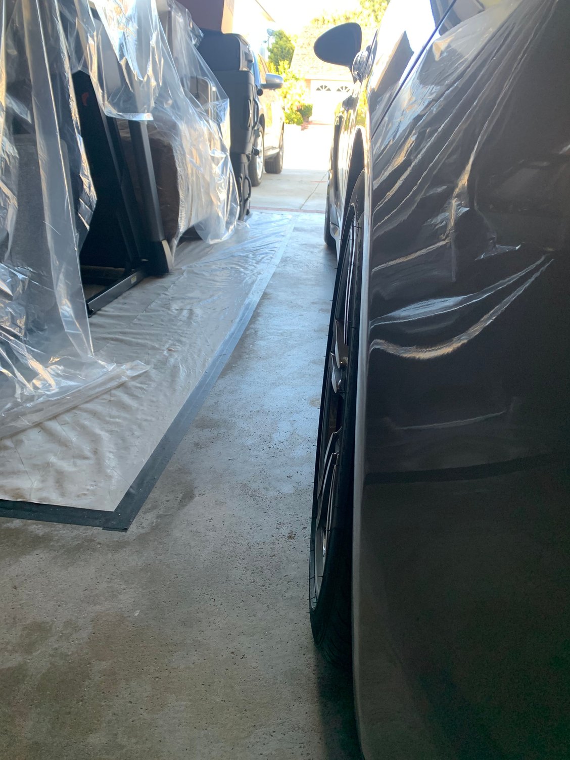

I went with 10mm spacers all round.
Got them for ECS tuning and the fit seems perfect.
pictures are in low setting.
Front in low setting with 10mm
Rear in low setting with 10mm
