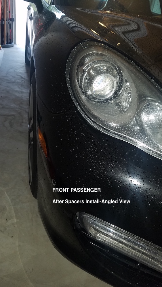

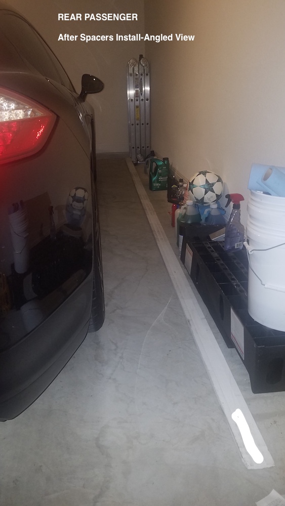

I did this recently, and wanted to post up the before/after pics.
Originally my car came with the 5mm spacers, but IMO they were useless - 5mm, thats less than thickness of a q-tip end - yup, useless.
One thing to keep in mind, is that I already did rear spacers install last week. So all pics have rear spacers in them (sorry, no comparison pics), however you can see the after result and compare the fronts to give you idea of how far the wheels get moved out with spacers in place.
The install was with the 20 inch Turbo 2 wheels, sizes:
- 255-40-R20 front
- 295-35-R20 rear
To do the job:
- Purchased 15mm spacers, one for each corner, total 4.

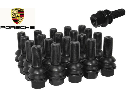

- Purchased 44mm wheel lug bolts (black) with R14 swivel washer - 5 per wheel, total 20 bolts.
- Brake cleaner for cleaning brakes while I was at it
I must say the 15mm spacers appear to be optimal for spacers on stock wheels for the Panamera.
If I installed thicker spacers, I think when the car lowers down, it would come extremely close, if not touch, the inner wheel well of the car.
So if you contemplate installing spacers, it is something to think about.
Here are some pics...before and after...

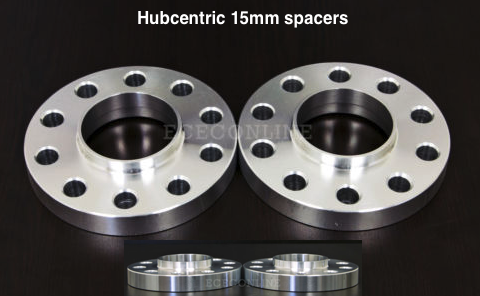

I got them off ebay. Hub centric wheel spacers 15mm.
Due to all of them being turned out or cncd, you should be good to go with them.
Make sure you get longer bolts, I think I put details in the thread, for type and length.

https://www.ecstuning.com/b-ecs-part...001366ecs15kt/
thinking about buying these, I assume the bolts should work fine? It didn’t have a size that I could see...also did anyone buy new lug nut locks or what?

I just went without locks. When you get them the bolts should be longer than your OEM bolts by at least the width of the spacer.
