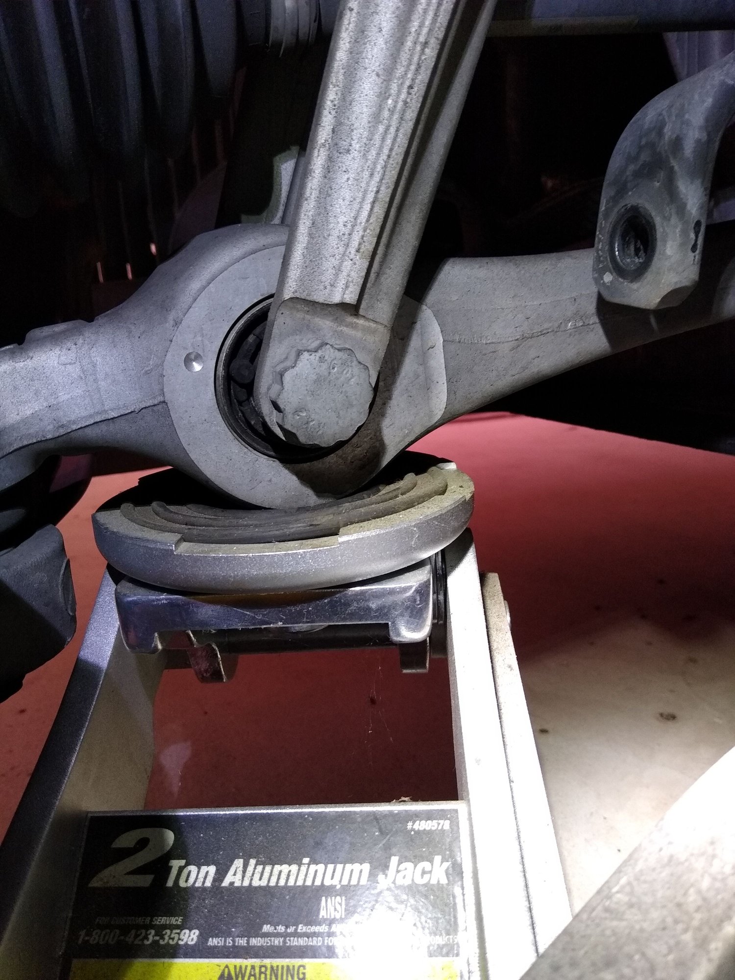

What Bolt Head is This?
May anyone please tell me what kind of socket I need for that lower air strut bolt? I believe there are a lot more teeth than E-Torx.
To get this far I just wanted to report one tool I found very helpful:
HAZET 3317-T40
Available at Porsche dealer as 000 721 954 60
Should be available at porsche.snapon.com as 9546 but I can't find it at the moment....​​

Standard 12 point metric socket. Can't recall the size, but it is bigger than what the normal box sets come with.

If you go to post #1 of this thread, look at image number 1, you will see, 12 pt socket, 24mm.
needed tools are listed there and shown.

Thanks so much both of you.
Embarrassing to say I looked at all the tools you had in the first post and my mind kind of blanked out and my eyes glazed over...
I have a 15/16" combination wrench that I had left over from work on a Prius. I took it out with my ruler ready to sort out what size I need to run get at the store and the 15/16" although not ideal because the arm contacted the flared part of the strut, was able to hold the bolt in place while I loosened the nut on the other side!
