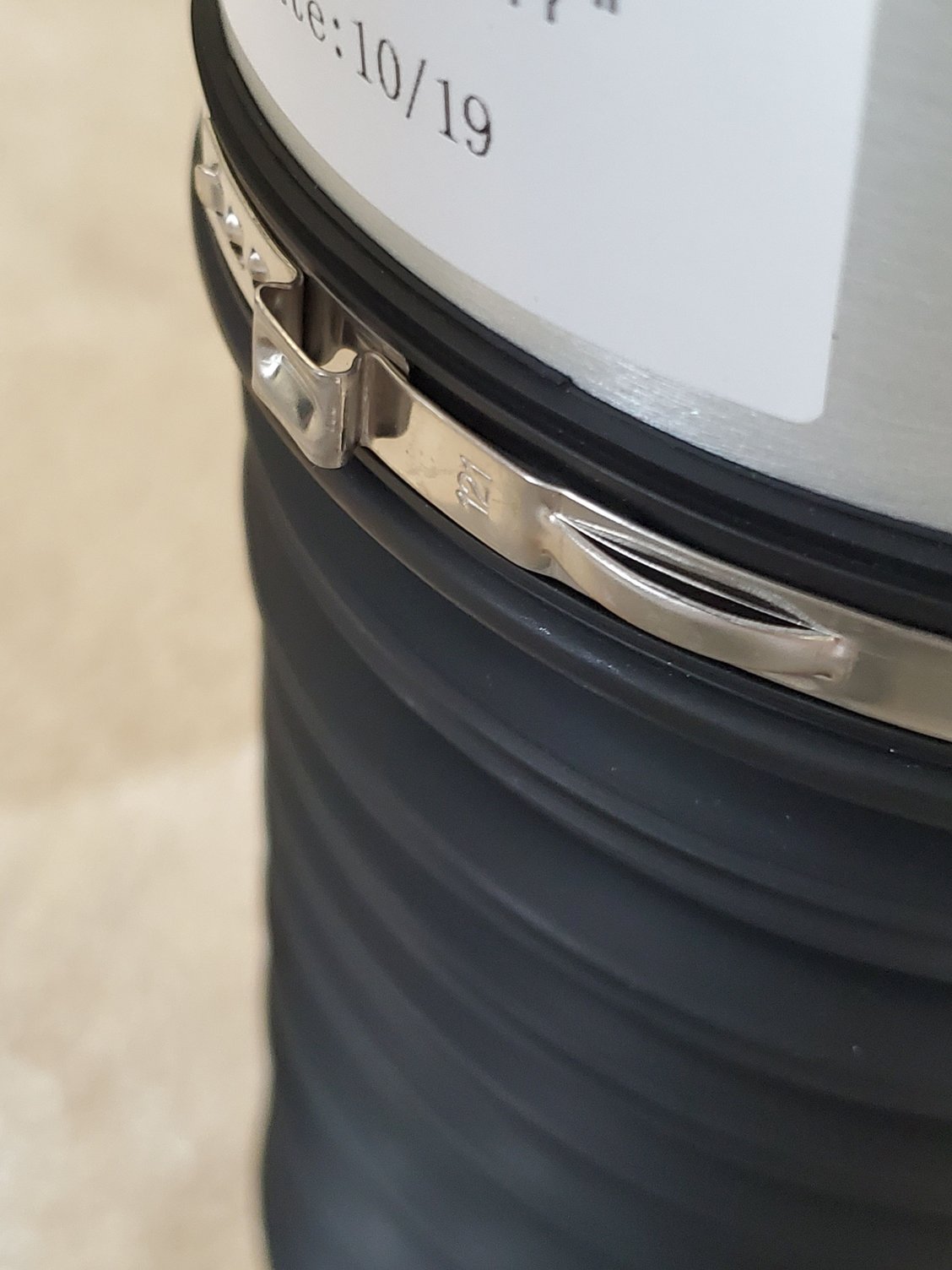

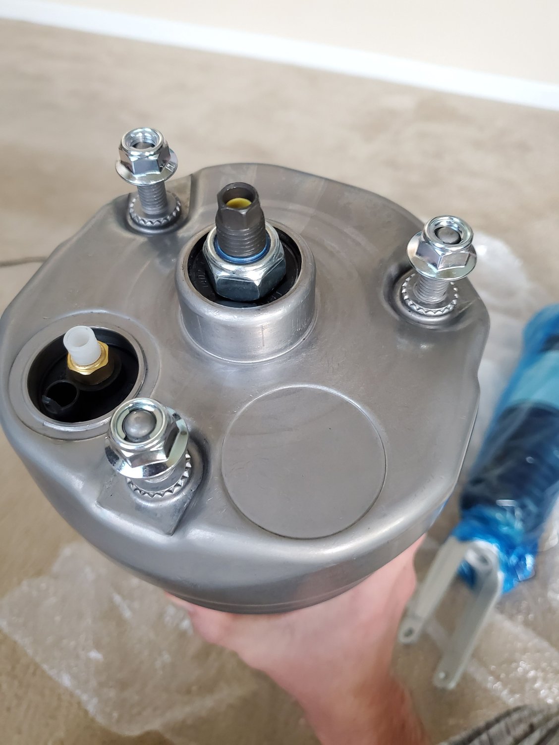

Well boys.... Fresh from Germany via FVD Brombacher and the lovely Rhonda. It "only" took a month haha, but I'm finally going to be able to replace everything; compressor, relay, upper control arms and lastly the air struts.
As you can see from the photos below, I double checked the areas others have reported having issues with. They look great and were packaged incredibly well, like nearly excessive but I'm not complaining because again others have reported damage from shipping.
Me and a friend will tear into it tomorrow afternoon around lunch using this very thread on how to do it, so I'm excited to say the least.
