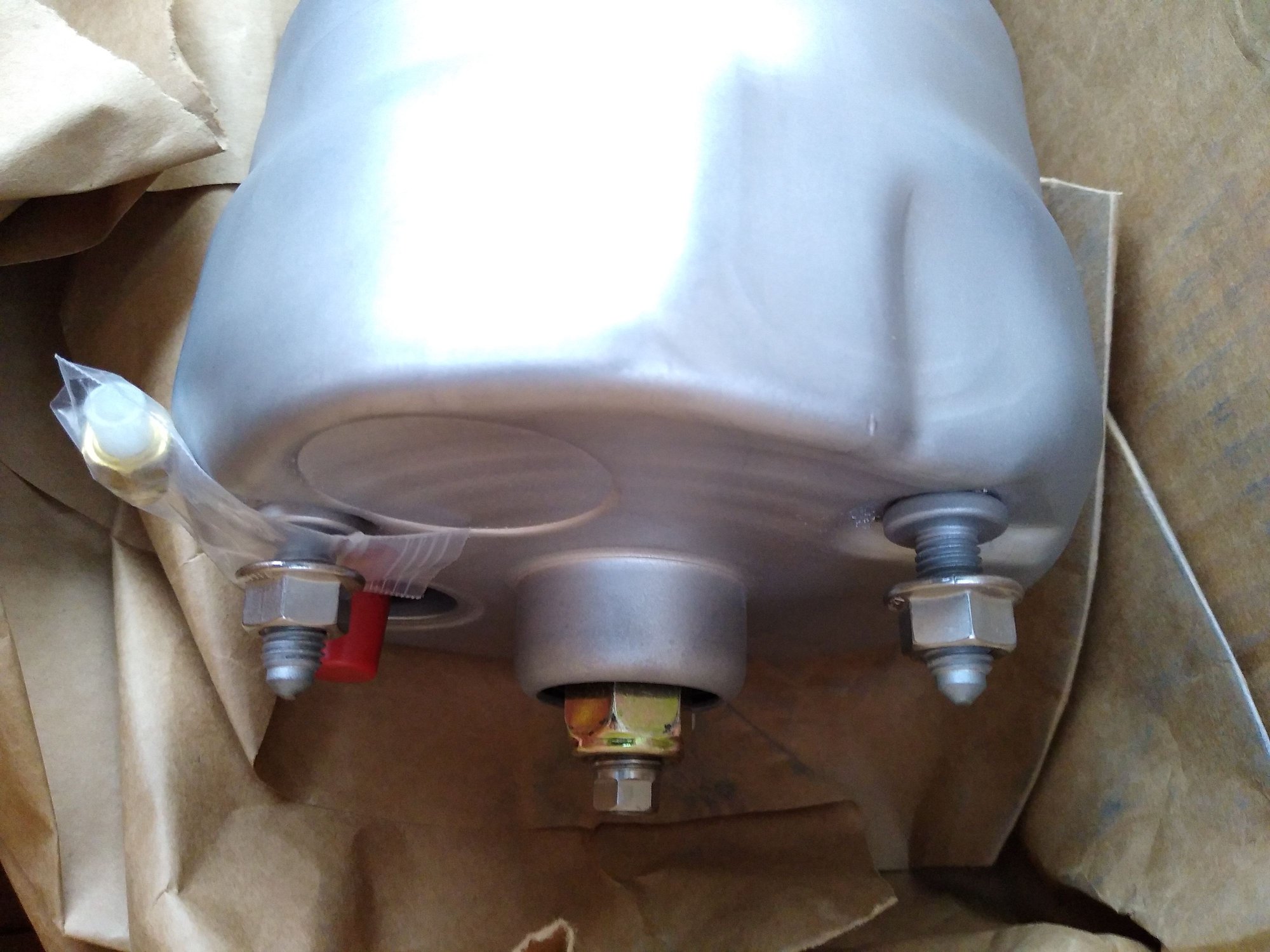

Decent packaging shipped via FedEx, a couple more of those paper pieces covered the top. FedEx seems a lot gentler on packages than UPS. Outside of box shows no apparent damage.
A couple of pics of the Unity strut just as an FYI...

Originally Posted by jzchen
Thanks so much for the input!
As far as warranty, the OE Porsche parts, and labor from this shop, come with 2 yr unlimited mi warranty. My concern for the Unity strut is if the bag is faulty or fails. I would be out a significant amount of labor! In the case of rebuild, what if the strut (oil filled shock absorbing part) that they reuse starts leaking/fails. Then I'd still be out labor!
I agree the best is probably to go the DIY route. Now that it seems this strut does not have some sort of short, (should I still be concerned as I didn't install it?), it's time to look into a better tool like the PIWIS clone or Launch Pro Line.
I also have a time limit to get the SCITOO strut off the car and shipped to Amazon by the 22nd...
Sigh....
I ordered the Unity set from partsgeeks, checked out with a rep on the phone only to get a call a day later saying they were actually out of stock... Damnit!
