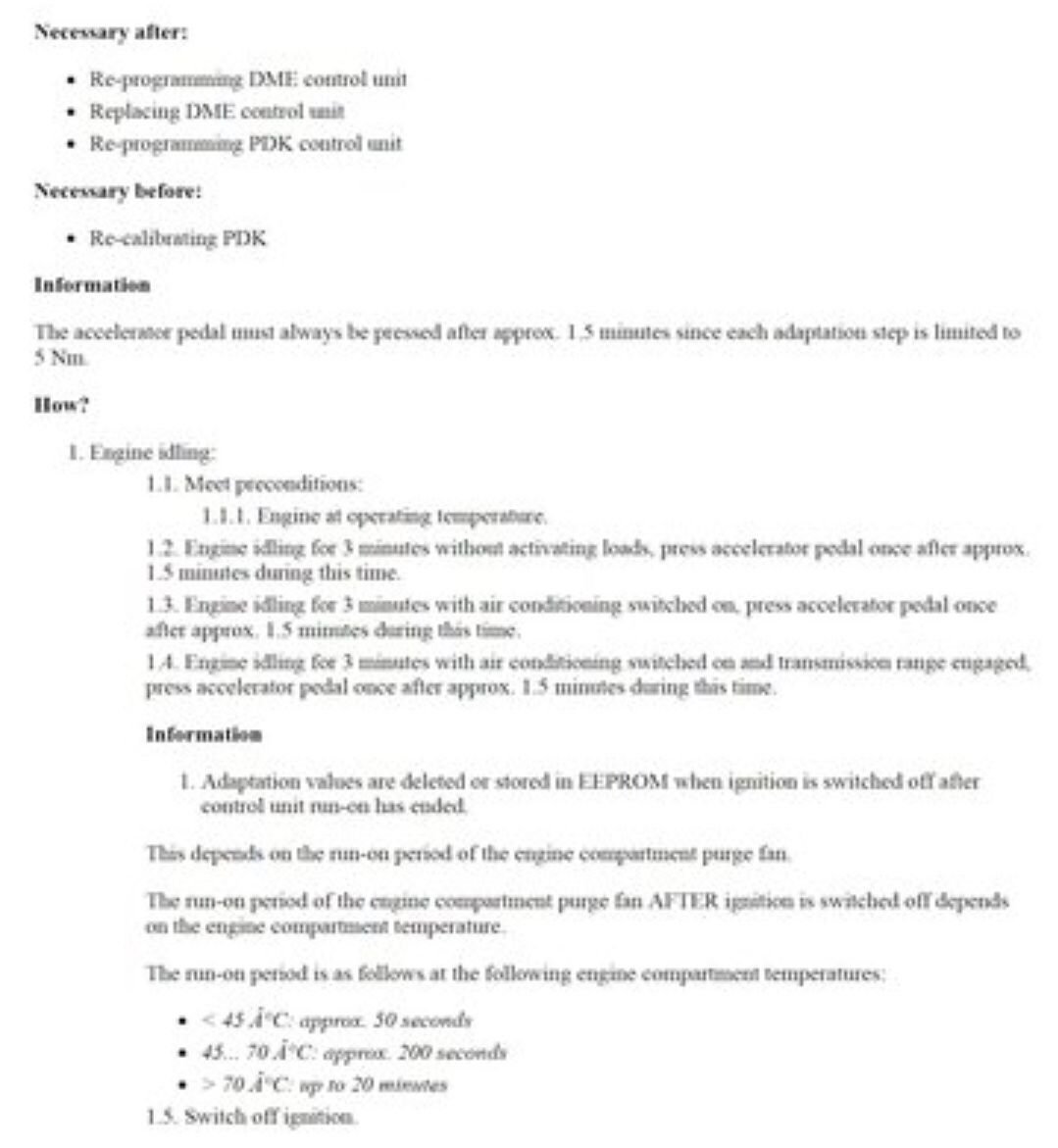

So...I’ve been wanting to do this for a while but always seem to forget. Finally got around to doing it today. I did the “extended” PDK reset procedure today (on Rennlist). Maybe it’s the placebo effect but I think the car is shifting smoother and crisper! No audible confirmation that the procedure was done but definitely seems to drive better!

Nope...not placebo effect. Shifts like butter now! Up shift and down shift. Worth doing! As always...thanks ciaka!

Did you do the procedure with your door open or closed?? 🤔🤔

Sitting in vehicle with door closed.
what is transmission range engaged exactly? Trans in D ?

Sorry but this process is not calibration of PDK it's initialize PDK because the ECU is self adaptive and with this process you reset it but not recalibration.
