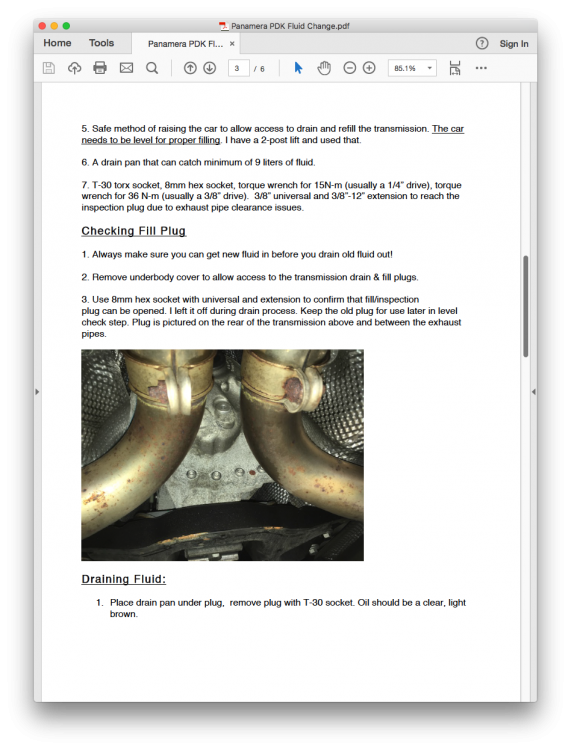

Attached is a DIY for changing fluid on Panamera PDK transmission.
Got this from a fellow forum member who happened to do the change. This should help many interested in doing maintenance on Panamera without paying thousands for it.
Speaking to shop/dealer, after 60k, filter/pan replacement not absolutely necessary (cost of the kit is about $350).
So for 60k, drain and refill fluid is fine. At 120k, you would do same fluid change, but this time replace the pan/filter as well.
Read the entire DIY before you start to get a good idea of requirements and estimate time involvement for you to complete.

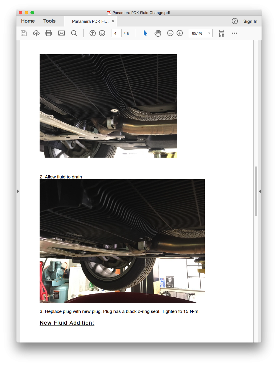

Do not forget to replace the drain plug with its built in seal. Last thing you need is have a $15 part cause small leaking, and then have to put car up, open up drain plug, lose a bunch of expensive oil, just to put new drain plug in. So dont cut on this one part.

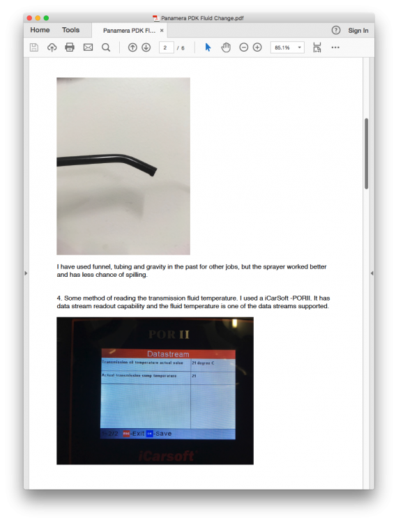

Since Durametric does not have capability to monitor PDK temperature yet, you can use an IR thermometer, when you heat up the PDK to 40 celsius, after you put in 6-8 quarts or so, and when doing final level check.
