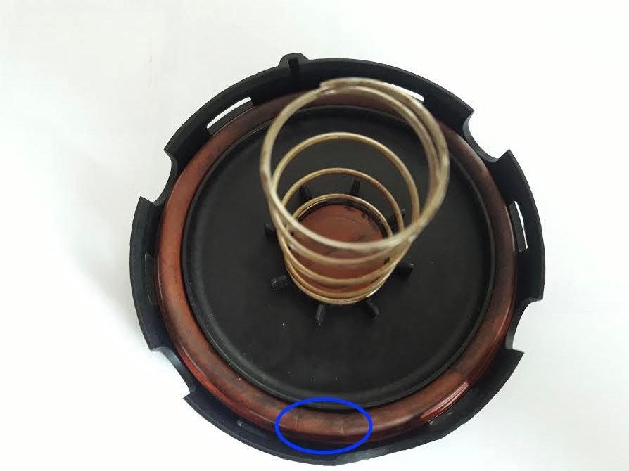

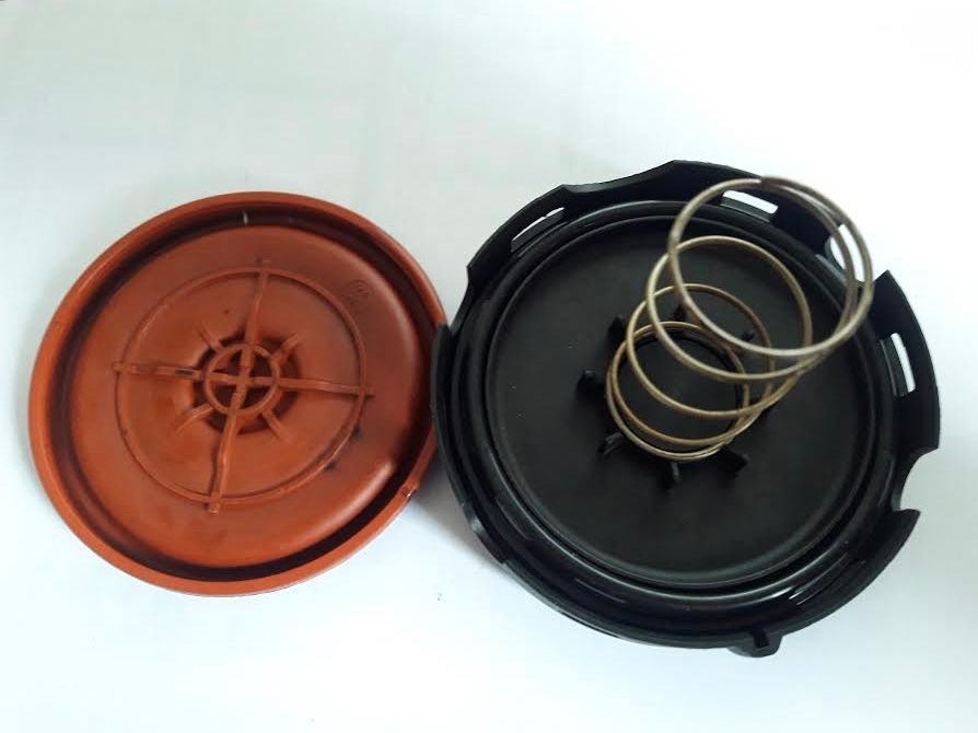

You can control oil separator membrane its a problem on panamera.

Yes change only the membrane it will be fine
