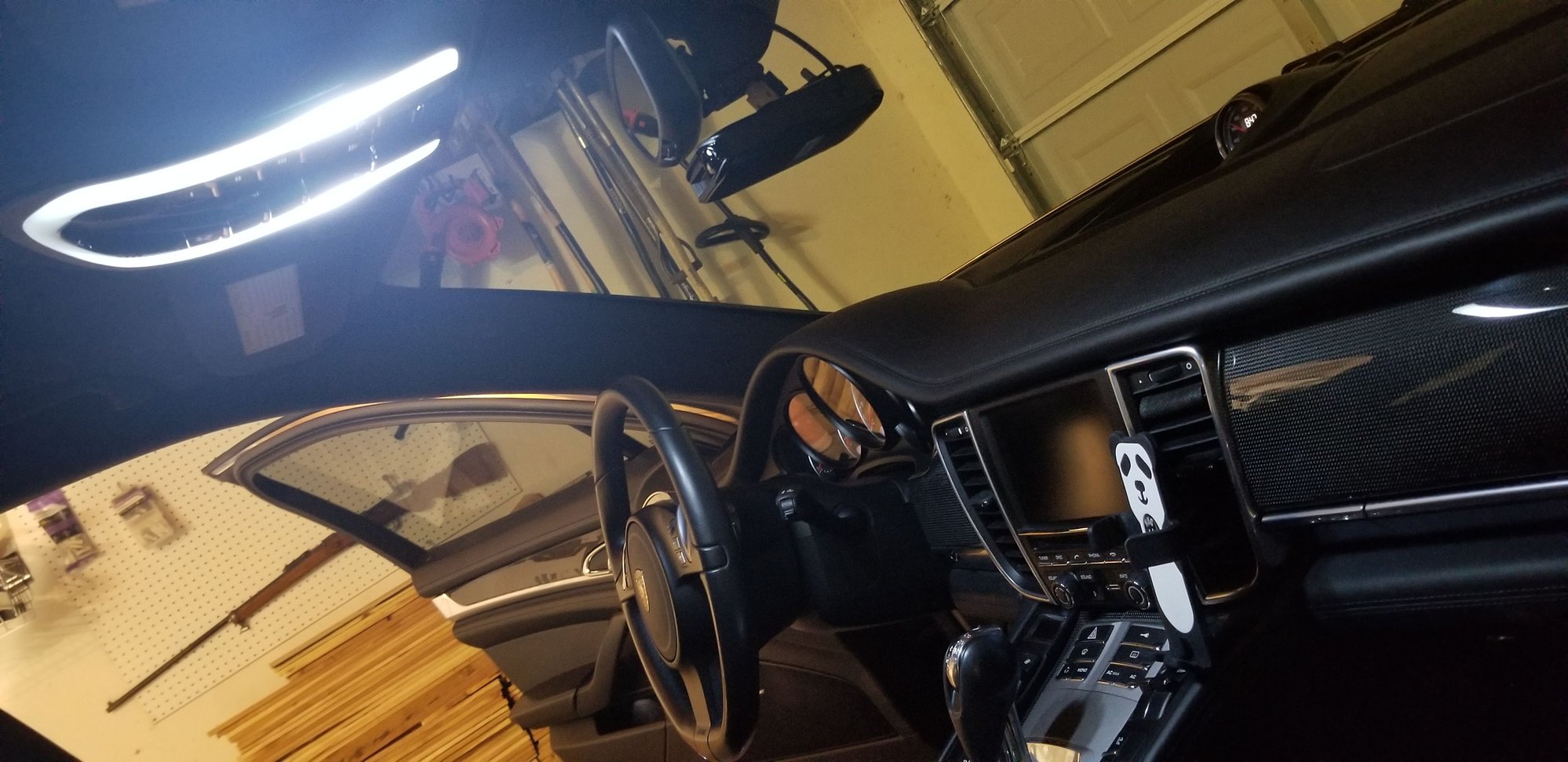

Escort Max 360 Radar and Laser detector hardwired in!

cute panda

Haha that's my temporary phone holder. Was actually thinking of getting the rennline mobile phone holder for the cayenne and making it fit. That one seems to fit in the stock bolts of the pcm unit.
But... it is a cute panda
