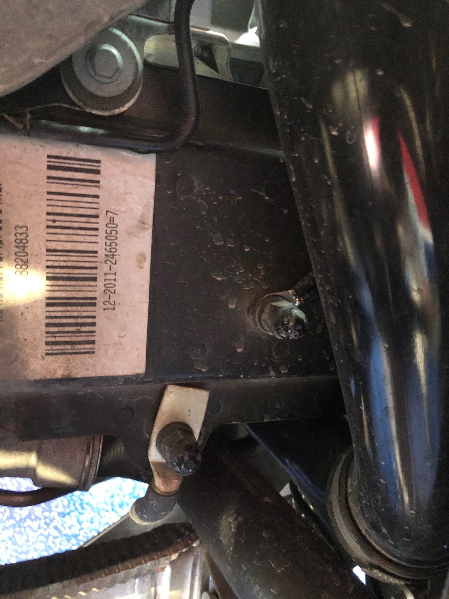

I found that there are in fact 3 ground points, two on the passenger side and one on the driver side - I know you're long done with this, but for future reference

Remember to clean off all those grounding leads every once in awhile with the electronics cleaner spray... Makes a big difference and check the lug for tightness.
