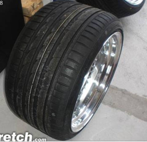

If you ever need to drop tire widths in the future, 285 on 11.5 might not be a stretch at all and 275 on 11.5 is when the sidewall really starts to arch inwards but not extreme either...
https://tyrestretch.com/list
285
275
