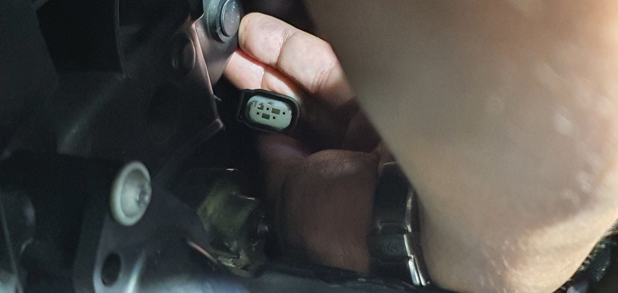

Ok, so here's an update. I disengaged the wiring harness from the back of the DRL/Turn Signal assembly on the bumper. There's a tab on the right side which you have to push to be able to pull the connector out. I basically, checked for current for each of the pins so that I know if there's current coming from DRL, Park Light and Turn Signal Light. Here's what I found out...
You can pull out the connector without taking down the bumper through a slot beside the radiator

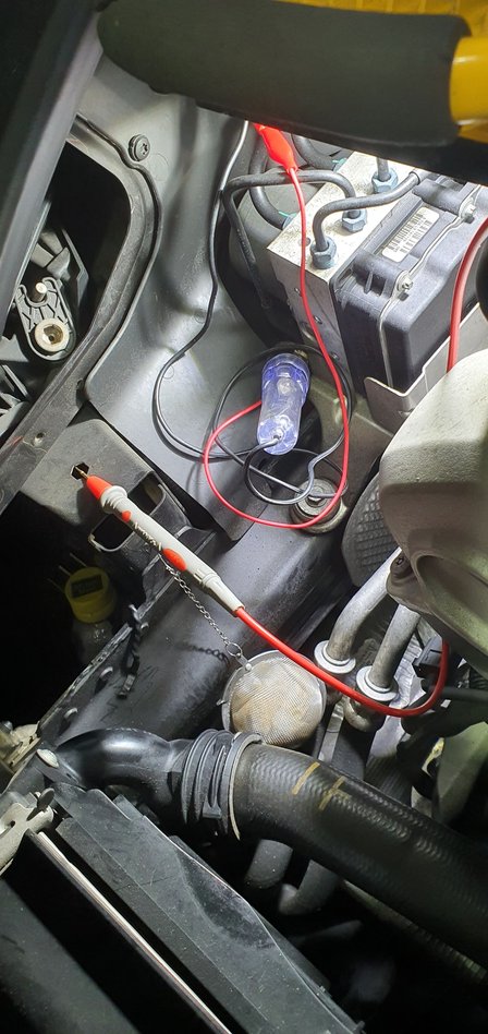

Here's my testing equipment. Connected one end to the ground (-) and a needle tester probe for the pins (+)

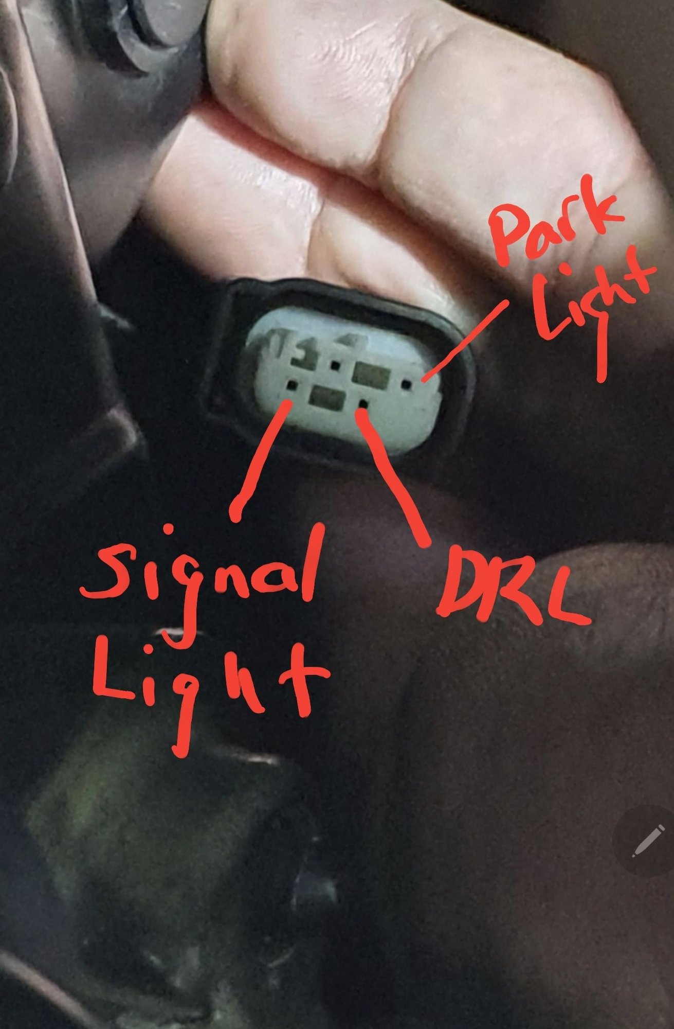

Here are the corresponding currents drawn from each pin of the connector of the DRL/Turn Signal Assembly on a Panamera 970 2010 (NON-TURBO)
So, the long and short of it is that, there is current coming form the wiring harness to supply the park lights, the turn signal and most specially the DRL function. So I conclude that the DRL bulbs or circuitry on the assembly is busted or there's something loose inside this assembly. I think I don't need to swap the DRL's left to right to check this right? Will just order a new air filter, take down the bumper and order from ebay or pelican parts a new DRL/Turn Signal assembly. Let me know if there's anyone selling a used right hand side DRL assemble out there! :-) Thanks!
