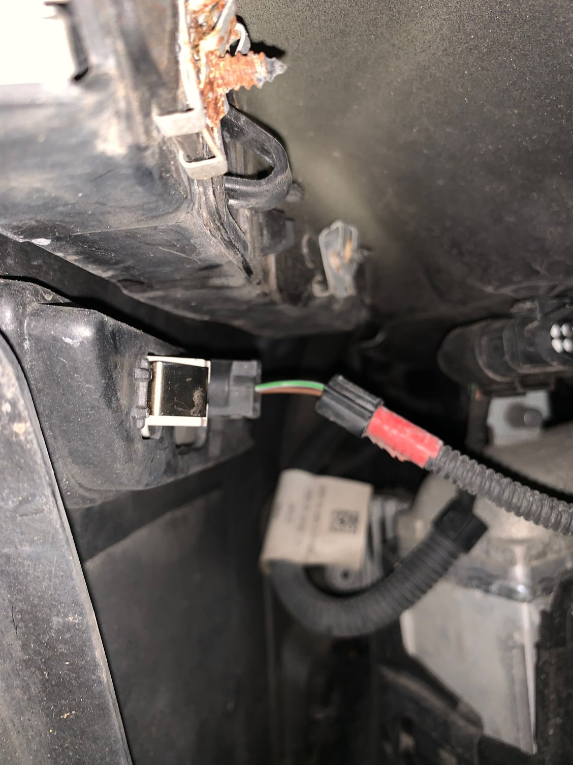

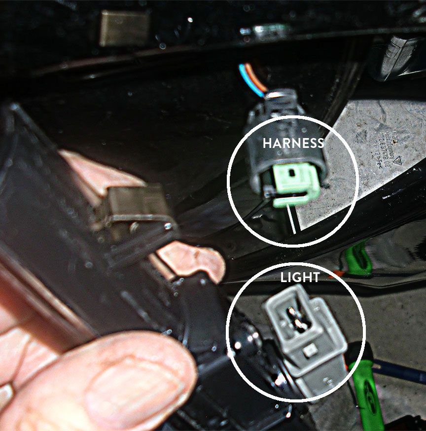

I'm trying to replace the side markers on my 2014 Panamera 4... problem arises that the harness connector and the new side marker connection do not match... has anyone else had this issue? Any solutions? Sorry for the crappy photo...
NBot the same!

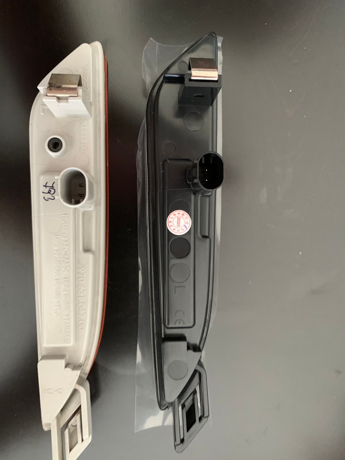

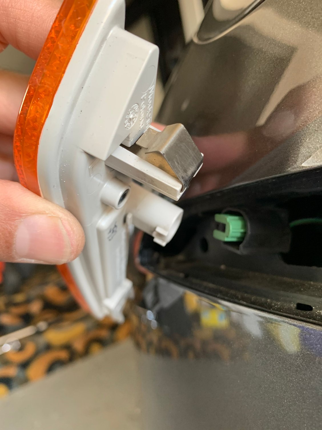

I recently replaced the side markers on my 970.2 from the stock orange to aftermarket clear. The clear side markers I ordered from eBay were plug and play. I suspect your new side markers might be incompatible.
Here are a few pics from my install.

After much fruitless research I found the answer in the friggin' parts manual, there are two variants of side markers... one with a removable bulb and one that is a sealed unit... duh.
