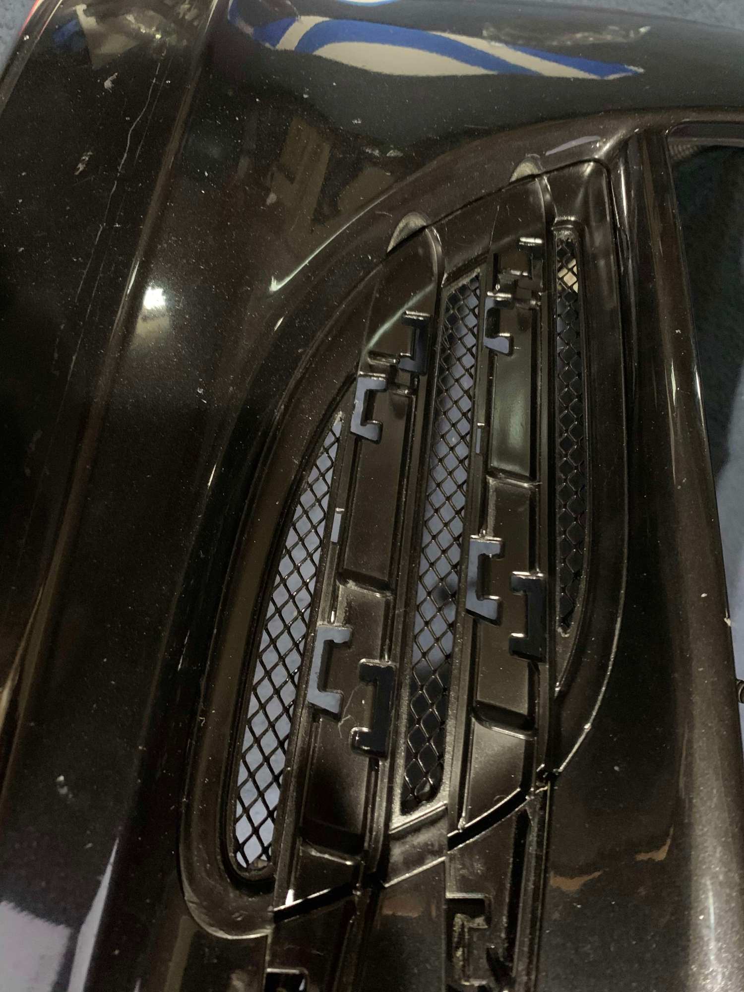

Now upon removal of the bumper I noticed that my lower grill had been attacked by road debris at some point or another with a crack...welp sounds like time for another modification/change.
So I cut out the rest of the grid and I'm waiting for my new aluminum mesh to arrive so I can make effective grills to project my lower radiators and hopefully update the front end.
More to come stay tuned...I'll also be updating my other thread on removing these grills from the bumper without damaging them.

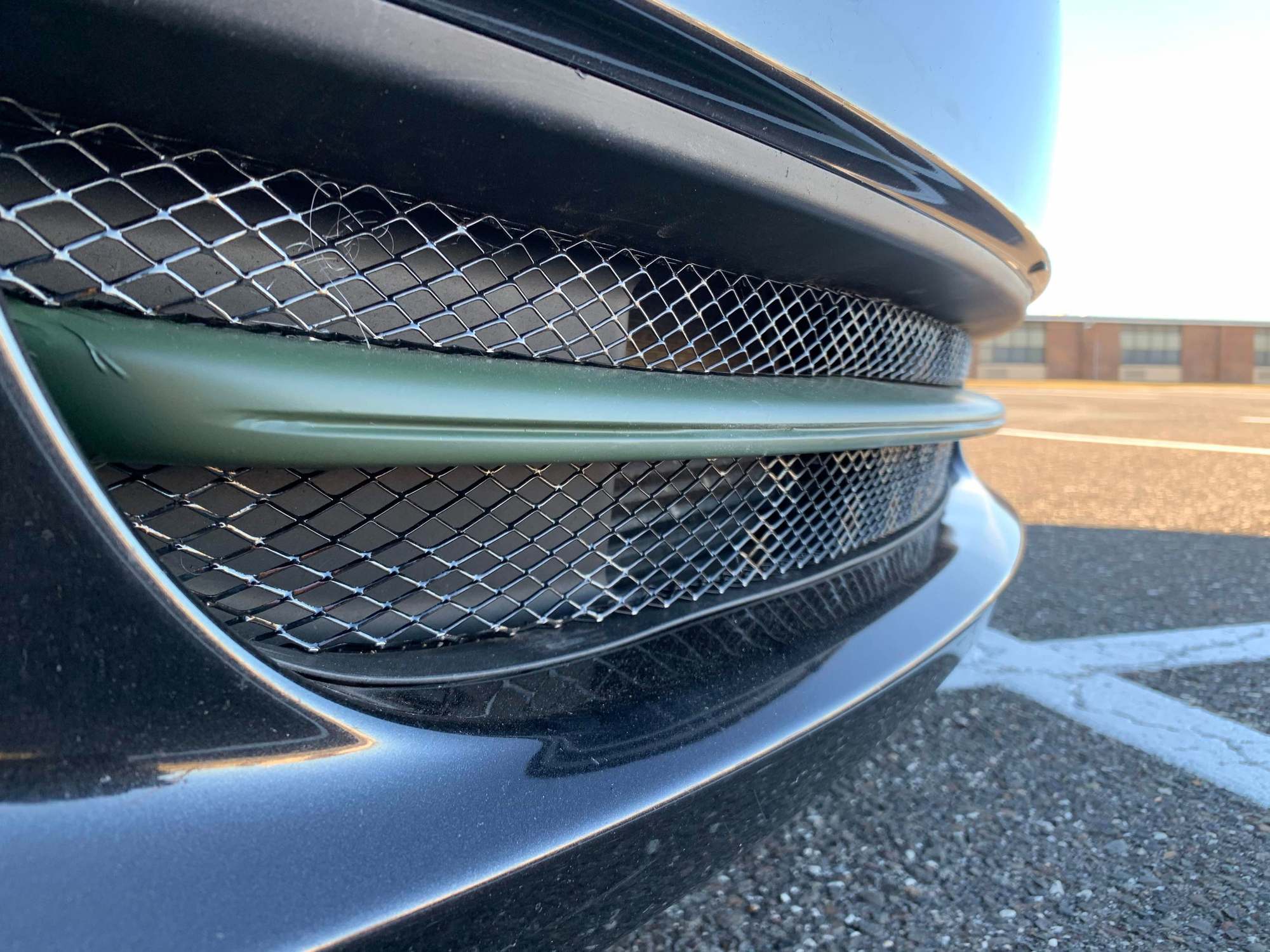

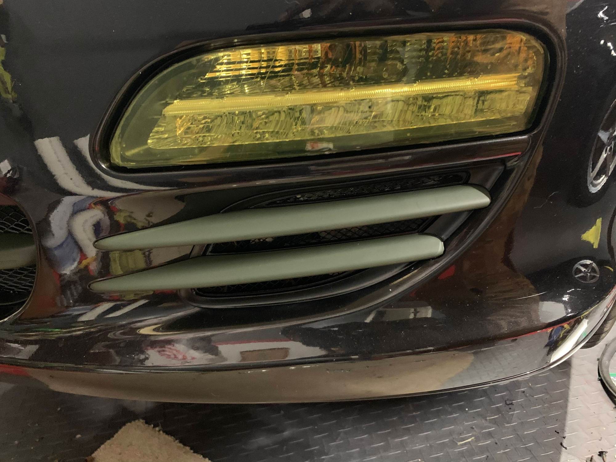

If you pay close attention you might see the differences in the mesh I used here, but I decided to take a stab at modifying the plastic piece below the turn signals and DRLs.
Pictures:

Proper pictures are coming once the car is back on it's feet as I have another modification up my sleeve.
I ordered this mesh from Amazon for the center grill (https://smile.amazon.com/gp/product/...?ie=UTF8&psc=1). I also picked up mesh from Home Depot for the other parts of the bumper I decided to modify.
The Amazon mesh is slightly larger which I felt was appropriate for the center grill, unfortunately the gauge of wire is not as thick as I would have liked. Both grills came powder coated/painted in gloss black which is awesome.

Nice update, the screen looks good and it should help the debris getting to the radiator.

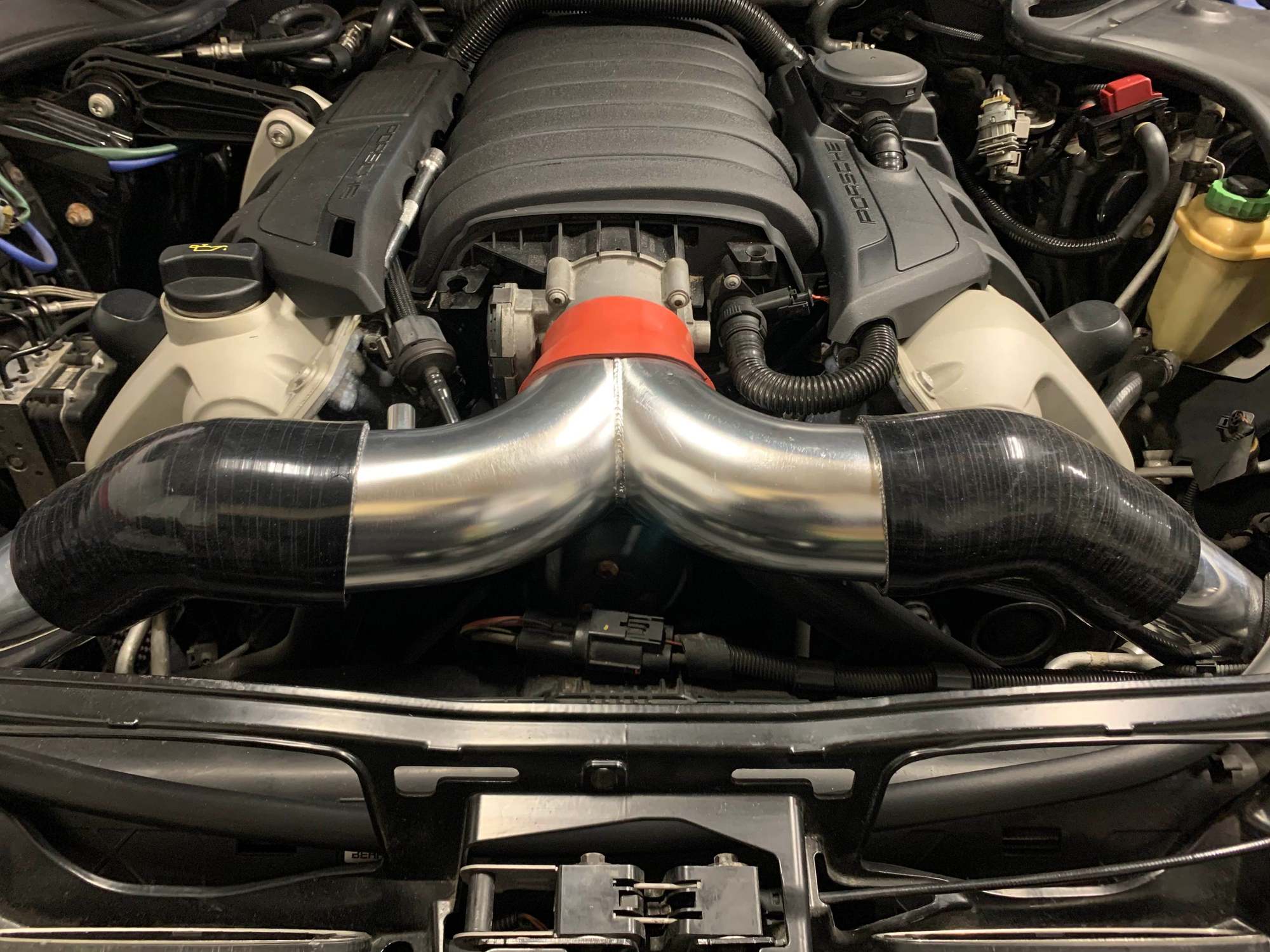

Update for those following this thread...
More to come about the components/parts/cost and installation process.

Now that is some serious air intake!

Yup! . The clamps should arrive over the weekend and I hope to have her buttoned up.
