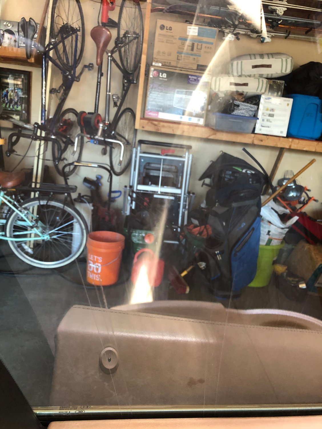

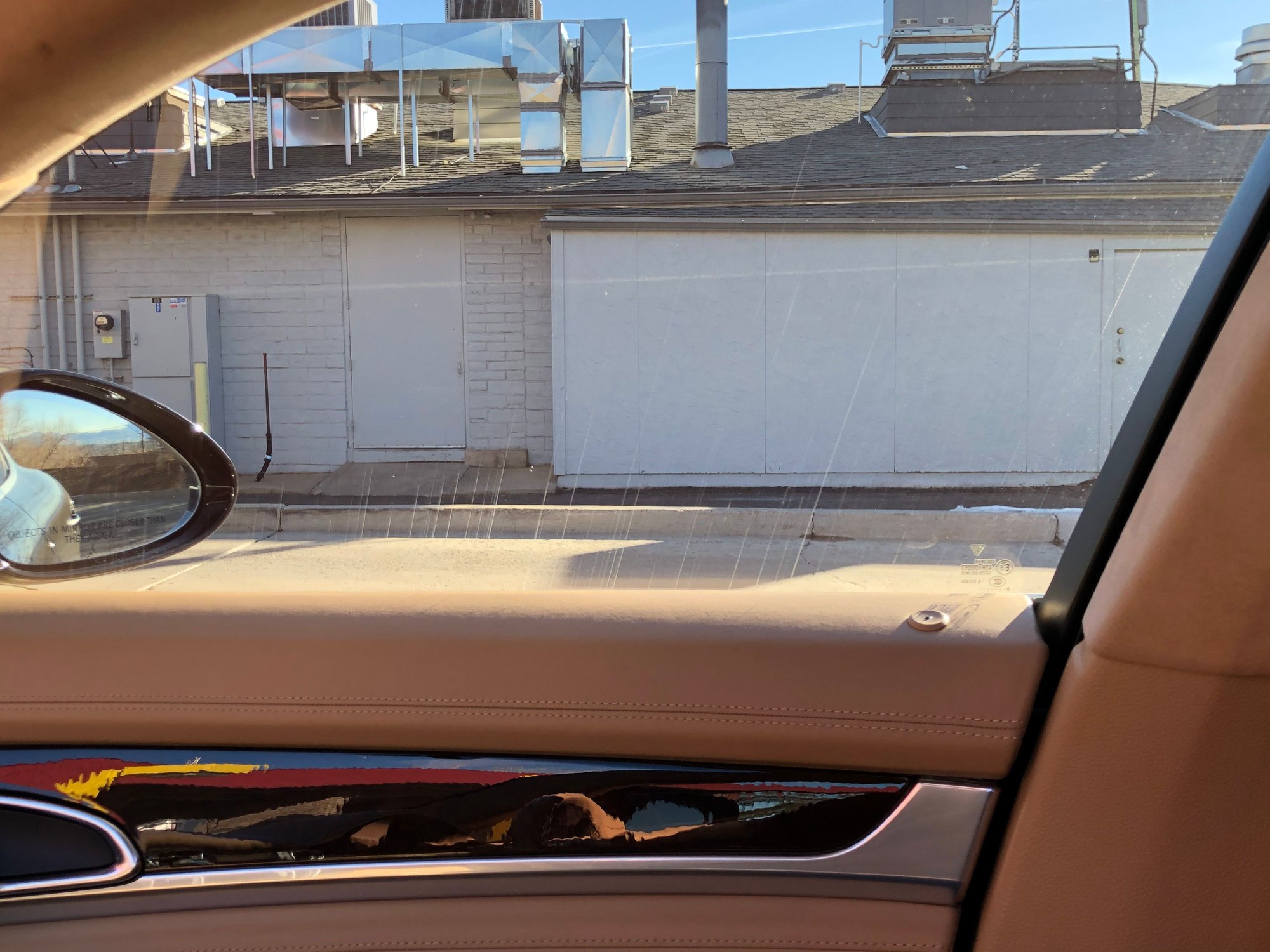

Old Jan 31, 2021 | 07:35 PM
PapaB's Avatar
Joined: Jan 2021
Posts: 8
PapaB is infamous around these parts
Here are the pictures of my scratches. If/when I replace the fonts I’ll definitely look into the moleskin/felt.
Old Jan 31, 2021 | 10:05 PM
MichaelMontreal's Avatar
Joined: Jan 2021
Posts: 25
From: Montreal
MichaelMontreal is infamous around these parts
Thanks for the pictures. I really do appreciate it. Are they more noticeable when you are looking in from the outside or out from the inside? Also, did these scratches occur the first few times the windows were lowered and raised or was it more gradual?

Old Feb 1, 2021 | 09:23 AM
PapaB's Avatar
Joined: Jan 2021
Posts: 8
They are more noticeable from the inside looking out. I just got this car last Thursday, so not sure about the history of the scratches. Good luck!
