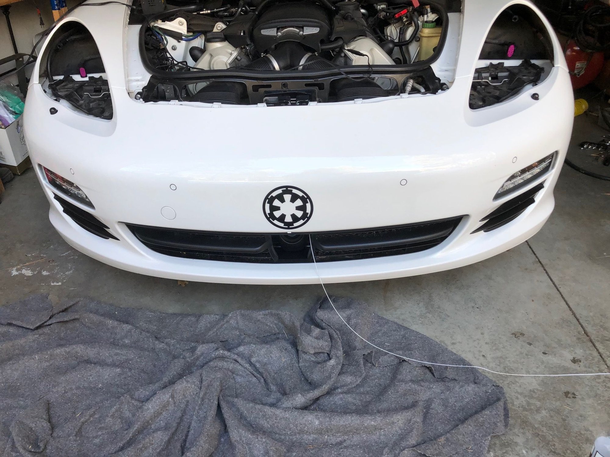

I use my hood release a lot, every time I get home I park the car in the garage and pop the hood to help dissipate heat.
There are a couple threads around where someones hood release cable or handle has failed and asking for help, the location of the hood catch makes it a nightmare to get too if you can't open the hood.
another member told me they had done this so I figured I'd do it and make small write up.
this is what makes this DIY possible - the VW part use for our cars has a little "hook" where you can attach another cable
You'll need to pull your bumper to get access to all the areas you'll be working in

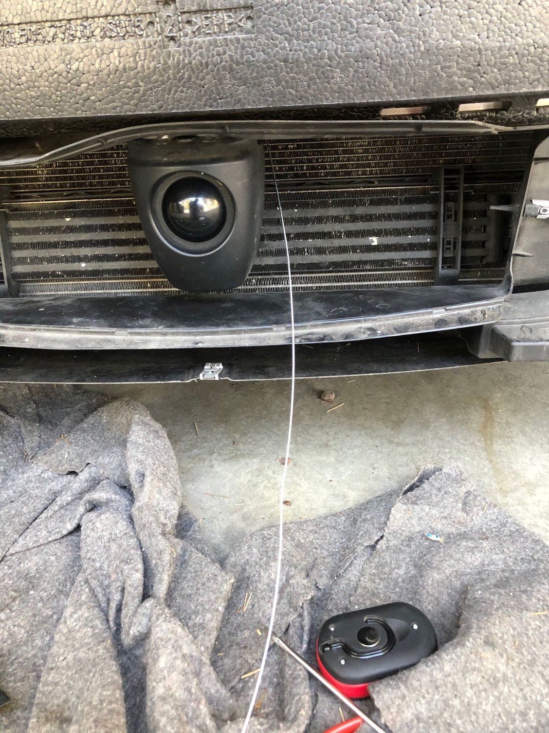

I made a cable stop by drilling thru a 10/24 hex head bolt
I ended up trimming off the big cap and putting a smaller one on it, the larger cap tended to get hung up and fail.
I had originally tried to use a choke cable, but it turned out to be too stiff - the main hood release couldn't push it down, luckily I tested that before closing the hood!!
I ended up using a bicycle brake cable - nice and flexible, because I no longer had a cable housing to guide it I had to change where I was going to have it end, original idea was passenger side behind the wheel well so I could easily pop a couple screws and reach it.
brought it straight down and out the front
Trimmed it down a bit, put a cap on it and tucked it up out of the way, will have to see if it will stay there by itself or will it require some other fastener aka zip tie
tested it a couple times and so far so good

Hi,
im a noob here that’s working on unlocking the latch for my panamera at the moment. The cable came off the latch.
id like to perform this DIY, but am not understanding where to tie the bike cable to what you drilled to make a cable stop. Do you mind explaining this for me ?
thank you!
Old Oct 3, 2023 | 05:46 PM
DogWood's Avatar
5 Year Member
Joined: Apr 2018
Posts: 935
From: Bend, Oregon
Rep Power: 47
DogWood is infamous around these partsDogWood is infamous around these parts
Sorry, was at Rennsport Reunion , but if I understand your question, you need to drill a hole thru the 10/24 bolt, you then thread the cable thru the hole and use a locknut to hold the cable in place.
the other option would to be bending the cable into a small loop and crimping the cable to keep it that way.
if you look at the first picture you can see that the latch has a arm with a C shaped hole, which is perfect for the 10/24 bolt.
in the third picture I'm holding the latch mechanism upside down and you can see the cable coming out of what would be the bottom when installed properly
does that help?
