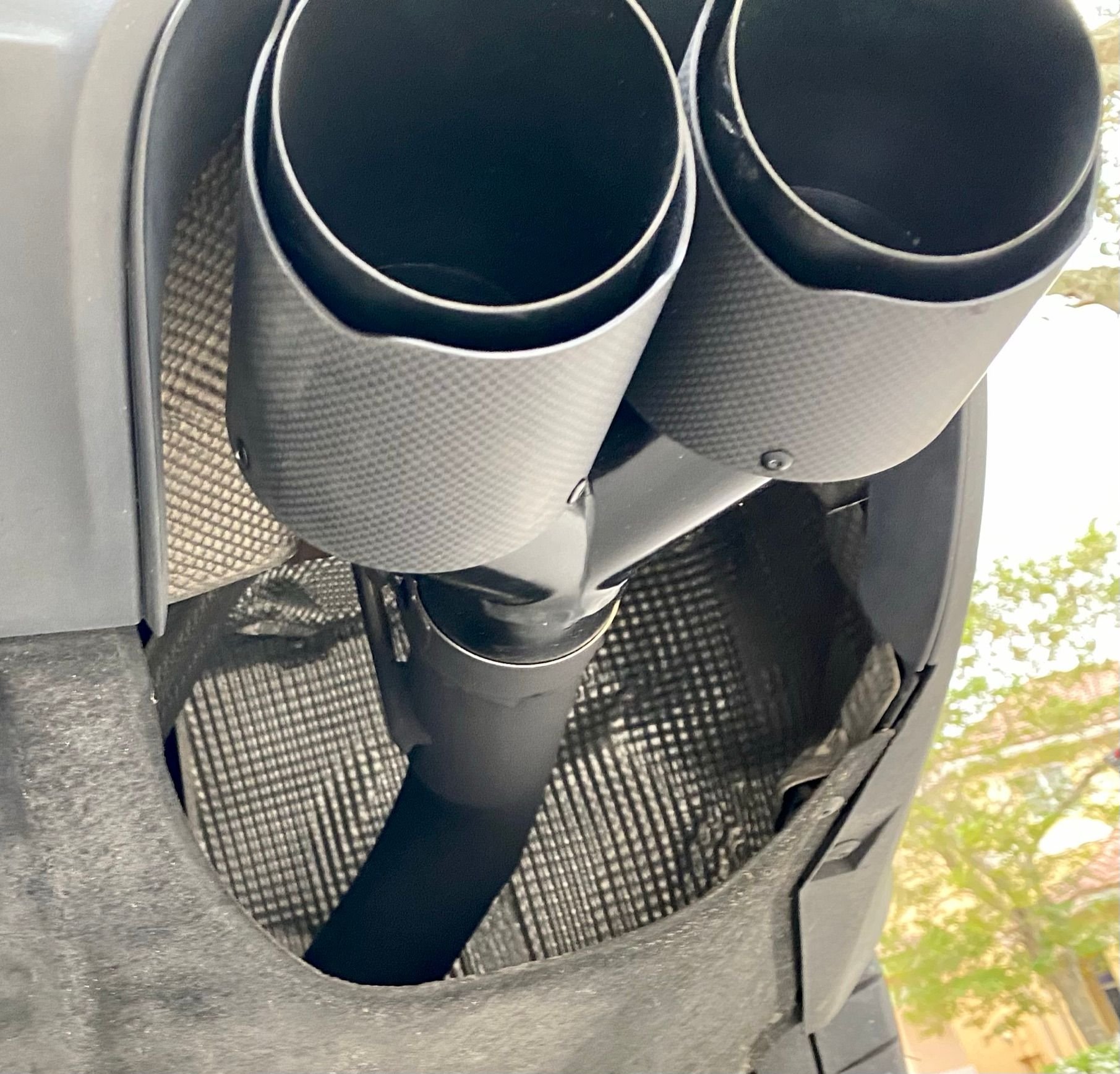

I went with removing the mufflers as many here on the forum suggested and really enjoy the change. A good shop can do it , I changed the tips at the same time. It is loud at start up and then settles, it revs nicely and you don’t really notice it at highway speeds unless you rev it on purpose.

I was originally thinking of removing the resonator and adding an x-pipe. I met someone that had it and found it too loud inside the cabin. I went to get a custom exhaust made and found the sound to be louder but agreeable with just removing the mufflers. So I got new tips and have been enjoying it like that. It is not really loud, it is loud at start up for the first minute. At high rpms you can hear it also. It is not mild to wild at all if that helps.

Lgarcia, where did you get the tips from and do they just cut the mufflers off at the input and then the tips get attached to the pipe there or is there extra pipe needed?

The mufflers are attached to pipes routed towards a center location where the segments are clamped. All they did was loosen the clamps and take the mufflers off the hangers.
They they used their own pipe with custom bends to route the flow in the same OE route, used the OE hangers and added the aftermarket tips.
