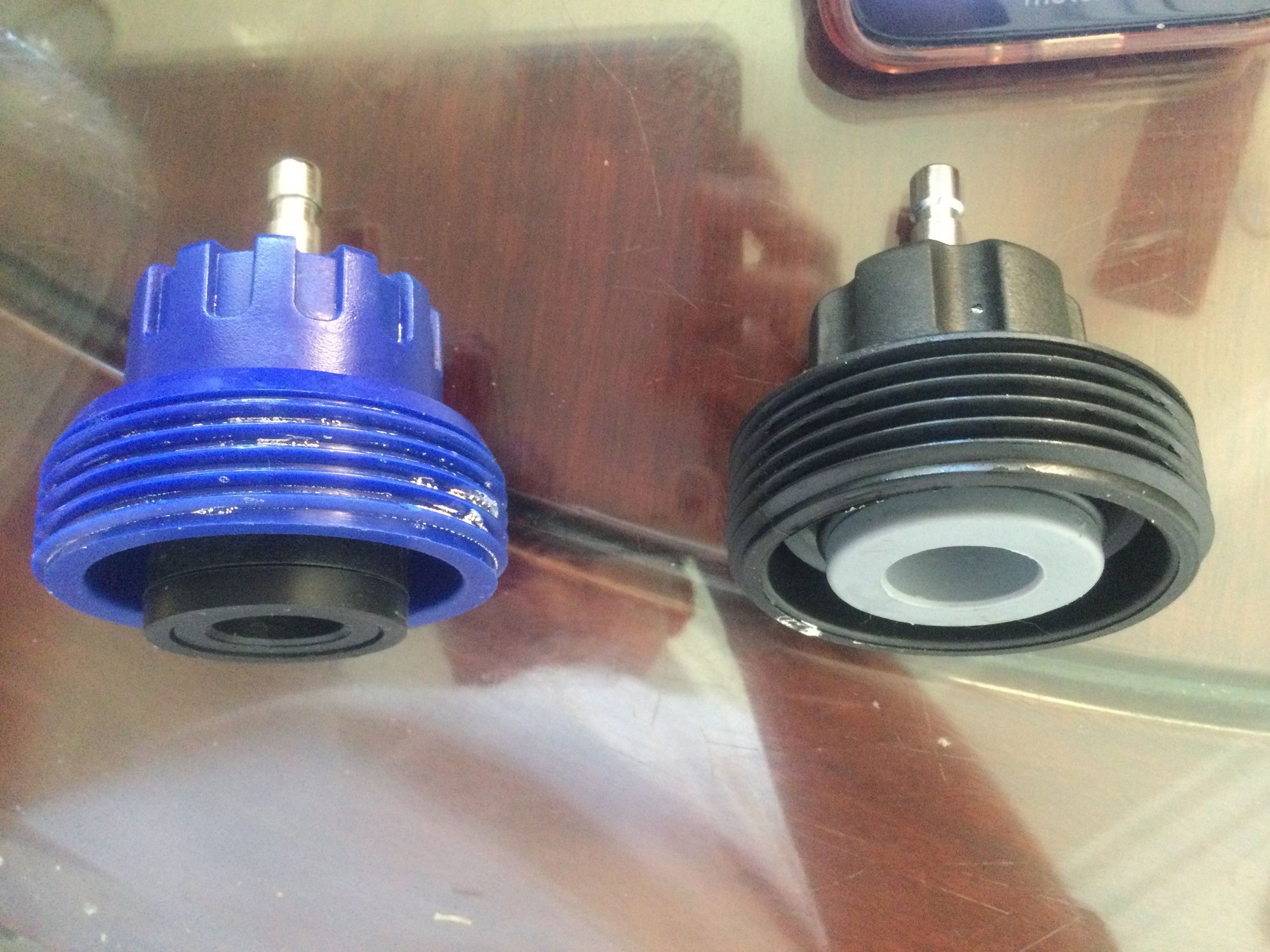

I’m afraid it sounds like your adapter is leaking, and/or the pump. I have two sets and the adapters are slightly different, my first set the Porsche/VW/Audi adapter leaks. To prove it I ordered a different set and tried it.
The one on the left leaks like you describe. The one on the right does not leak. I verified the pump doesn’t leak by trying a different adapter on a different brand car.

I hope the picture helps you determine if your adapter is leaking, probably a sign if you are getting coolant onto the threads as you see dried up silicate on the left…..

My cap isn't leaking i sprayed soap around it and nothings leaking from the cap. I tried a my mityvac pump on it and same results. Hissing right by the tank.
