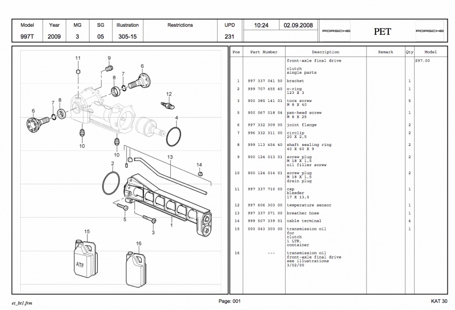

Originally Posted by cjv
Chad the part you showed here correlates with part number:
997 349 020 50 front-axle final drive ready for installation
It retails for $4448.00 ...
Appreciate the info. If I can make it work I intend to get one for KA. I'm using a lower front crossmember so this will be interesting.
I going to have to talk to Cary Elsinlohr of ERP and find out what he may know.
Here's the part sheet:
Not sure about the computer/electronics
Again, thanks for the information.
