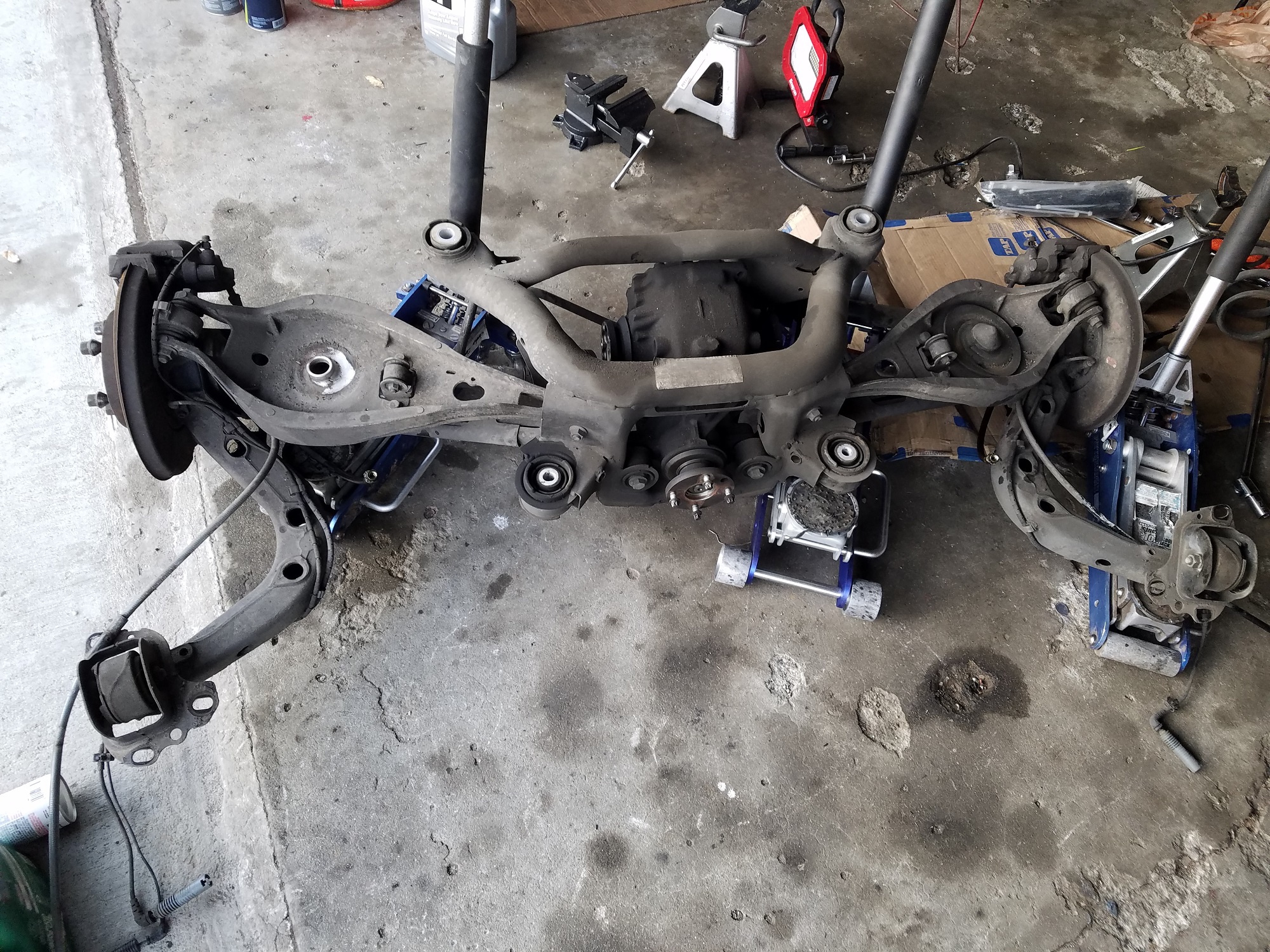

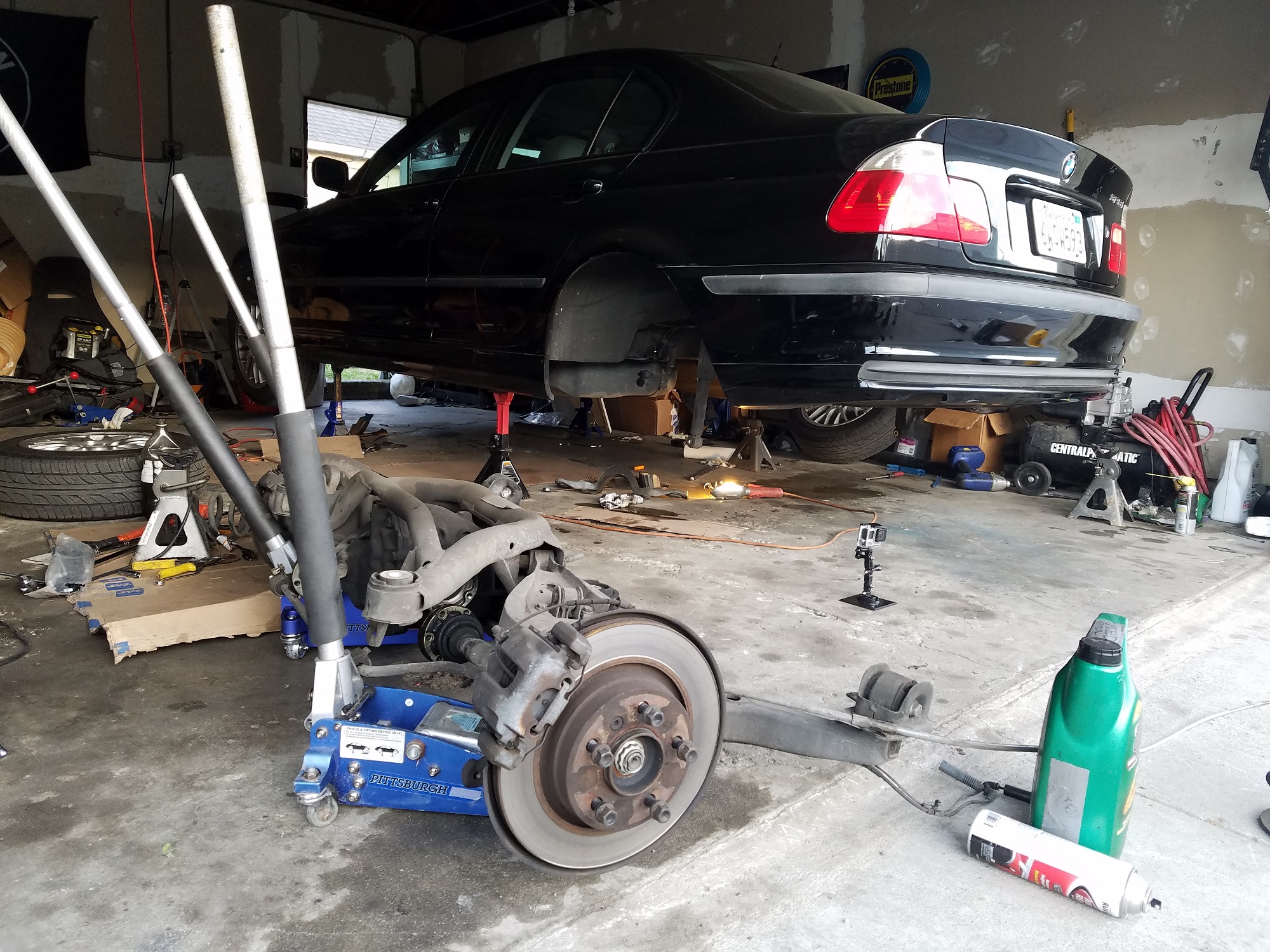

Now that we are all up to speed, let’s jump back into the action. My goal for today’s episode was to drop the rear subframe assembly out of the back of the car to handle a bunch of repairs and upgrades. In the last episode, I started the tear down process, getting the car in the garage, on stands and ready to get going. Out came the exhaust, and the driveshaft, giving me full access to the rear axle of the E46. From there, it was a matter of unbolting the hand brake lines running to the brake calipers, the brake lines themselves and the trailing arm bolts. Now, all that remained were the two large studs, and two large bolts securing the subframe to the chassis of the car.
Coming down!
The subframe assembly, with the differential, suspension and brakes attached is quite heavy. My well-calibrated forearms say there’s about 200-pounds of back break there, so lowering it down was to be a gentle, careful operation involving three floor jacks and some clever coordination.
Of course, all of that went out the window when one of those jacks decided it could no longer support my thrifty ambitions and quit half way through the job. The jack tagged me in and I had the pleasure of benchpressing the subframe down with my other two, still-loyal floor jacks. After some tenuous, strenuous and other -enous words later, the subframe assembly was out, sprawled on my garage floor.
Look at all of this money I’m going to burn. Oh well, what’s a paycheck between two not-friends-because-it’s-a-car?
