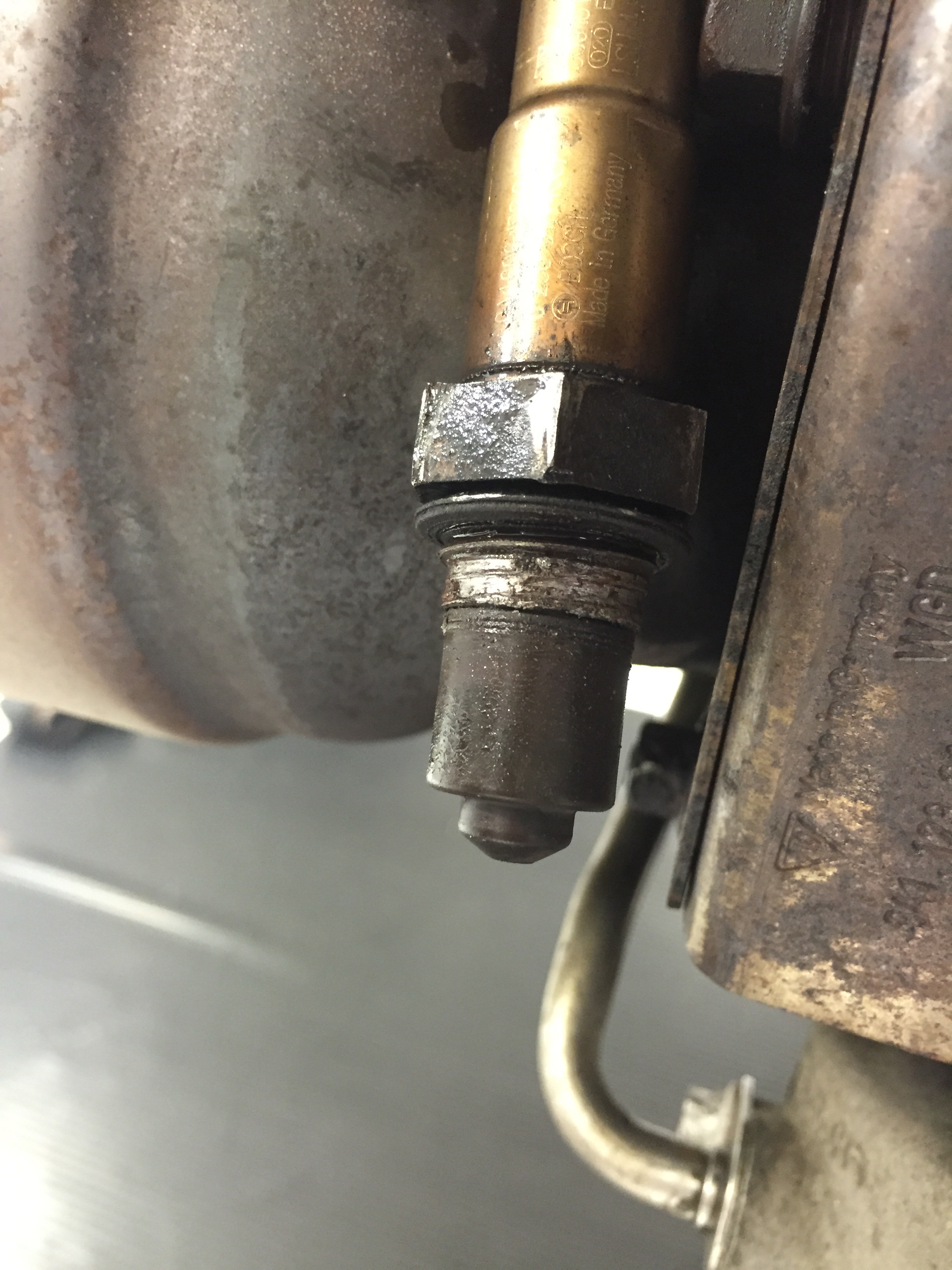

We're running the car thing morning...hang in there. Unfortunately, the installer who installed SDG's EP exhaust cross-threaded both pre-cat O2 sensors so they were too damaged to re-isntall and we needed to order two new replacements. They just arrived and we'll be getting the dyno runs done asap. Stay tuned...
Tom is correct. Champion had to fly in two replacement sensors as the original sensors' thread was stripped by the original installer. That caused the delay. Given that the threads were stripped they could not be screwed into the Tubi catless race exhaust. Would never have known had I not switched exhausts. They were functioning fine but with no thread could not be reused. The installer will reimburse me for the cost of the replacement sensors and shipping.
A little frustrated that I cannot get the car back in time to compete with it in the Sunday's racewars roll races at Pocono Raceway but that's most certainly not the fault of champion. I'm happy they discovered the problem before the sensors fell out at some point had I kept my Europipe.
