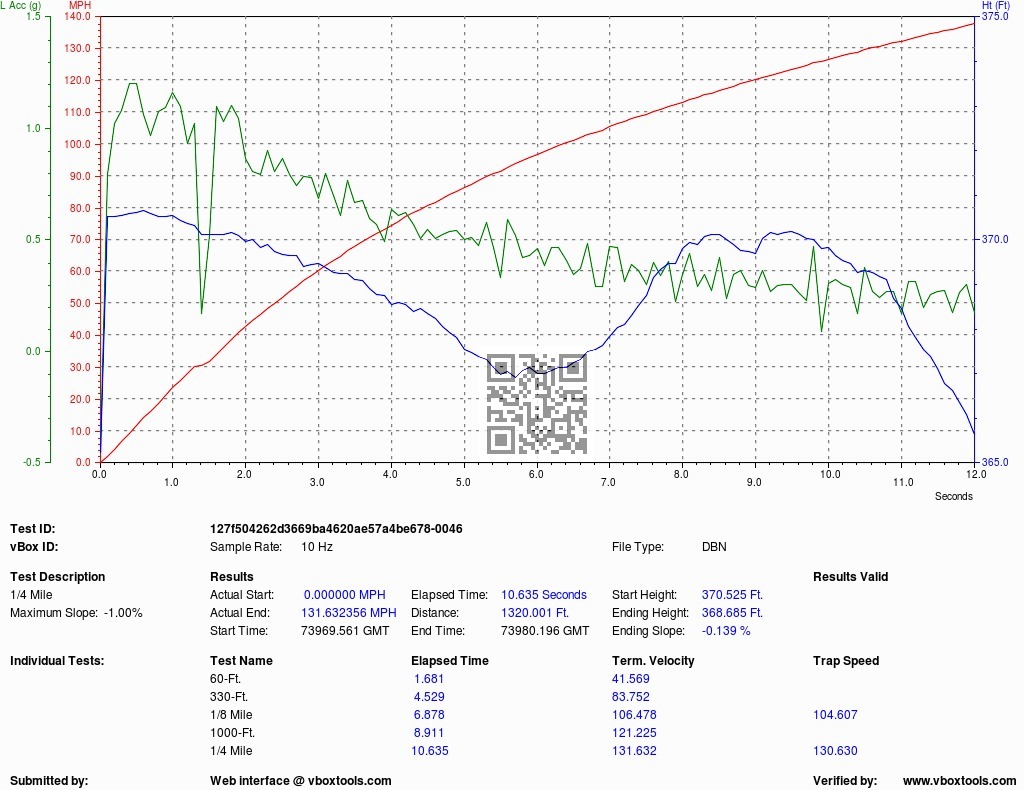

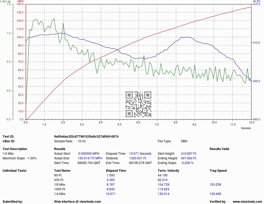

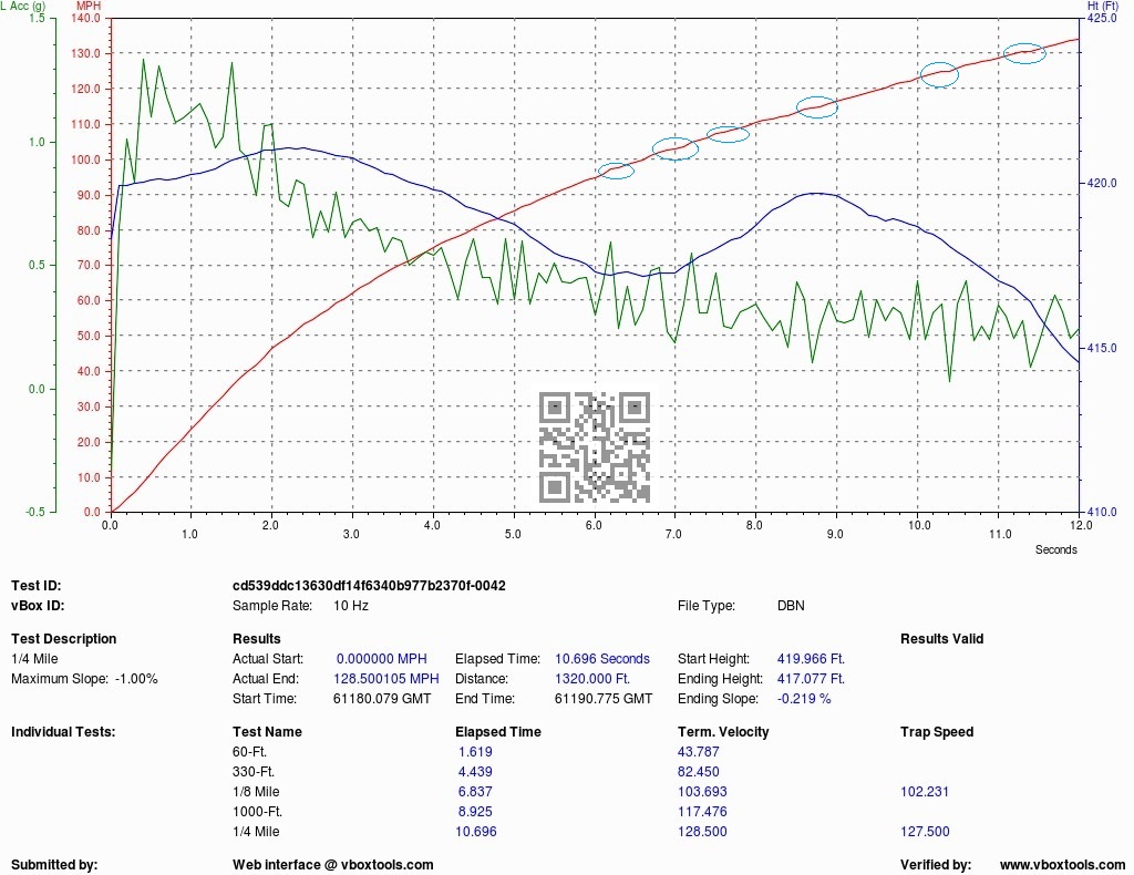

That's a good idea. I have already done that and the FVD still has the better result. The problem is that the FVD run was taken in December when the temperature was about 70 and the recent run was taken with the temp being 88 so it's not apples to apples.
The first two are with the FVD on the county road and the last one is the best one I got day before yesterday with the Cobb. However, that run had really high IATs and there was knocking and timing pull above about 95mph.
What is really interesting about those runs is that the two FVD have better 60ft times but the speed at 60ft is lower than the Cobb. On the Cobb tune the 60ft speed is about 41mph while the two on the FVD module are below 40mph at 38 and 36. Pretty strange too because the slower 60ft FVD run has some obvious TC intervention around 30mph in the first 60ft but the car still runs a 130mph trap speed which is faster than either of the other two runs. Pretty sure this is going to be attributed to the outside temps being 65-70 and thus much lower IAT.
