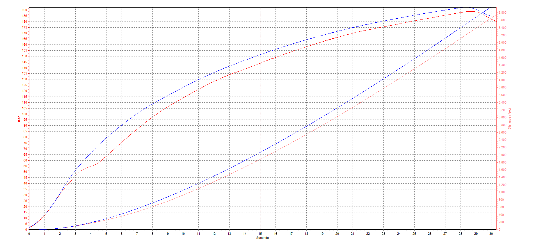

Vbox data is in! and it's very interesting to say the least.
I graphed the GIAC Stage 2+ pump tune run (red) against the Cobb Stage 3 100 octane tune (blue).
in the end, the Cobb tune won the mile by 85 feet or almost 6 car lengths.
you can clearly see the wheel slippage I got when it dropped into second gear on the GIAC run, which cost speed/time. my best estimate looking at the graph is that cost about 35 feet or 2.5 car lengths.
however, before that, you can see Cobb got off the line quicker as it was already pulling away before that.
however, the most interesting part I see is that you after recovering from the wheel spin, you can see GIAC closing the gap against the Cobb line the entire rest of the way.
what does this mean? it's clear the increased Cobb torque launches quicker, but perhaps this is showing the GIAC tune is stronger on the higher end?
unfortunately, it's only one run on each and I'm really bummed I wasn't running the GIAC race tune, so it doesn't mean a ton, but it was interesting to me nonetheless.
GIAC Stage 2+ Pump vs Cobb Stage 3 100 oct
¼ mi – 12.19@129.44 vs 11.41@132.36
½ mi – 18.39@159.89 vs 17.47@162.25
1mi – 28.62@188.8 vs 27.57@191.08

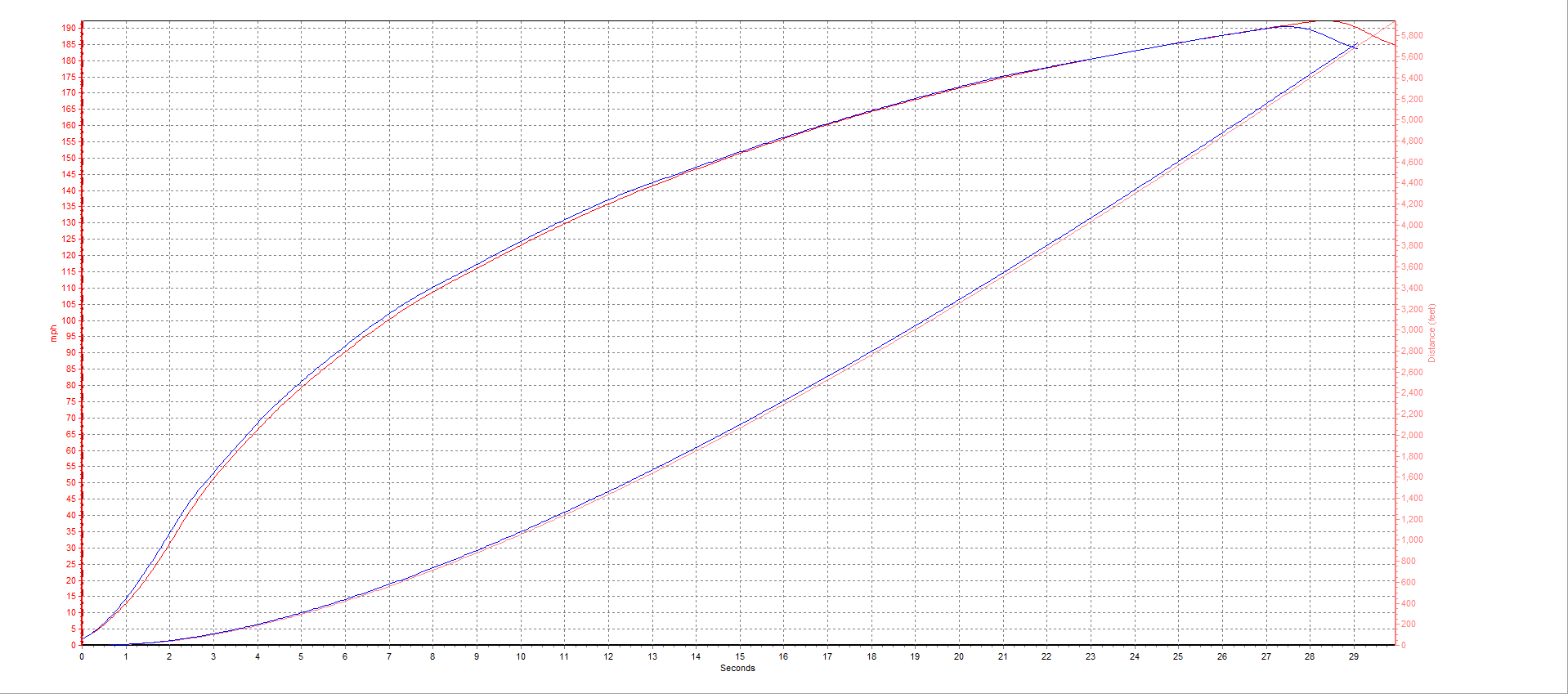

the second graph is the Cobb Stage 3 tune against the custom tune Mitch sent over.
you can clearly see the custom tune made a significant difference in time, but not really in speed. that seems weird to me since if I get there quicker, you think it should be faster also. perhaps the slight decrease in tail wind on the second run is what really hampered the speed.
¼ mi – 11.4@132.35 vs 11.25@132.69
½ mi – 17.47@162.25 vs 17.32@161.95
1 mi – 27.57@191.08 vs 27.44@190.43
No, it's the acceleration that matters. The car quits accelerating at some point but if it accelerates to the max speed sooner, it will get to the end quicker, that is why torque is important but you need lot's of HP to maintain the speed once there is zero acceleration or close to it as terminal speed is approached. Plots of speed vs time are acceleration, that is dv/dt. The blue curve is always at a higher speed and it gets to the the higher speed sooner which means it's covering more distance than the red curve sooner. That means the blue curve will cover the same distance in less time even though the terminal speeds may be equal. The Cobb tune is accelerating more than the GIAC tune and so it's going to be quicker.
