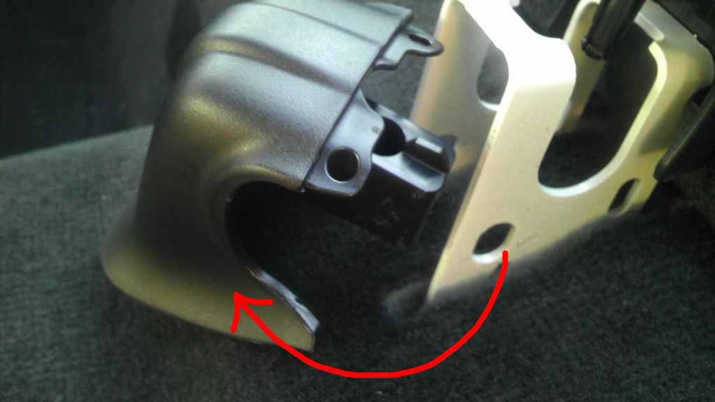

However, we could not find a guide on how to remove the seat back cushions. After a lot of prying, trial and error, we succeeded in removing those darn cushions. In retrospect, it was not too difficult but you just have to know the proper methods and sequence. I decided to take some photos to help explain the steps.
1) Start with where the the left and right seat backs meet in the middle. There is one front and one rear plastic covers. Start with the rear one by prying either side first near the bottom outwards and upwards as shown by the red arrows. You can use either a large flat head screwdriver or a trim removal tool (I used a metal door panel removal tool). You can tape up the tools so they don't damage the plastic parts. After you got one side out of the hole, you may want to use something to prevent it from falling back in. Then start working on the opposite side. I had to do this several times because once I got one side out, when I start to work on the other side, the original side falls back in.

2. After you get the rear piece out, remove the front piece by prying on one side outwards and forwards as shown in the photo below. Once that is out, work on the opposite side in the same fashion. Once you have remove both the front and rear center covers, you should be able to slide out the two seat back cushions easily.

Originally Posted by viper3838
Hi Socal
Need your help. I am trying to get those darn seat backs off to fit my kid's carseat but just can't get that front plastic piece off. My fingers feel like they will snap trying to pry that front plastic cover off...but it wont come off. Is there a trick to it? Pls help!
Using your bare hands will be hard. Try to use a couple flat head screwdrivers (I think I actually used door panel removers) and apply force simultaneously on both side in order to snap the trim piece off. If you just pry one side at a time, you will not be able to remove it. Good luck!
