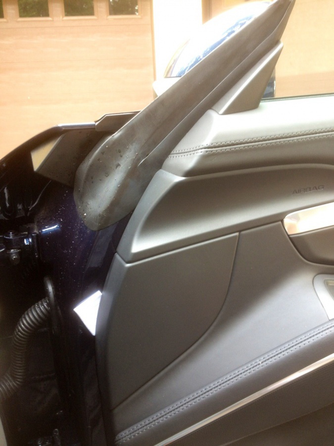

Name:  Rattle at front speaker.jpg
I happen to save above picture from this forum some months ago. Credit to the previous poster.

Originally Posted by exponential
Attachment 259918
I think this picture says it all.
Porsche, there is no substitute, but bring lots of shims.

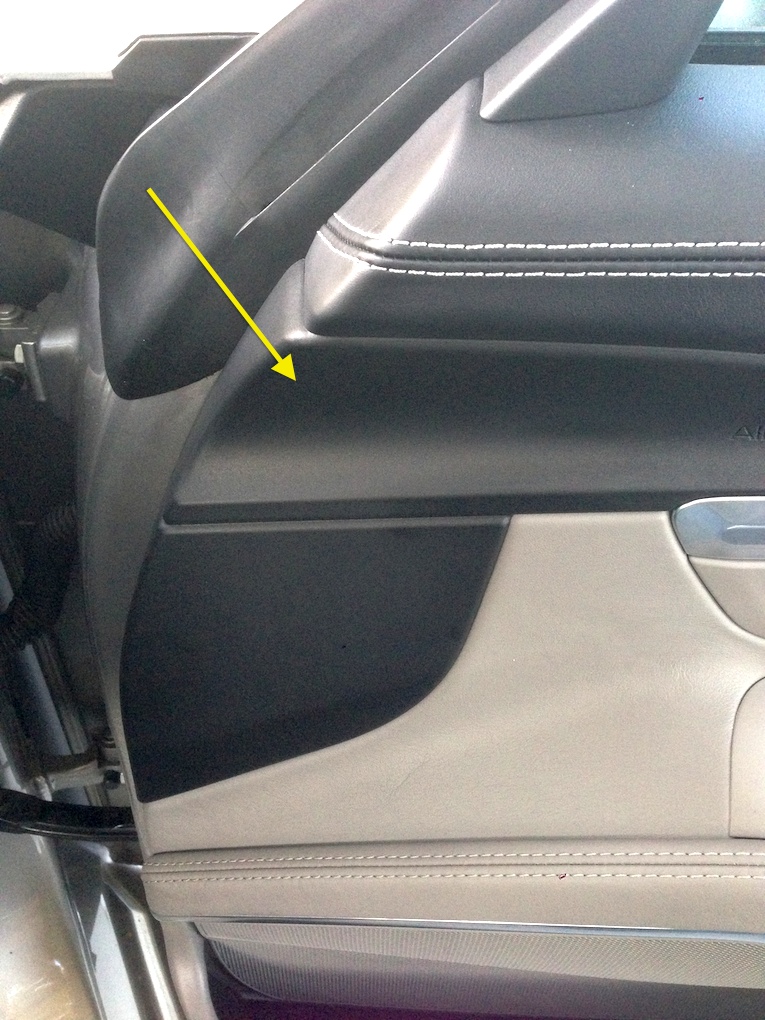

I have a consistent door rattle on the right (and sometimes on the left). If I press against the airbag cover (yellow arrow in picture below), it stops 95%. Which is an indication that there is something behind it that isn't completely tightened when I press.
Anyone know how to disassemble these panels? I'd love to take a peek...
Edit: just stumbled across mtony's post that points to this DIY page on planet-9.com. Looks complicated!
