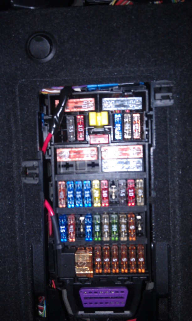

My 2013 911S has a large, orange 40 amp fuse in A1. Sorry about the quality of the picture. Couldn't get it to focus properly from up close.

Thanks for the picture, it's looks like my fusebox. I thought the empty slot was the A1. I guess yours A/C is working OK so the fuse for this is maybe the upper left 40 Amp and the empty one is A3.

The inside of the fusebox cover has a diagram for the fuse positions.

You are right the Diagram does not match the position descriptions in the Manual (p243).
A1 as Lower Left, etc
However, I am also missing A3 per diagram (or A1 Lower Left, per manual).
The picture in the manual seems to show that fuse missing also.
