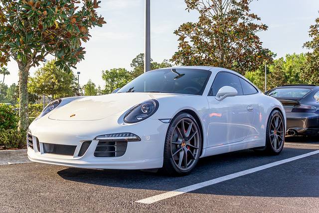

Here is a photo from Orlando Cars and Coffee a few weeks ago.

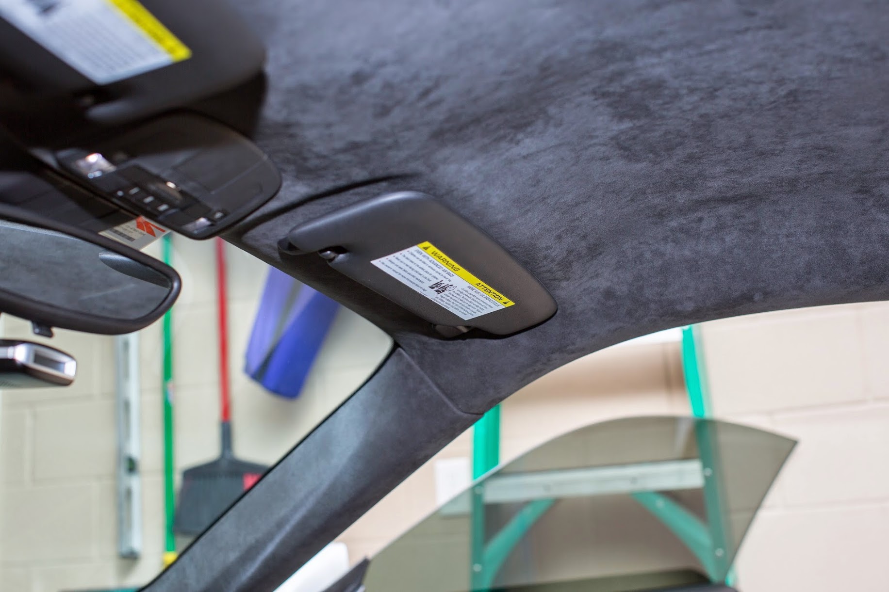

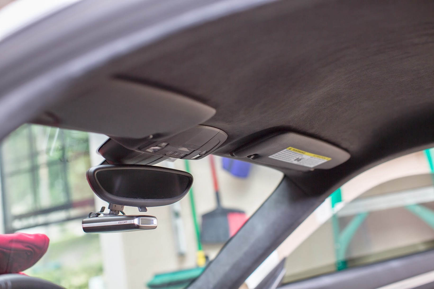

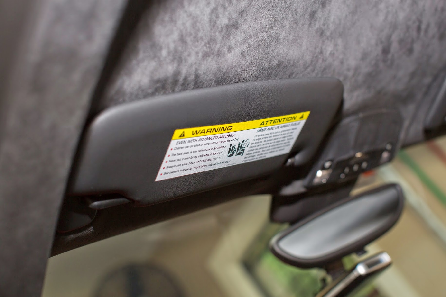

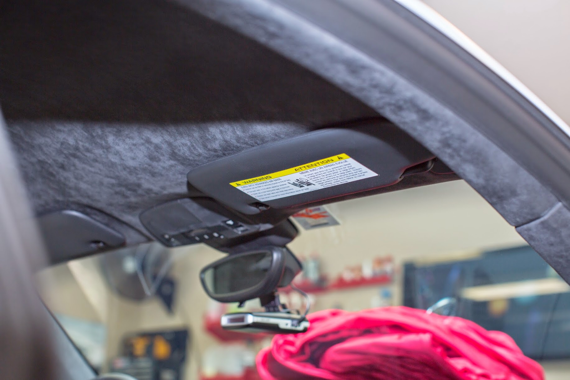

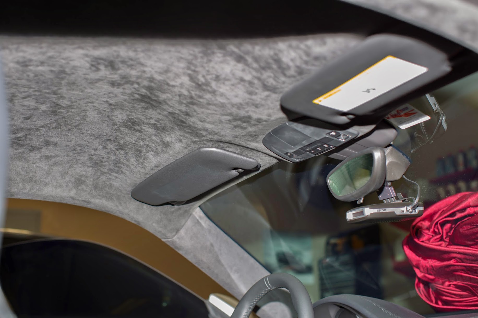

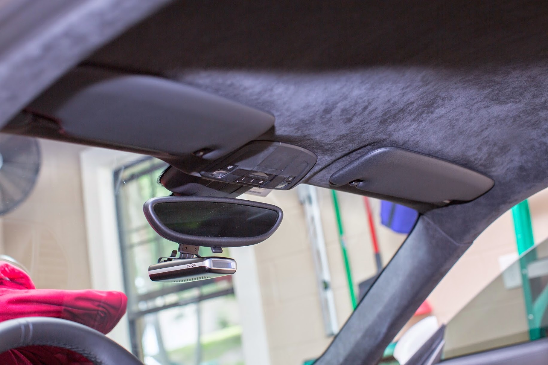

Visor Warning Removal
Somehow I got out of going to the beach for Mother's Day. You know what that means? A day in the garage for me! I needed to wash both cars.
Two weeks ago my Sonax Polymer Net Shield's beading was lackluster. It appears that massive amount of pollen we've had this spring has messed up my sealant. It's only been 3 months. I was a bit surprised as I got almost 8 months out it on my S4. I decided to switch back to my old staple: Menzerna Powerlock, wait a few hours to cure, a coat of Collinite 845, wait a few days, a 2nd coat of Collinite 845. I deconed (probably a waste of time). Then, I was able to get away with a very light Autoscrubbing using the handheld fine grade sponge and Adam's detail spray rather than using cheaper Nanoscrub or ONR. I didn't need to do any polishing.
This week I washed the car before retiring for the rest of the month. For those of you not from the Southeast, my winter is May and October. LOVE BUG season blows. These little bastards will ruin you paint, so I'll just leave the 911 in the garage instead of dealing with them.
I was planning at some point to order replacement visors without the super annoying warning labels. They looked like they were permanent. I saw RichardC's post on how to remove them, so I did it today. Here is the process.

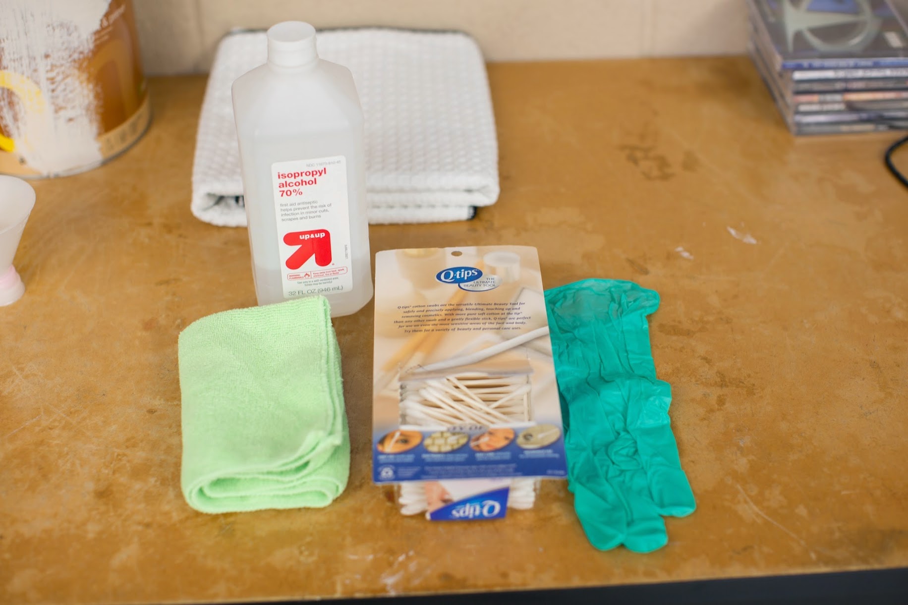

I got all of my stuff ready. I didn't need the Q-Tips.

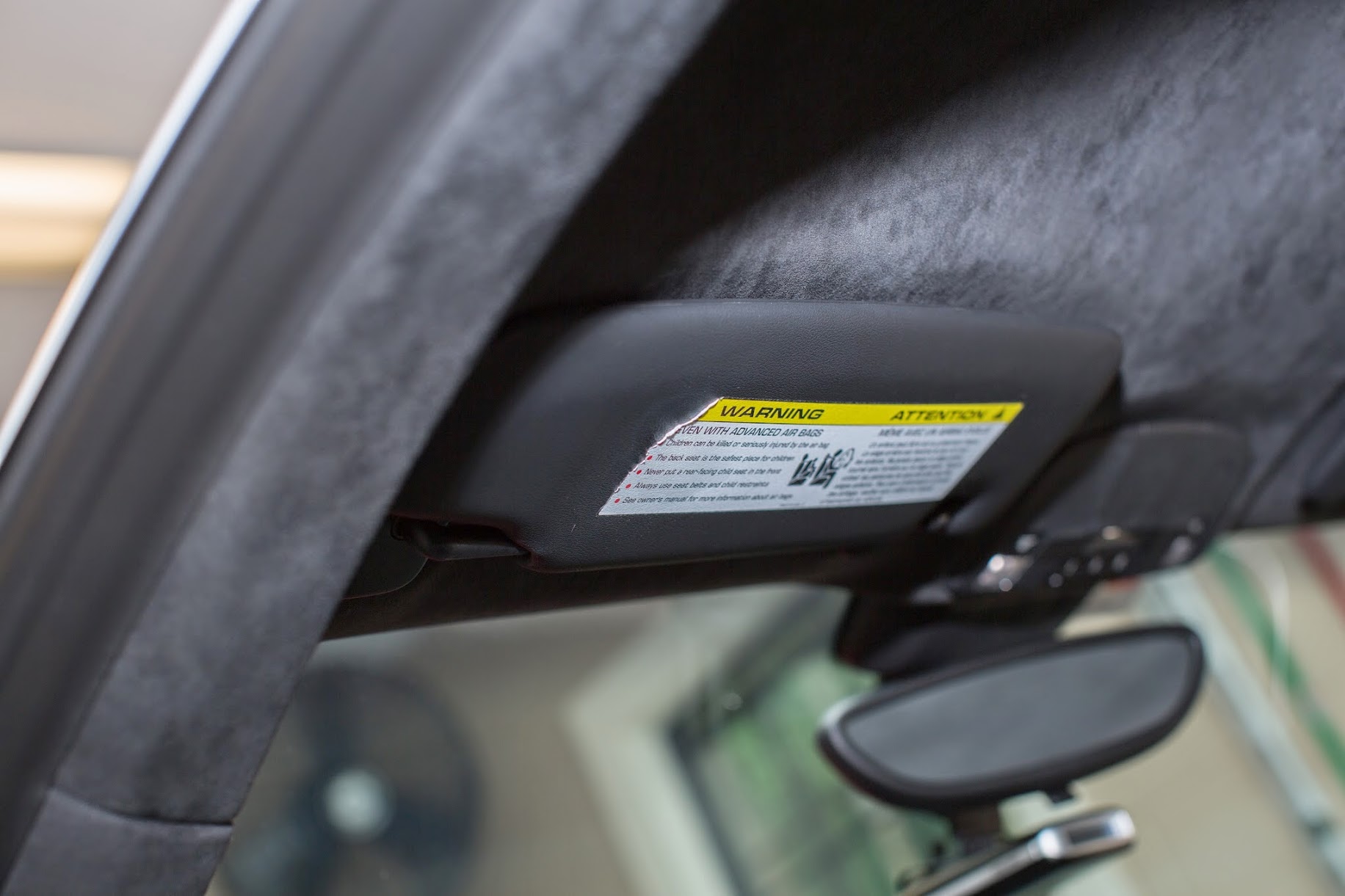

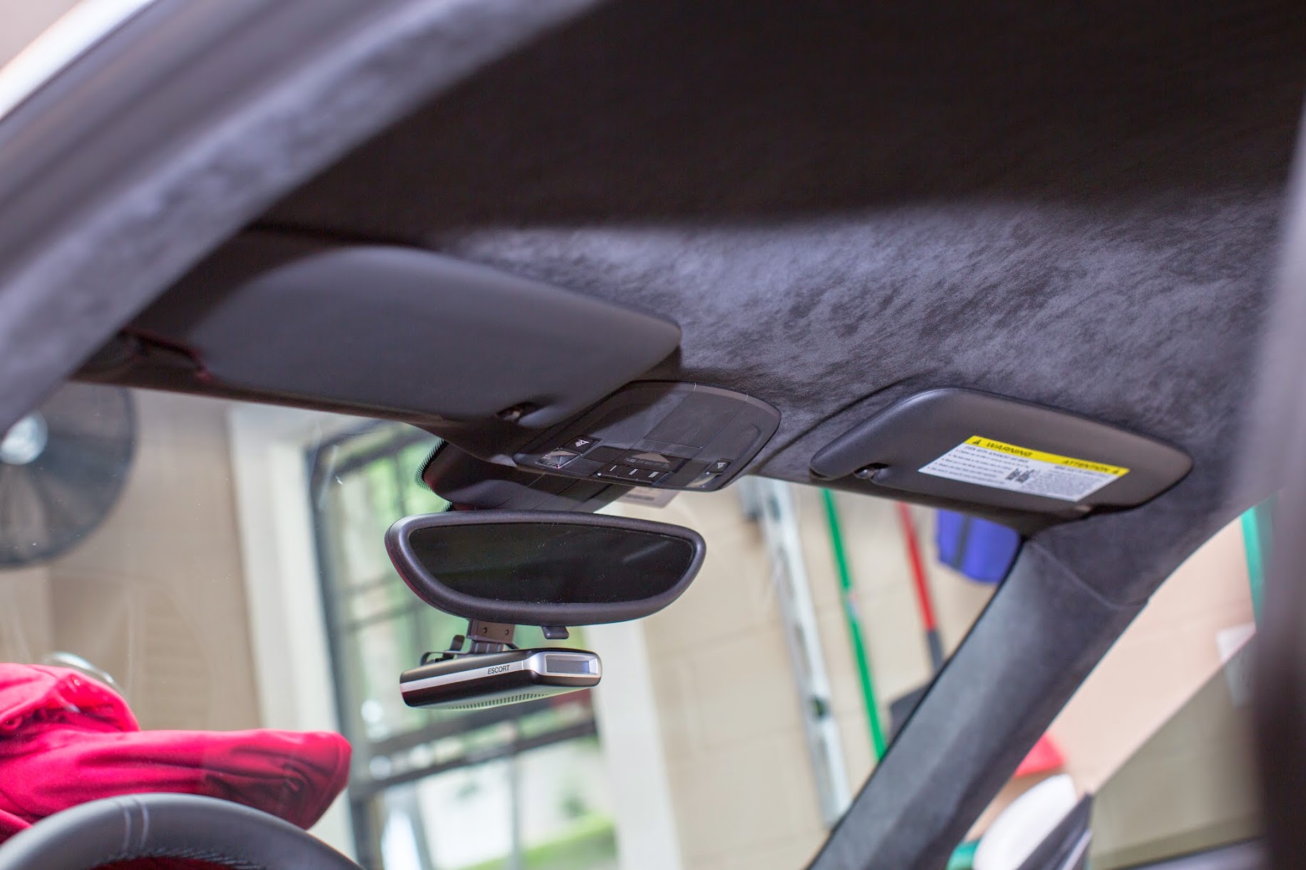

Before

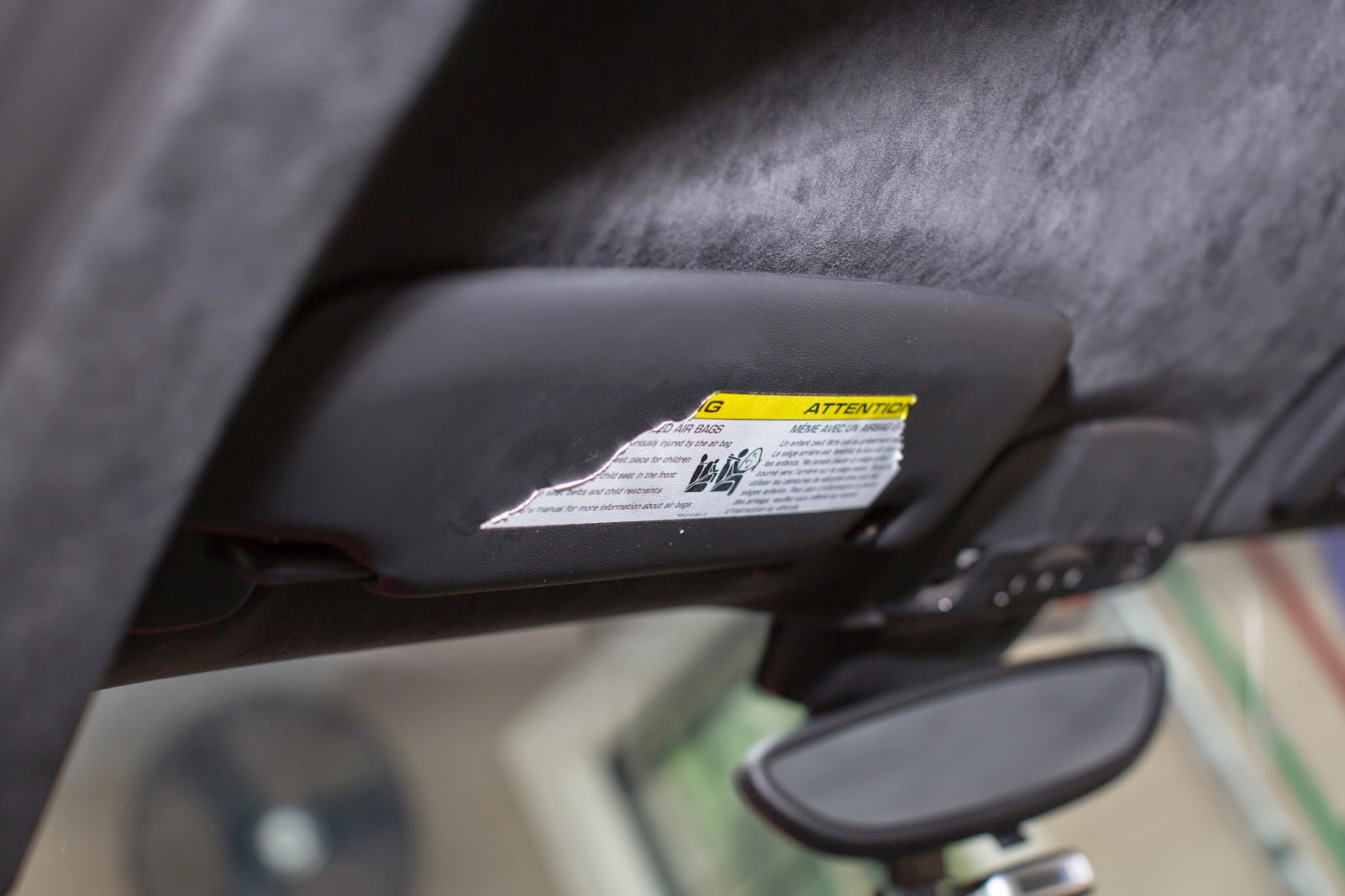

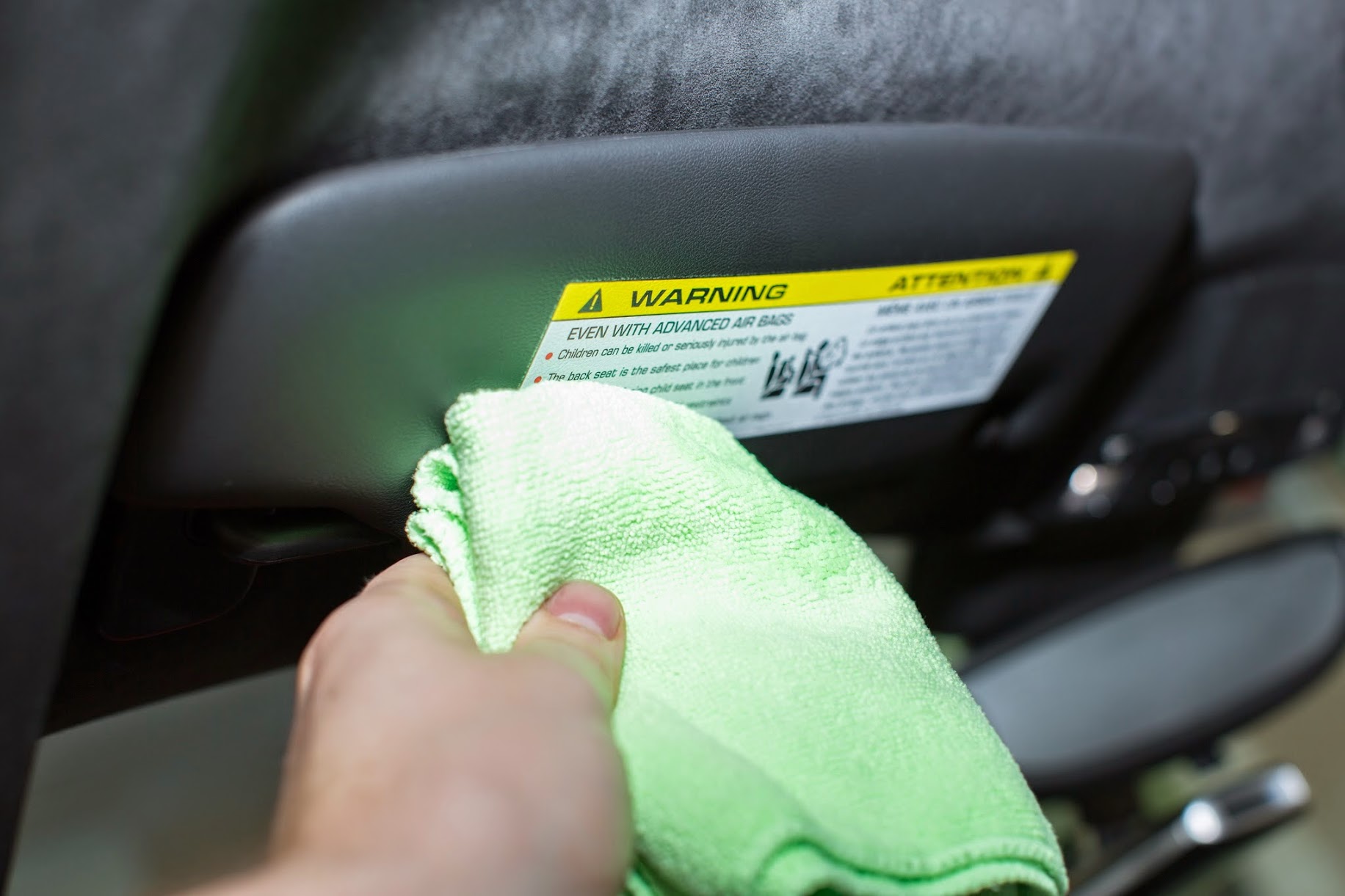

Soak a corner of the microfiber towel and wipe down the entire label. I also wiped the passenger label as well.

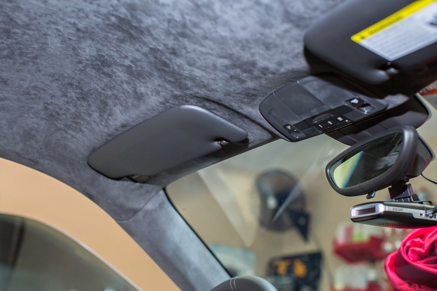

Then, just keep rubbing with the microfiber towel. I kept adding a little more IPA and wiping down the entire label. You don't need to use a whole lot of force, but it does take quite a bit of rubbing. I found it worked best going against the grain of the towel. It would catch the edge of the label. I made sure to keep the towel clean so it could do its work. I pulled and removed one tiny piece at a time.

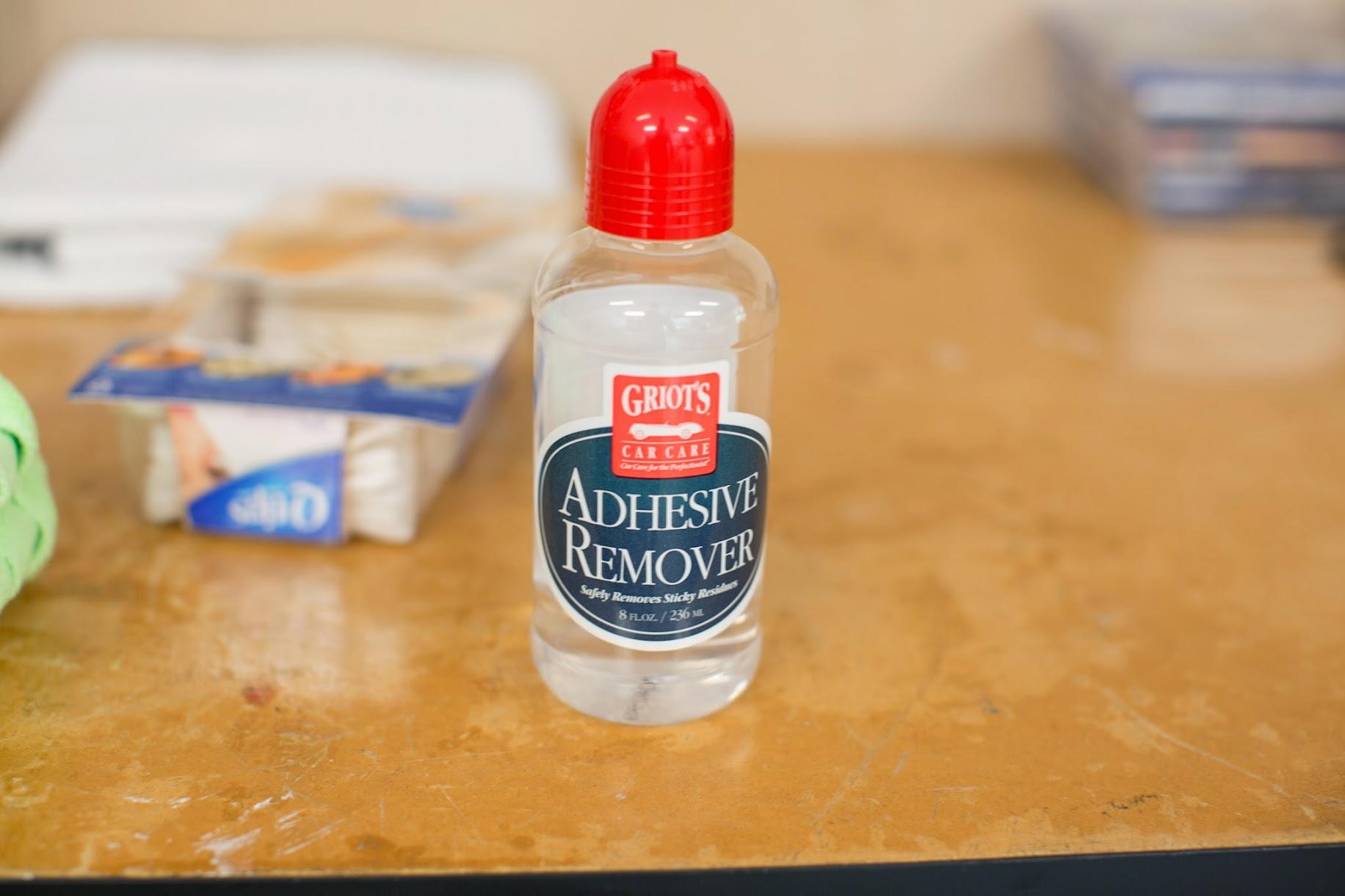

I did a final wipe down with Griot's Adhesive Remover, and then cleaned with Interior Cleaner.

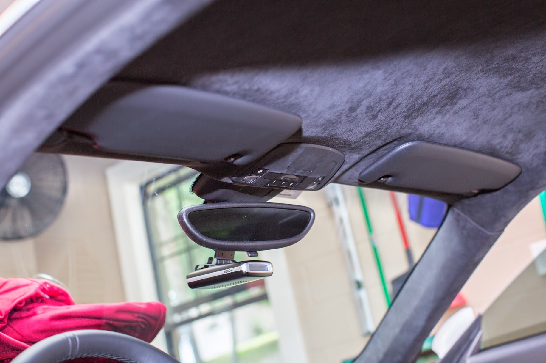

There is still a little outline as you can see using a flash, but you can't tell in looking at it while sitting in the car.
Done.

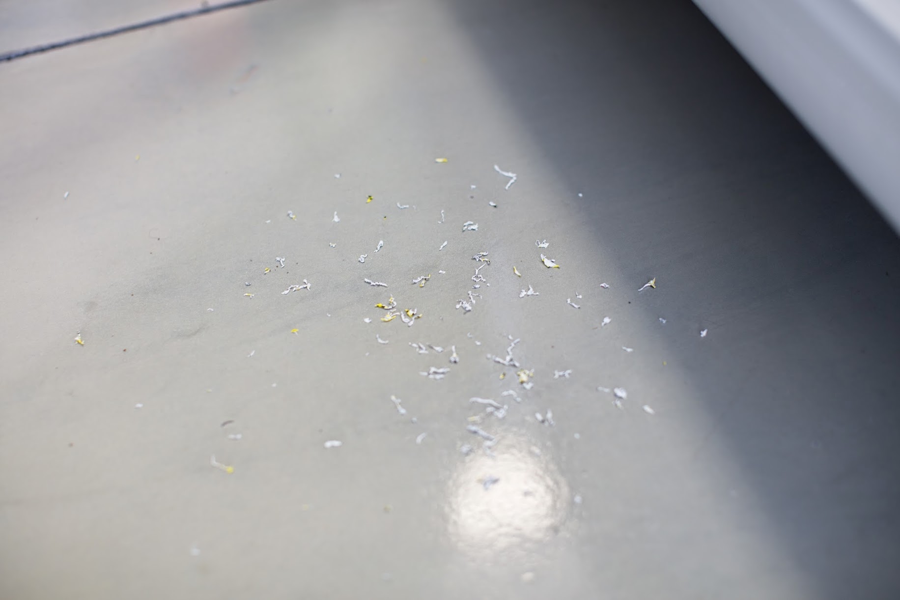

This is what the mess looks like. It took me about two hours to complete.

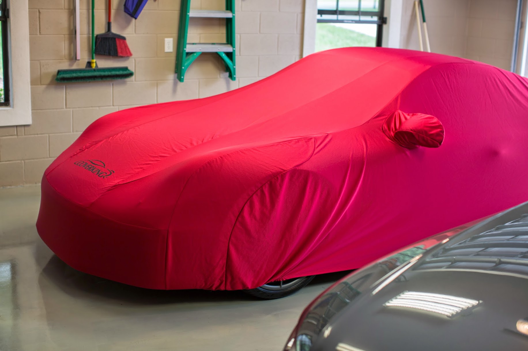

Clean, covered, and retired until June.

Thanks a lot, Matt. I hadn't paid much attention to the warning stickers before, but now they are going to drive me crazy. At least you also offered the solution to the problem.

I aim to inspire others to be completely ridiculous like me.

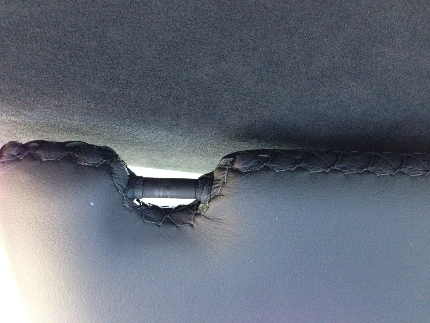

Another alternative - had mine covered in matching black leather hand stitched. Looks terrific and the cost was quite reasonable at about $300.

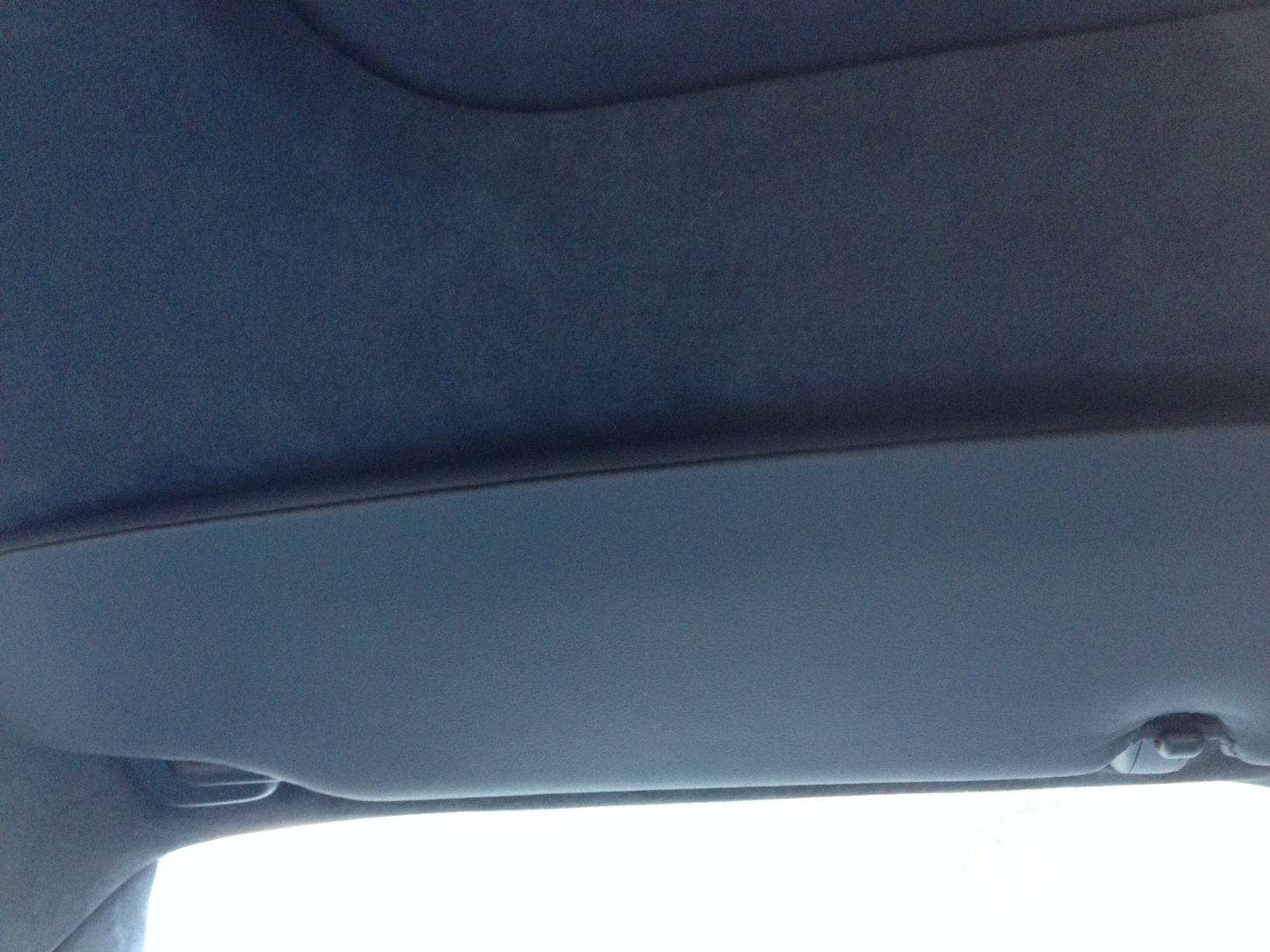

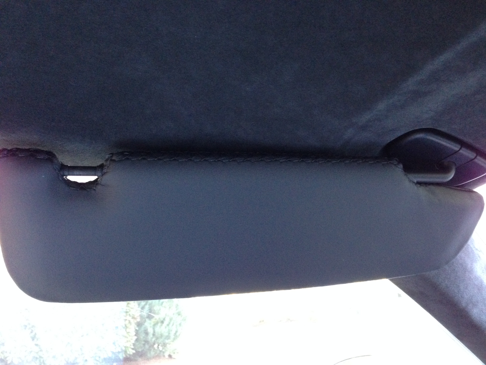

The source is:
Robert Budd
Classic 9 Leather Shop
www.classic9leathershop.com
313-682-1983
Price was $260. They look terrific - way better than the plastic.

I've been looking for a mounting solution for my Passport Max as an alternative to pulling the car apart for the 9500 installation.
I like the clean look of the rear-view mounting bracket you have. What is the name of the Company that makes those.

The mount is from Blendmount.
