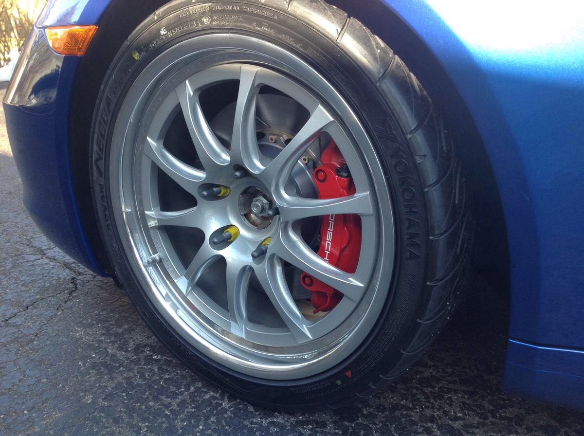

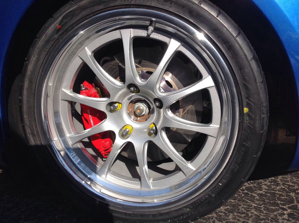

With the weather starting to warm up a bit here in the Northeast, and me getting antsy, I installed my Forgeline wheels a couple of days ago, as well as an MSI stud kit. Happy with the results. This will be my combo summer daily / track setup. Now we just need to consistently stay out of the 30° weather...
Details as follow:
Forgeline GZ3R with Yokohama AD08R
19x9 with 255/35-19 front
19x11 with 305/30-19 rear
Mounting them on the car took a while, since I installed the studs as well. I also took my Dremel with a sanding bit to the three center flanges on each wheel hub to clean up the rust. Normally I wouldn't bother to do this since this area is covered by the center wheel caps, but the Forgelines don't have center caps. I'll probably look into having the wheel hubs painted with a thin coat of rust-proof black.
Initial thoughts:
  • I was excited to use my new Jackpoint jack stands--I got them specifically for this car. Unfortunately, the car sits so low that, even with the low-profile jack pad in place on my jack, the assembly is a couple of cm too tall to get under the car. Possible solutions would include driving the car up on wood planks first, or raising the car a bit using the other jacking point on that side first. Alternatively, I could look for another jack with a lower saddle height than the one on my standard aluminum "racing" jack. In any case, I'm a bit disappointed that it wasn't a plug-n-play solution, since the concept behind the Jackpoint stands is so clever.
  • There is good clearance between these 19" wheels and the rear lower control arms. I was hoping this would be the case. Probably 1cm or so of clearance.
  • Between the 9" front and 11" rear widths of the Forgelines, and their offsets, they sit nicely close to the fenders, without being so close as to cause concerns about rubbing under compression. No spacers needed.
  • The 19" wheels help to ameliorate the "brake rotors floating in a sea of nothingness" look of the OEM 20" wheel setup. The slightly larger GiroDisc rotors also help.
  • The wheel-to-fender gap is slightly larger now, since the 255/35-19 and 305/30-19 tires have an overall diameter of about 0.8" less than the OEM 20s, but it still looks fine IMO.
Here are some updated pics. Looking forward to gaining experience with this car on track in the coming weeks.
