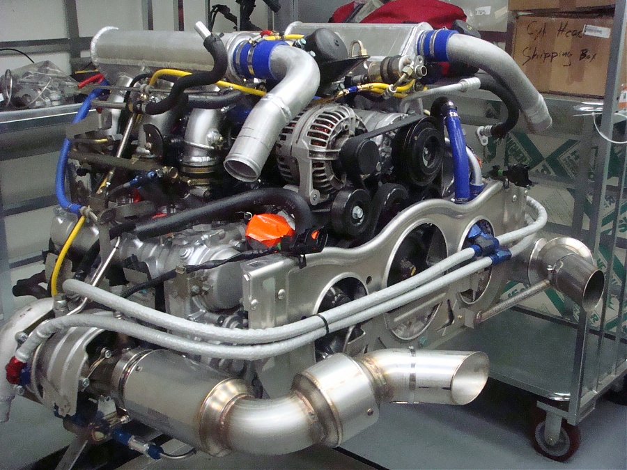

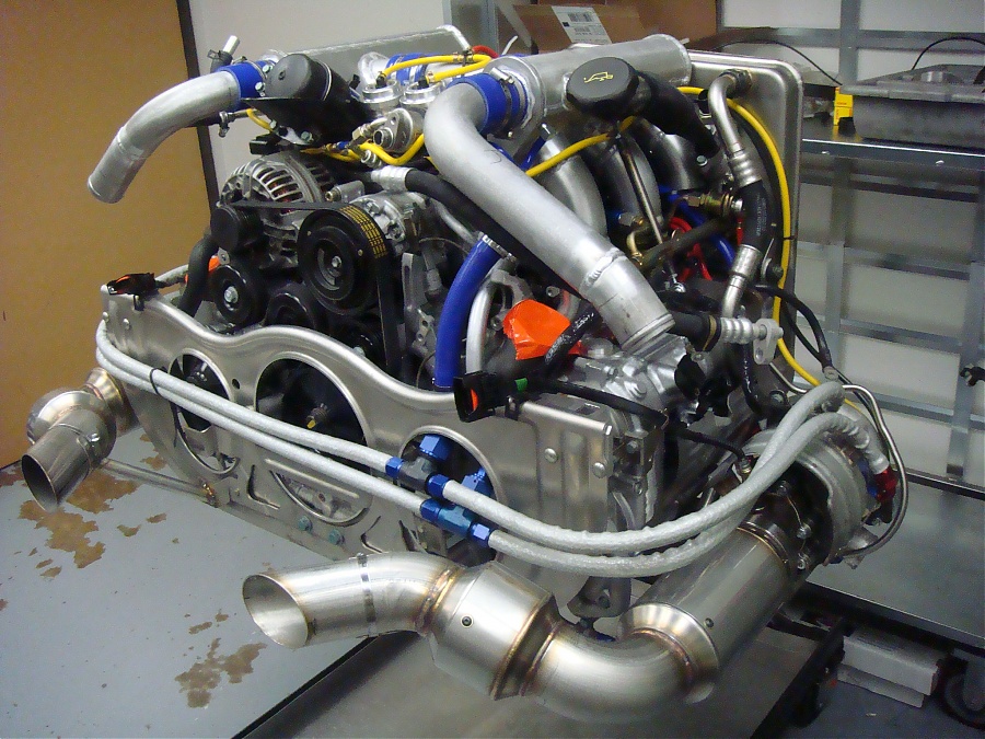

Originally Posted by 1badgt2
I am told by the builder that it saves about 35 lbs on the back end and adds about 12 lbs to the nose, where you need it.
Here are a couple more engine update pics.
just more admiration for your project. I'm stoked for still more pictures/videos of the final product. Exquisite. jaj

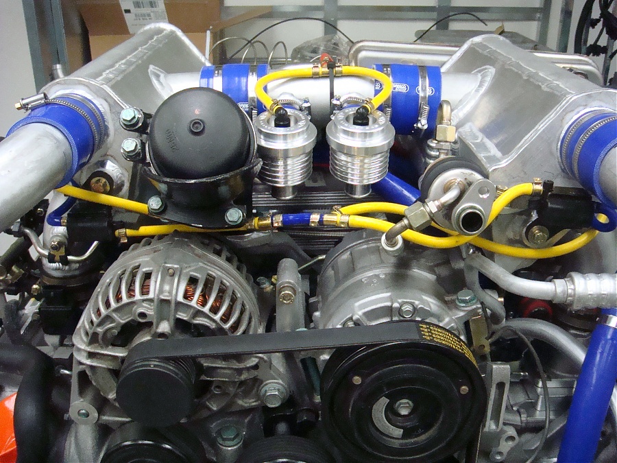

cjv

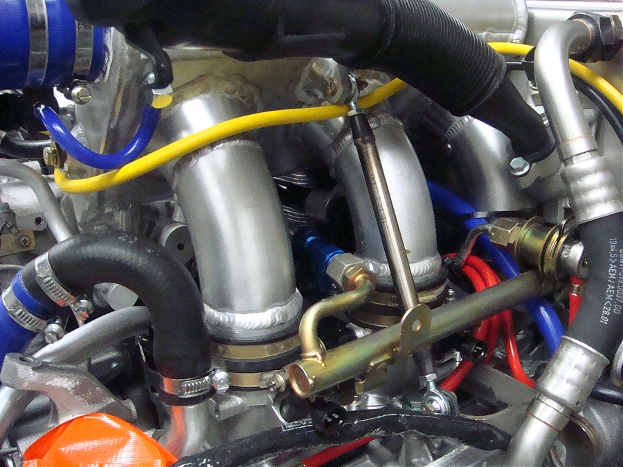

I am not sure where you received the info regarding throttle body count, but to clarify, we are using six individual throttle bodies. Here are additional engine photos that might clarify.

UGH ..... 1bad gt2 , that thing is plain sick and insane ... wow.... on the exhaust is that a cat right there as it come out of the turbo ? what is that second part near the tips ?

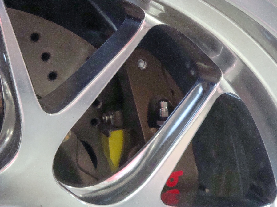

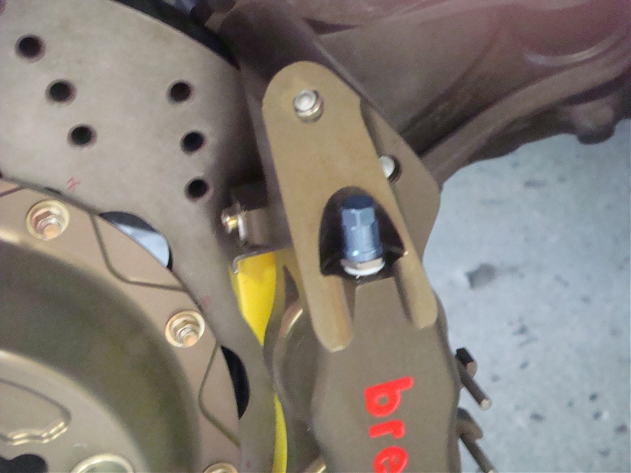

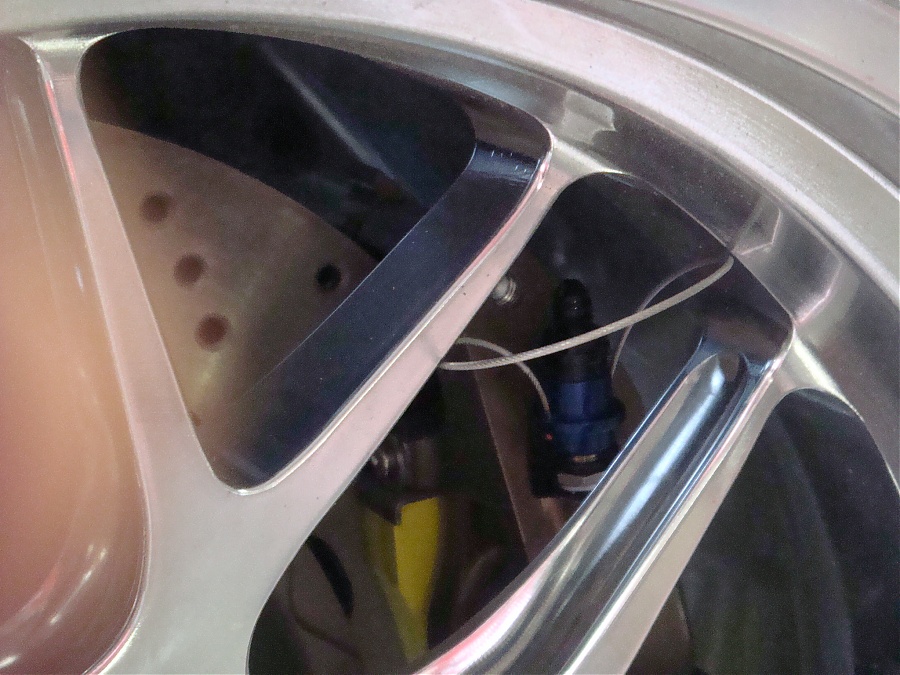

Here are some trick additions that we recently installed that might be of interest. The first pic is of a dry break valve that allows the brake lines to be disconnected without losing fluid, thus allowing a caliper to be removed and also eliminates the need to bleed the brakes after pads replaced and caliper reinstalled. The next three are of a very trick valve system that allows the quick bleed of the brakes. First pics show bleed valve and last pic shows quick attachment bleed device.
