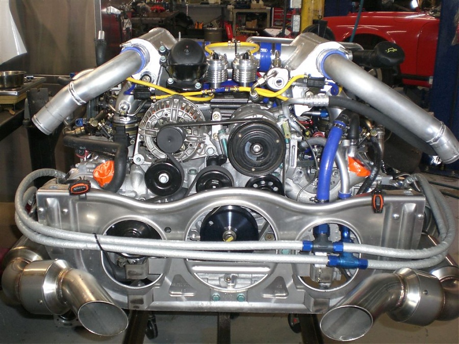

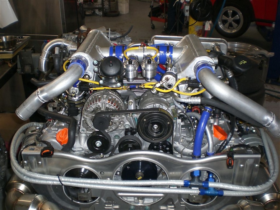

I am told by the builder that it saves about 35 lbs on the back end and adds about 12 lbs to the nose, where you need it.
Here are a couple more engine update pics.
