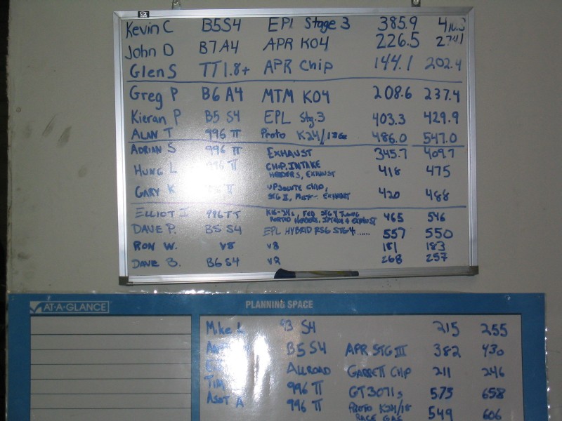

So, as many of you know, I wanted to try something different, so I had a set of K16/16g hybrids built by a local turbo builder that Tony at EPL and some other tuners on this board work with. I then asked Tony to custom tune the car. Again, I have no affiliation with Tony or European Performance Labs, I'm just a happy customer.
DISCLOSURE: The car presently is BONE STOCK aside from: K16/16g hybrid turbos with 1 bar wastegate actuators, a 5 bar fuel pressure regulator and Tony's software. The car is AWD and has a stock exhaust, stock OEM paper air filter, stock DVs, stock EVERYTHING.
If there's one lesson that's been beaten into my head over the past month on this forum, it's that dyno numbers count for nothing because there's so much variation between dynos. That said, with a very conservative tune (93 octane, 1.1 bar) the car did 481whp and 534wtq. As you can see, these spooled faster than even stock K16's and held on longer as well. Here's stock vs. flashed vs. K16/16g:
I'm anticipating many are going to say... but K16/K24 cars should make over 500 at the wheels. Well, I'm very happy with these figures, and here's why:
1. My bone stock car made 334 whp on this dyno (in similar weather) so I can solve for my driveline loss and solve for my crank hp. Doing the math 334/416 = 481/X. Solve for X and you get 599.08 at the crank. It's also a 44% increase in power at the wheels.
2. Tony's dyno is a mustang and reads lower than most. When compared to what other cars did in similar weather on this same dyno on the east coast dyno day it really put things in perspective. Take a look at the results below:
Note, the dyno day figures were, unsmoothed, uncorrected numbers. To compare apples to apples, my car made 495whp and 541tq unsmoothed and uncorrected.
So with a stock exhaust and at 1.1 bar, my car made:
- 30 more horses at the wheels than a K16/K24 car with a fabspeed exhaust, ported headers, GT2 ICs, Forge DVs and EVOMS Intake (this car has John D's old speed gallery low clearance hybrids on them with a wastegate kit). Comparing the plots, I also like the power delivery of these turbos better.
- VERY similar power to a Proto 600 K24/18g kit with exhaust and the other proto bells and whistles. I've overlayed the dyno plots and they're VERY similar (power as well as curves, though mine spools sooner).
All told, I'm extremely happy with these results. I think your dollar goes VERY far with this setup (so far, with everything, I've spent less than some spend just for flashes). I'll add an exhaust at some point and be done with it. The results are exactly what I asked for: the quickest spool up possible with smooth linear power for the street or track. For me, these turbos are the perfect compromise between big hp, early spool and wide power band.

K16/16Gs are not new to me... I know of the set up.... Protomotive has done a few over the years. The 16g dies where the 18g picks... with that said you cannot get to the 700 hp crank with them... but if that is not the point then I agree that the 16g are a nice alternative to K16/24s. Just the mere fact that a 18g is bigger it will push more air then the 16g ...
just like a 20g will produce another 50 rwhp over the 18gs... and I drove a 18g 600 hp car, a 18g 700 hp car, and a 20g 750 hp car...
Good job, but get rid of the stock exhaust because its choking up on top...

I dont see this as an option for people looking for 700 crank hp's nor was that Seal's intent on the upgrade. Its pretty obvious that the 18g will flow more then the 16g, but at what cost.... If you stick the 18g wheel in a k16 housing, you produce nothing more then heat. If you step up to a k24/18g you loose 400-500 rpms of response.
This turbo is for someone that wants stock response (or better), stock fuel system (plus 5 bar), and 600 crank hps. Its a much better option that the k16/24's.

Thanks Markski. An exhaust is in the works. Either a used Miltek, or a modified stock ala RUF is in the near future.
Yeah, 600 is where I wanted to end up. 700 would make me think I needed to do internals sooner or later and I don't want to get anywhere near that level of expense. So with 600 as my target, the 16gs made sense because of the early spool. I wasn't expecting them to have even less lag than a flashed K16 car though!!
I was shocked when we laid my plot over the K24/18g plot and they looked almost identical (aside from the early spool on the 16gs).
I'm sure with a fueling kit it's a whole 'nother story though.

For starters, it made 30 more hp at the wheels than a car that had ALOT more hardware (intake, exhaust, ICs, headers, etc.). I liked the curve a lot better, too. Here's the plot from the K16/K24 car at the east coast dyno day:

all the way from Cancun.... NICE!!!! Guess who has these on the shelf too Good work Tony and Seal. my only question is the dyno calibration. what is the multiplier being ran?
