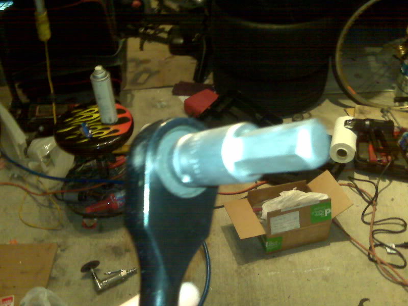

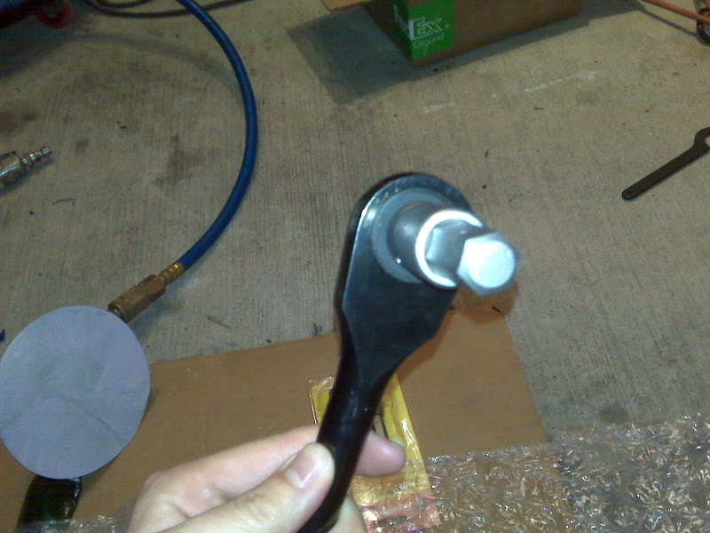

Here are the tools you need:
14mm Hex Socket

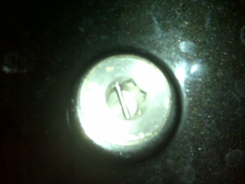

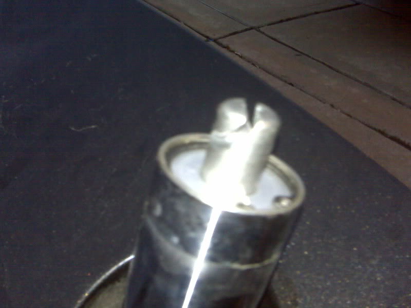

This is what the top of the piston shaft looks like and you can see the grooves how the spoiler catches on.

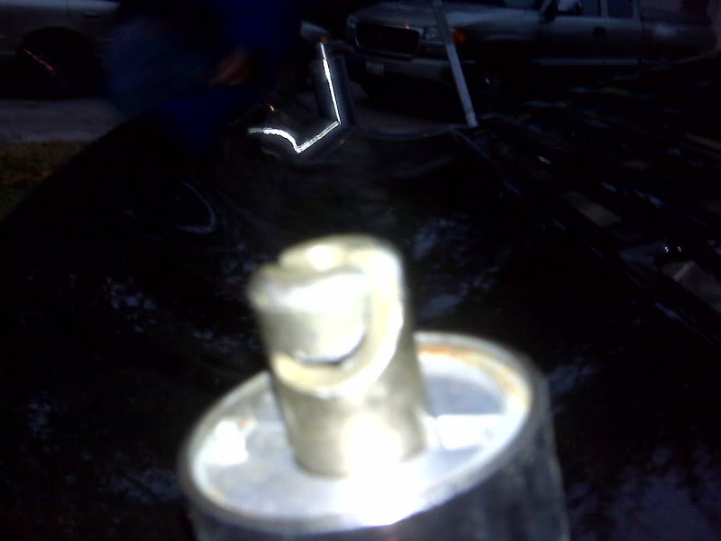

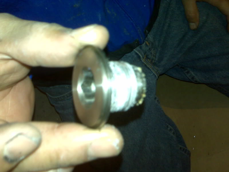

Once the spoiler comes off, you will need to remove the "adaptor" off the oem spoiler.
Note the little metal bar that cuts through the middle of the hole, which is where you need to align it with the top of the shaft as you can see in this pic
Use the 14mm hex nut and remove it. Mine was pretty tight on there so be careful.
This is what it looks like removed.
That's it...go in reverse order and you're done.

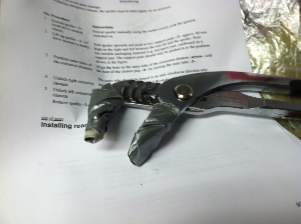

I CAREFULLY wrapped my channel lock pliers and easily twisted the shaft clockwise and the spoiler disconnected. See image below.
Anyone refilled a cylinder? I removed mine and turned it upside down but only a few drops went in, not even 1ml (they call for 5). The piston is retracted as the manual states. Any help appreciated. Thanks.
