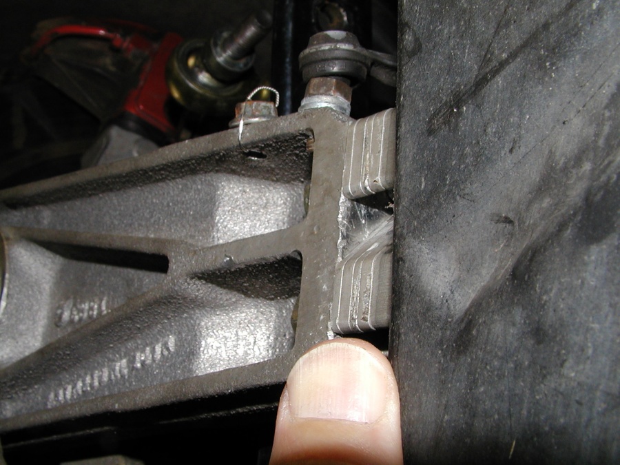

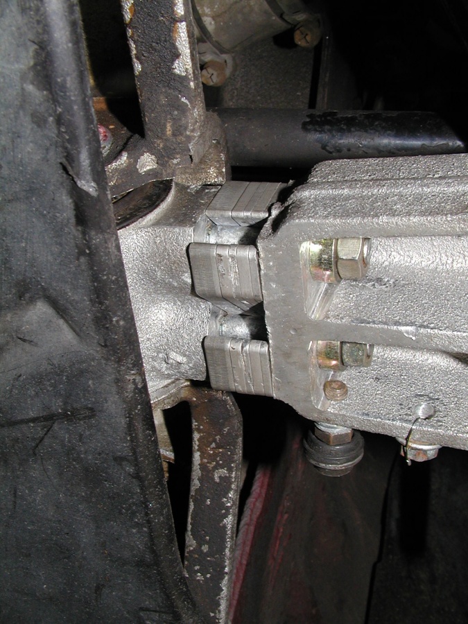

Photos of GT3 front control arms
I was prepping my car for the track yesterday. Here are a couple of pics of the GT3 control arms with all of the shims in place.

You're pulling in the tops = keeping track width, but with GT3 arms you're extending the track width.
I'm interested in doing the GT3 arms as well, would be nice to see some more details, what was done with the swaybar links to clear the half-shafts etc.

Just finished doing that, too! Pics don't show much, but here's how I do it:
1. Disconnect sway bar drop link at bottom.
2. Install shims in control arm.
3. Lower car onto ramps so that wheels and suspension are loaded.
4. Adjust drop link length until there is about 1/2" above control arm. (They move up much more than down)
This length seems to be a little too short (interferes on half shaft) when the shims are removed, so I do the same thing on the reverse install.
