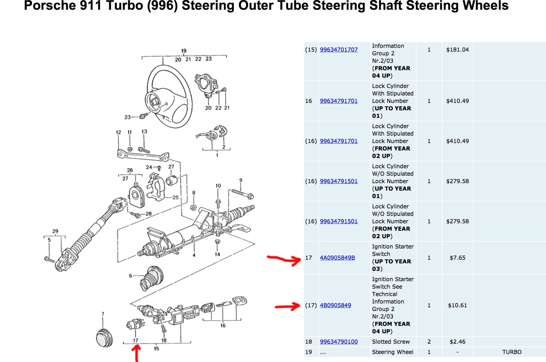

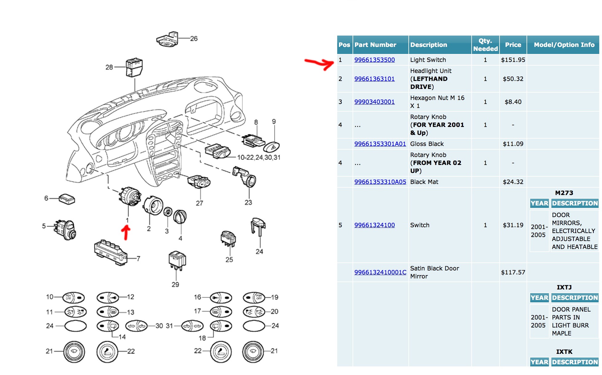

From previous posts on TT forums, the light switch seems to fail often but it can also be the ignition switch. The light switch part#99661353500 is about $120.00 and the ignition switch can be found at the Audi or Volks dealers for about $10.00! But in your case if your are playing with the switch and the light work, don't look further replace the light switch…. The diy from smistry007 is your best tool!

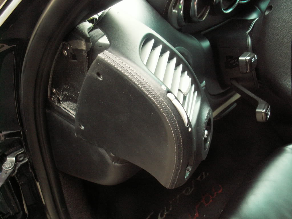

replace headlight switch
these instructions & pics were perfect. thanks a lot. the connection that open and shuts the vent broke when I pulled out the vent assembly, I just drilled a hole in the plastic arm, used a bread tie!!! to join them & it works great. I don't know about this only taking an hour but great instructions
911 george!!!!!
2- remove the light switch **** by pushing in the lock under the **** with a small screw driver and pulling

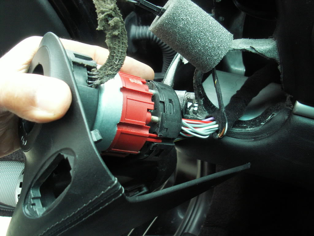

5- remove nut around light switch

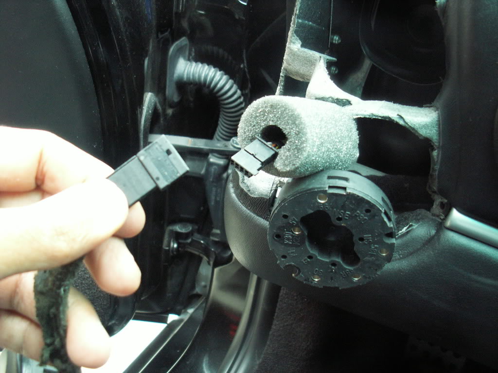

6- disconnect electrical connections

7- remove bezel around **** and switch
8- twist switch to remove

Hi, I am new to the forum. I found these instructions and pictures very useful. I am in the process of replacing my headlight switch by following these instructions. Unfortunately I am stuck on step 7. I am not able to remove the bezel around the **** to free the switch from the back. Is there a trick to this? Thank you!
Old Jan 21, 2016 | 06:50 AM
  #82
911 george's Avatar
Registered PM
Joined: Sep 2013
Posts: 15
From: boston
911 george is infamous around these parts
I first put a piece of heavy tape(like duct or alum hvac tape) over trim where flat screw driver will hit trim so as not to mess up dash trim, then with a wide flat screw driver work it off all around-and try to twist back & forth a bit and it should come off.
good luck
