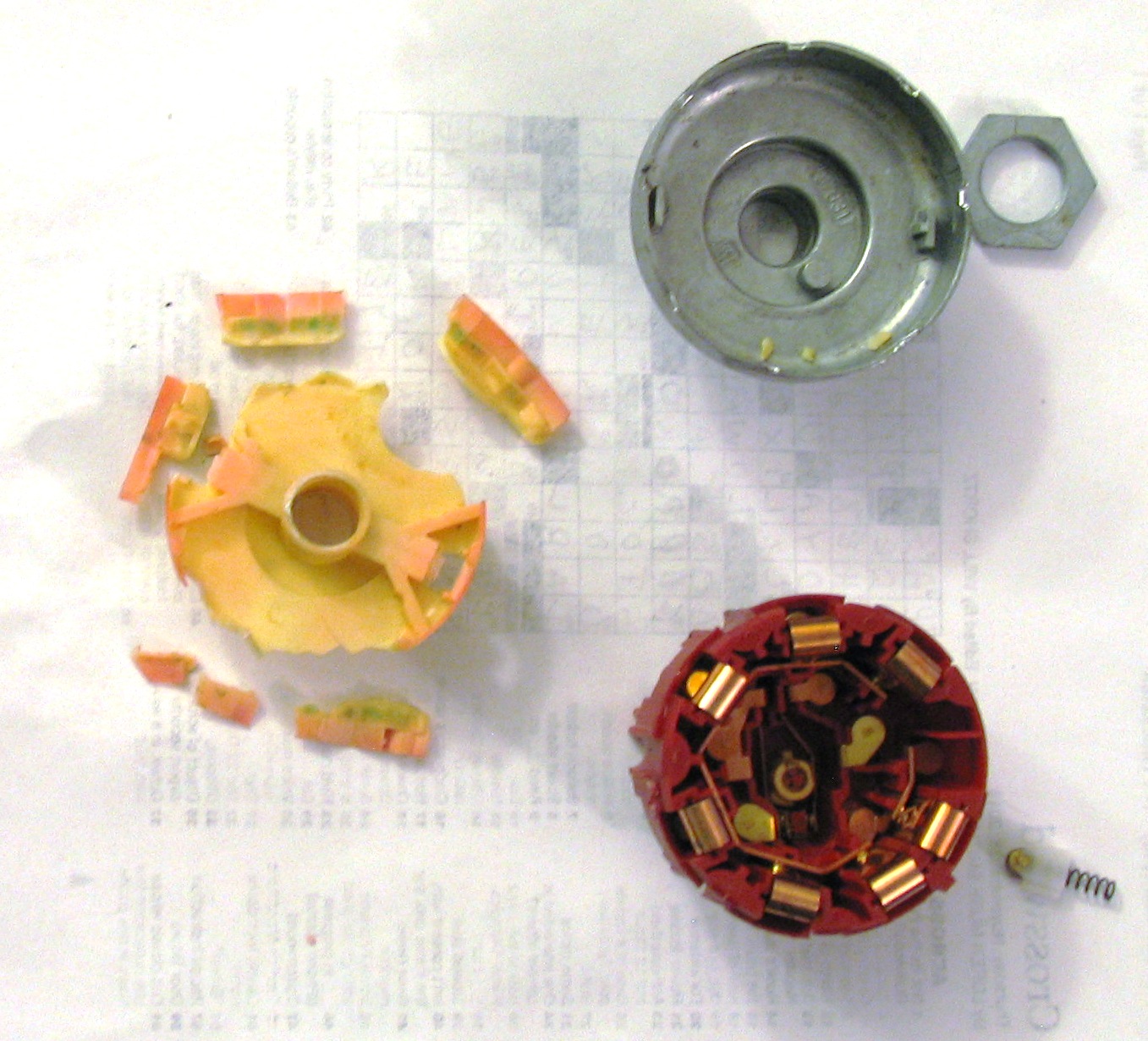

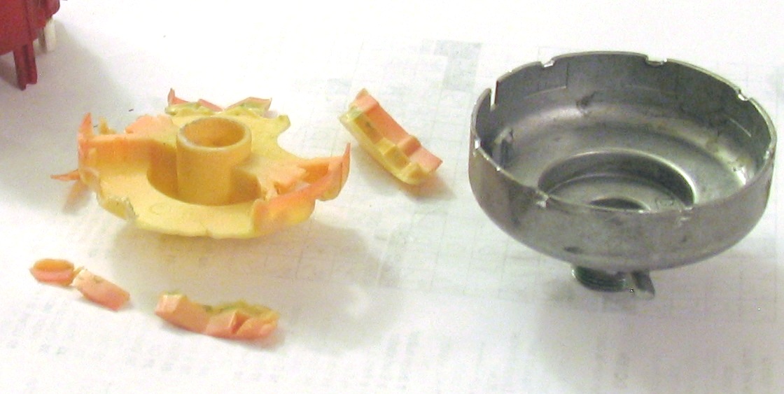

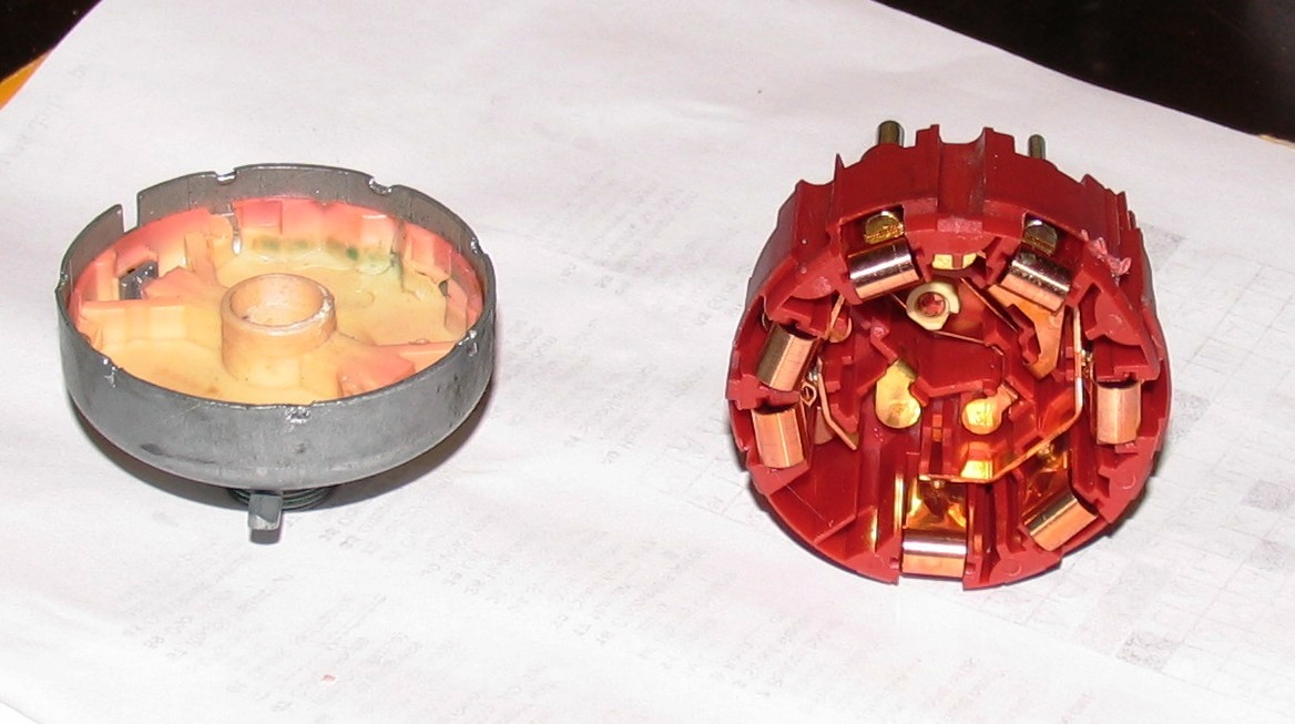

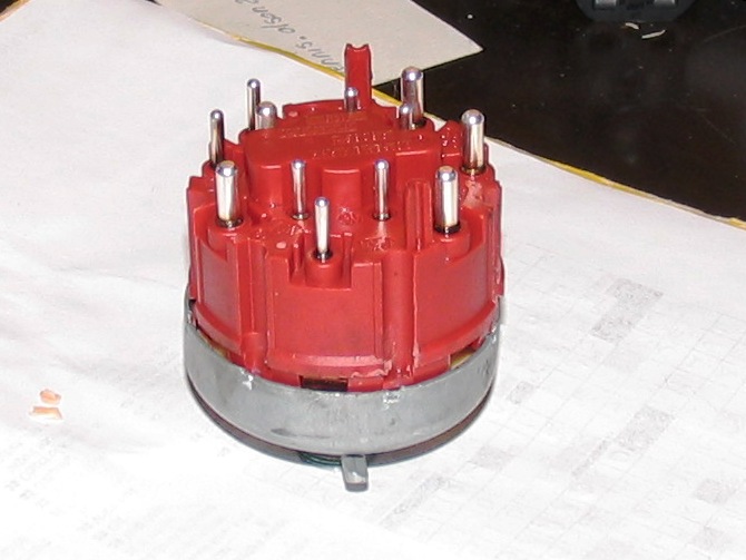

Just to show you the interior of the switch at fault. Here's some pictures of a switch that seems to be good from the outside but completely destroy inside…Thanks to Randal from Renntech for the pictures….

Wow! How does it get like that? Heat?
Heat and bad type of plastic I guess.
