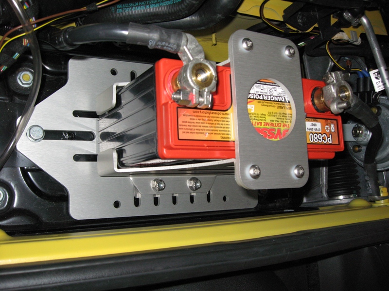

I have had the Odyssey PC 680 for almost two years. You will need a battery tender if you do not drive it every day. The mount is a Rennlist mount.

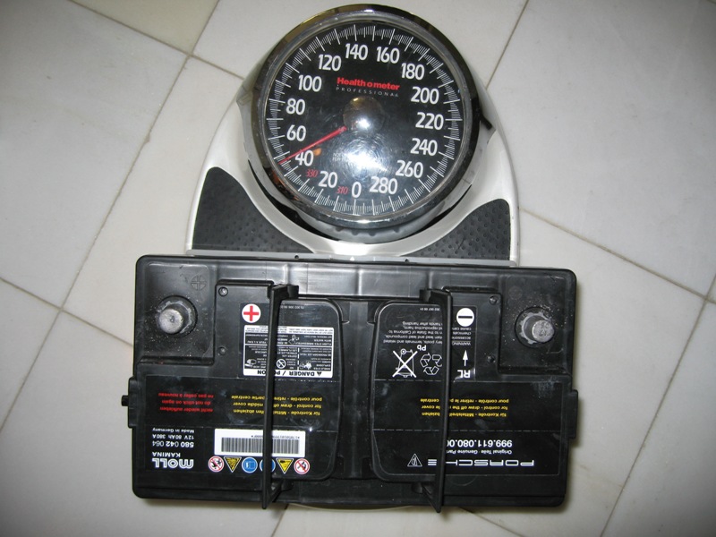

What I did on mine to save weight and keep street drivability, I got a Die Hard battery(E2 group 47) from Sears for $125. It fits in the OEM tray with the OEM bracket. It uses the last hole in the OEM tray just like a GT2 and saves 19LBS.

+1 on the Diehard International. I paid 109.95 Canadian and it fits perfectly. Mine is 11 lbs. lighter than stock and has more cold cranking amps.

Originally Posted by GreggT
Odyssey 928 is 1/2 weight of OE (which is 51)
No tender needed if driven at least a couple times a week.
How did you secure the battery? Did you use a custom mounting bracket?

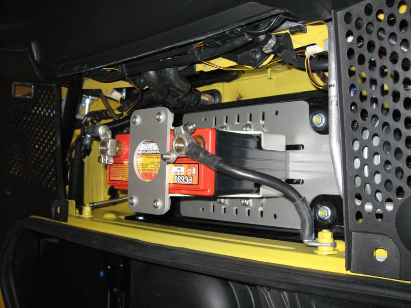

Here's a couple more pics.....aluminum bracket was bought w/ bat.....then minor mod to mount plate.

The rennlist mount weights one pound and is well made. i also purchased the Odyssey mount with the battery but went with the rennlist in the end.

Originally Posted by PALETTE
Rob did you get the mount from Rennspeed?
Yes, cost around $100 if I remember correctly.
