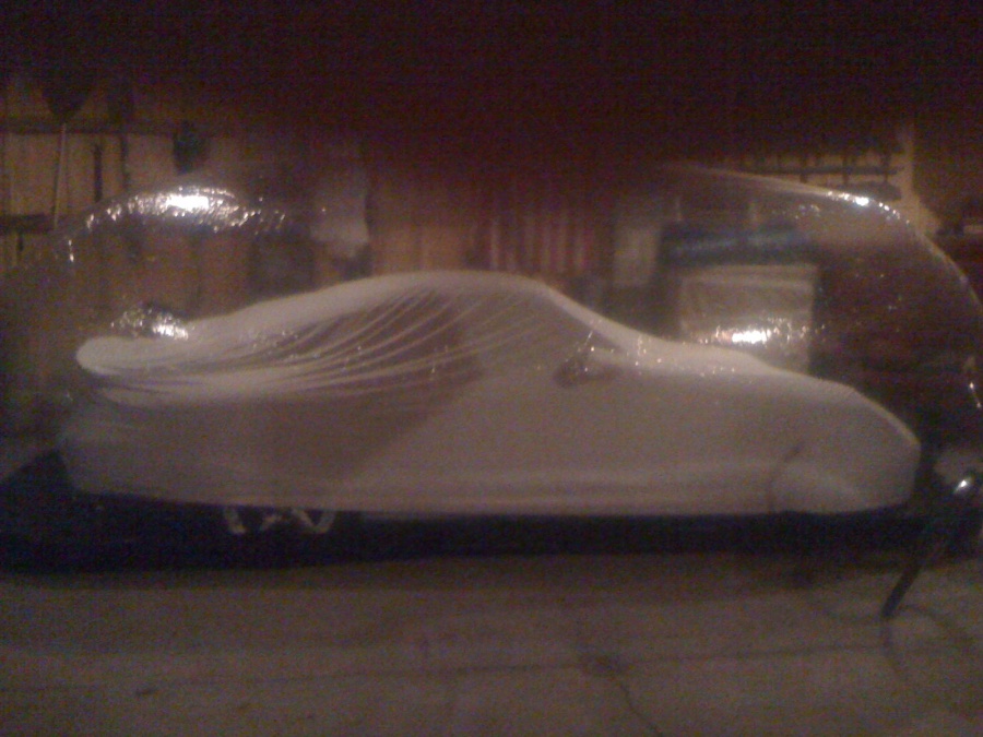

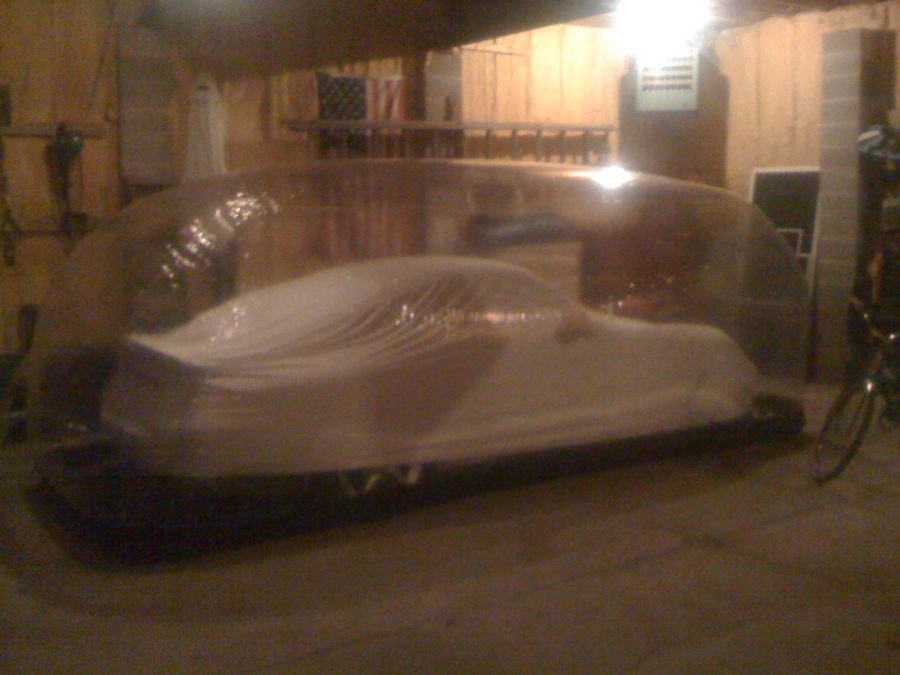

I am putting my 02' x50 in storage. I put stabilizer in the gas and topped off the tank. Put a battery tender on. Sprayed down all the leather with conditioner. Put 2 buckets of calcium cloride on the floor and a bucket in the capsule. Covered the car with a genuine Porsche custom cover and put the car in a car capsule. Now my question is there anything else I should do. I also took it into Porsche and had it checked over (coolant was checked for strength)
