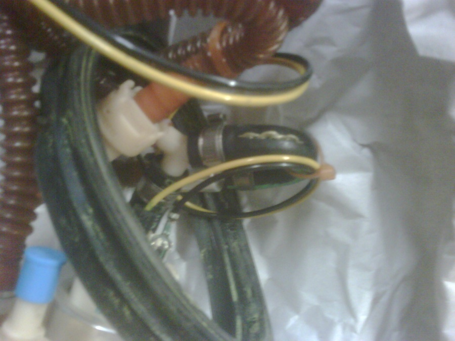

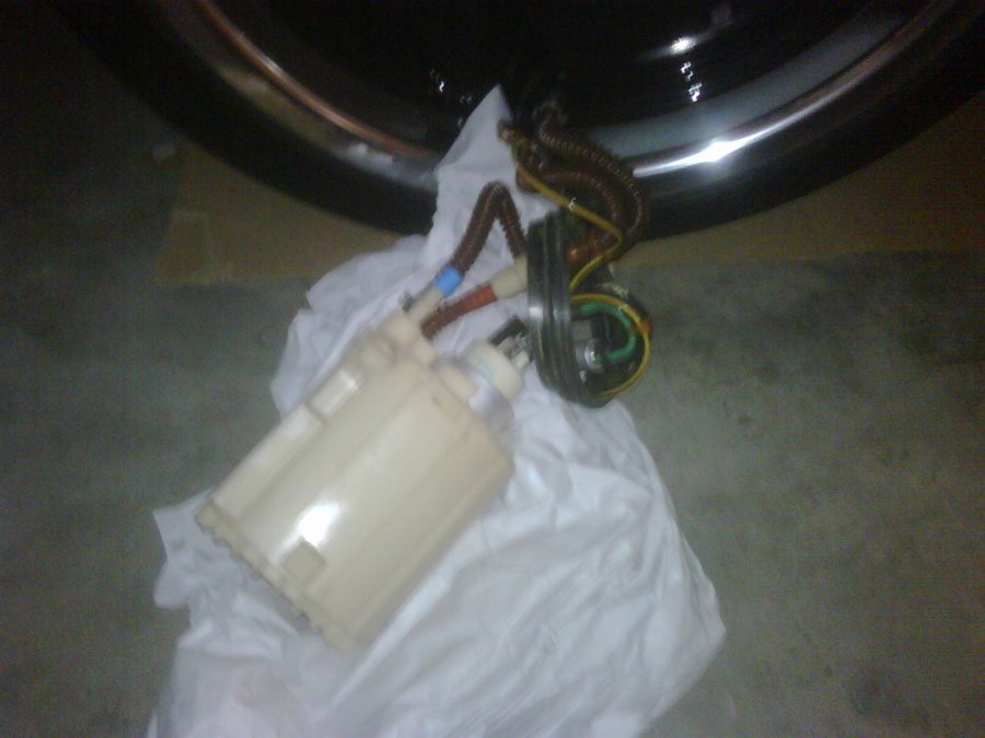

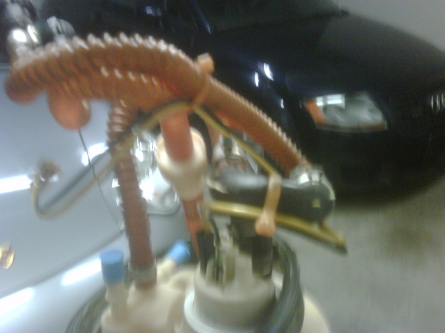

Ok / here are the PIC's for the POS fuel pump

Sorry for the quality of the PIC's... Still trying to figure out this whole camera thing. Bottom line: The part cost me about 600 and about 2 hours of time. I may have been able to complete it faster but I started drinking beer and watching BB.... So I wouldn't use my experience as an example. The hose split..

i had the exact same thing, did the new unit had a rubber hose or was it all plastic?
Nope. The new one had the white plastic pipe instead of the rubber fuel hose. I am not sure but I suspect there are some of the old pumps still floating out there as new stock... I assure you that it's only a matter of time your pump WILL FAIL sooner or latter if you have the old style.
