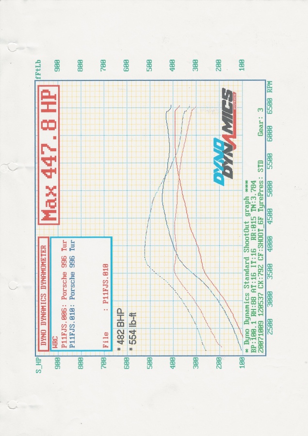

Originally Posted by bad107
What mods do you have done?
Here os a Dyno printout with only a Revo Stage 1 program & standard exhaust & cats with a K&N panel filter.
Since then I have had a 100 cell Miltek motorsport exhaust and stage 2 Revo.
Torque might not be up much more but BHP is estimated to be another 7% on top of Revo1 tune plus another 15 to 20 for the exhaust & cats.
Please note the figures are SBHP and do not allow for TC slip.
Frank.
