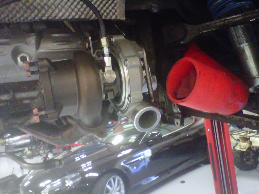

Steve Ott is currently installing my rear intake piping (and a few other things) and its taking him forever due to the tight fit with the tip combined with the high flow of my new turbos. I don't think he is going to do another one of these intakes...sorry Steve!
We are using the red silicon (steel reinforced, not sure to what guage) that Dan posted in VividRacingTX's rear intake piping thread.
I would encourage anyone to just get a blow-thru with the intakes in the fenders if you have a tip tranny.

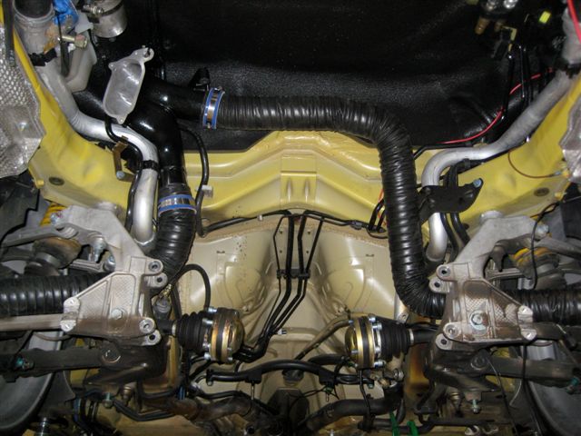

Here's a pic of the tubing with the engine out. It's a wire reinforced fabric tube connected to a modified intake box. There are several silicon sleeves on the tubing to protect it at the really tight places.
