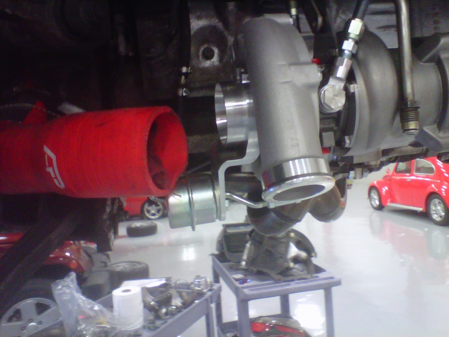

car
we are almost done with all the work....everything is installed (alpha28s, rear intake, plenum, tb, y-pipe, injectors,headers this go around, already have exhaust and i/c).
couples issues
1) For some reason the intake hose goes from 3" diameter everywhere down to 2" diameter about 12" away from the turbo and then back to 3" in diameter about 6" away from the turbo. Therefore, we had to use a transition hose to go from the 3" diameter to the turbo (which is closer to 2"). This transition hose is getting sucked in so that is collapses over 0.5 bar. There is a loud whooosh sound when the car is driven because the turbo is essentially sucking air through a straw
You can see in the picture below how the intake silicon expands right before the turbo...the unreinforced black silicon (not shown) we were using to transition the fat hose to the turbo is whats collapsing...
2)No place for the second fuel pump....since its a tip it can't go in the normal spot (right next to the 1st fuel pump), and since I put vivid's 3" y-pipe in, there is no room to put the fuel pump next to the air box
Here is a pic of the y-pipe
Any other tips have a second fuel pump? If so, where is it?
Sorry for the crappy pics

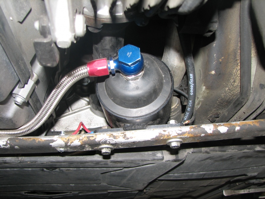

See the attached photo. It is next to the coolant tank on my car.

Thanks for the pic! I will show to my mechanic but I don't think that works since my y-pipe fits differently than yours...
