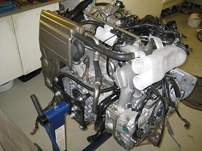

997 GT2 Expansion tank/intake on 996TT engine.
Short of it. After doing some research of a few threads regarding the newer 997 and GT2 expansion tanks (I'll likely use the word intake interchangeably with expansion tank so don't get your panties in a wad) I wanted to give this a whirl and do a DIY on it.
I'm not sure what questions will be asked, feel free to post them up, I'll edit this first post for information rather than replying.
I"m starting out with the Engine out, on the ground, I'm not even going to try this project 'in the car'.
First picture is everything off. This was pretty simple, mostly just removing parts until I had full access to this.

Starting out, I wanted to take as little as possible off. I had to loosen the oil tank, remove the vacuum pump and oil fill tube, but other than that it was pretty easy.
This is the only 'clearance' issue. I suspect a crescent wrench on the bracket and bend it toward the front of the engine will be enough after you trim the water hose about 1" shorter. **I'll edit once I accomplish this.
The valve will be a bit more difficult on this side. I'm not sure what I will do, although it will likely look considerably like the 997 stock piece (see below)
How do the ports match up? See for yourself. Had I actually bolted these in, they would have been perfect. Note, this is the 996 part. The biggest benefit would be to actually go into the head and reduce the sharp 'ramp' from where Porsche did the port matching themselves.
Lets dispel a myth. The ports are identical on the 997 GT2 at the head. I'm not sure what they look like once into the head. However, on my parts I could get the ports to match up identically except where the injector clearance is.

I'll use this one for the 'fixes' I have done. On the left side, I threaded the front hole.
Simple solution. No drilling. I packed a piece of wet paper towel into the hole. Tapped it, vacuumed the hole out. Continued to run the vacuum as I was pulling the paper towel out. Then, I blew air into the other egr hole to evacuate any bits that may have fallen through.
3/8" x 18npt tap.
Really quite simple.
All plugged. This plug is tapered, so no sealant is needed. However, it is a good idea to put some anti-seize on it. I did, but not in this photo.
