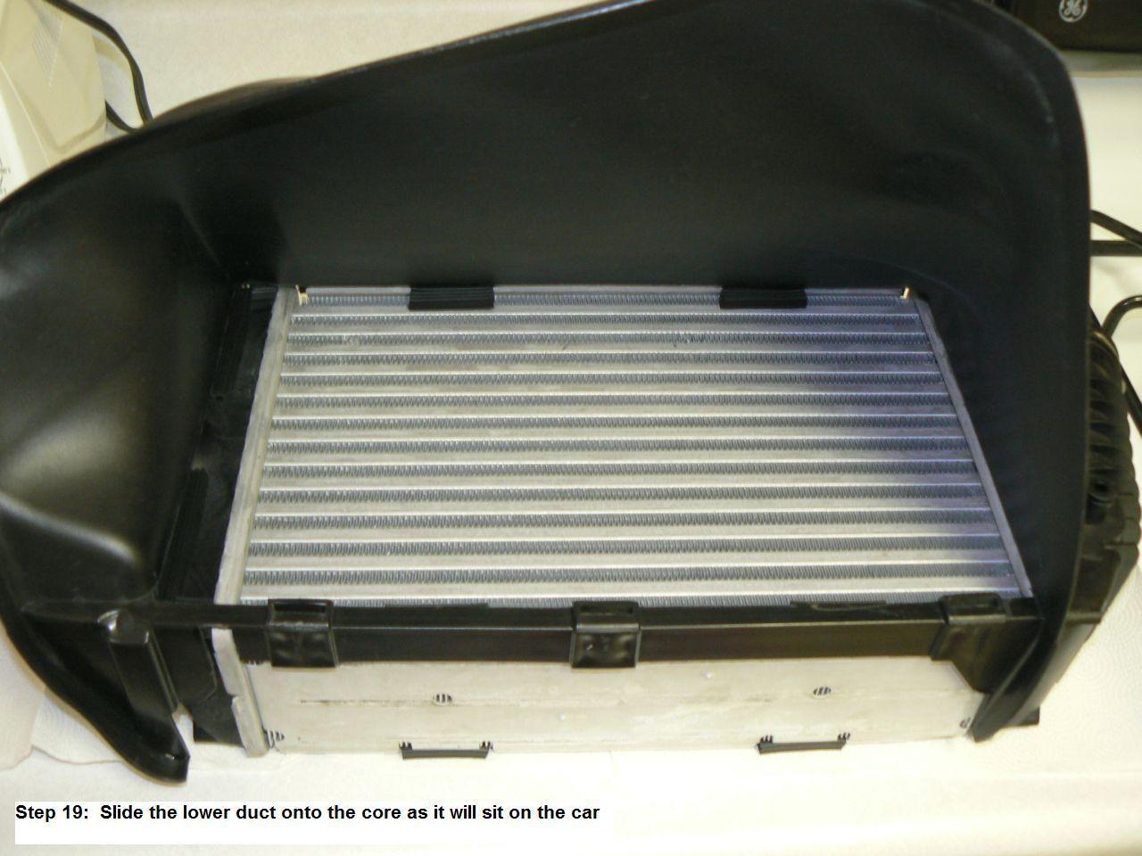

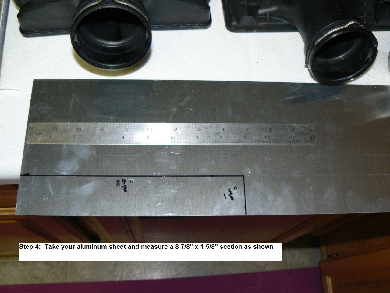

I finally tracked down the pictures missing from earl3's duct modification post... Photo credit of course to Earl3, I am just reposting the lost images.
I've also noticed in scanning all the 'RS intercoolers in 996 Turbo' threads that I could find that there are a few different techniques for doing this, YMMV...
Originally Posted by Earl3
Duct mod write up:
Standard disclaimer -I assume no responsibility if you screw up your car, what worked for me may not work for you. These duct mods are non-reversible.
The write up is for getting the factory passenger side 996tt ducts on a passenger side 997.2 intercooler. The driver's side is the same process, but it’s a mirror image type thing. Having the intercooler in front of you while you’re doing this will help you understand the steps! If you have questions or something doesn’t make sense, just ask. This is one way to do it, other’s may see a better way.
Stuff you'll need:
-Dremel tool with a cutoff wheel & 120 grit sanding wheel
-Rivet gun (I used an Arrow RH-200 that’s like $15 at Lowe's)
-1/8" short rivets (I used Arrow RSS 1/8IP) –note, you could get by with zip ties here, but rivets seemed like a more robust option
-6"x18" 0.025" thickness Aluminum sheet metal (I used Steelworks Hillman #11232 from Lowe's)
-RTV sealant (gray or black preferred)
-Rubber Weather stripping (I used 2 packs of MD 01033 from Lowe's -you could use the RTV here in a pinch)
-Zip ties (I used GB 14" plastic cable ties from Lowe's)
I've assumed that as this point you've gotten the bumper removed, intercoolers off of the car and out of their frames (see Renntech.com spark plug DIY writeup for info here). Go ahead and release the metal duct straps & remove the ducts from your stock ICs. Give the ducts a GOOD cleaning.
Here we go:
